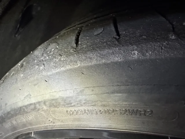

I searched TireRack for "Extreme Performance Summer" . There are only a few that fit. One comment on the ones you mentioned had a guy get three days, like me. The
Continental ExtremeContact Force seem to get good reviews on wear.
I'm not worried about the brakes. I have some track pads on the way. They are easy to swap.
I'm not sure I'm ready for a track only tire. Then I'd need a second set of wheels and a storage locker.
I did two trips to Spring Mountain on the C8 program. So 4 days. They grossly over coach. It wasn't fun until the last afternoon when we switched to open lap. It was mostly lead/follow or autocross. Then a bunch of classroom stuff. To go back no would be 5k for two days. The Miami-Homestead road course is much more fun. No plane ride. But wear and tear on my car. So I'm balancing it out.
This is the RF tire the way it is now.
My buddy at the ski lake suggested a track alignments. Will that give me significantly more wear?

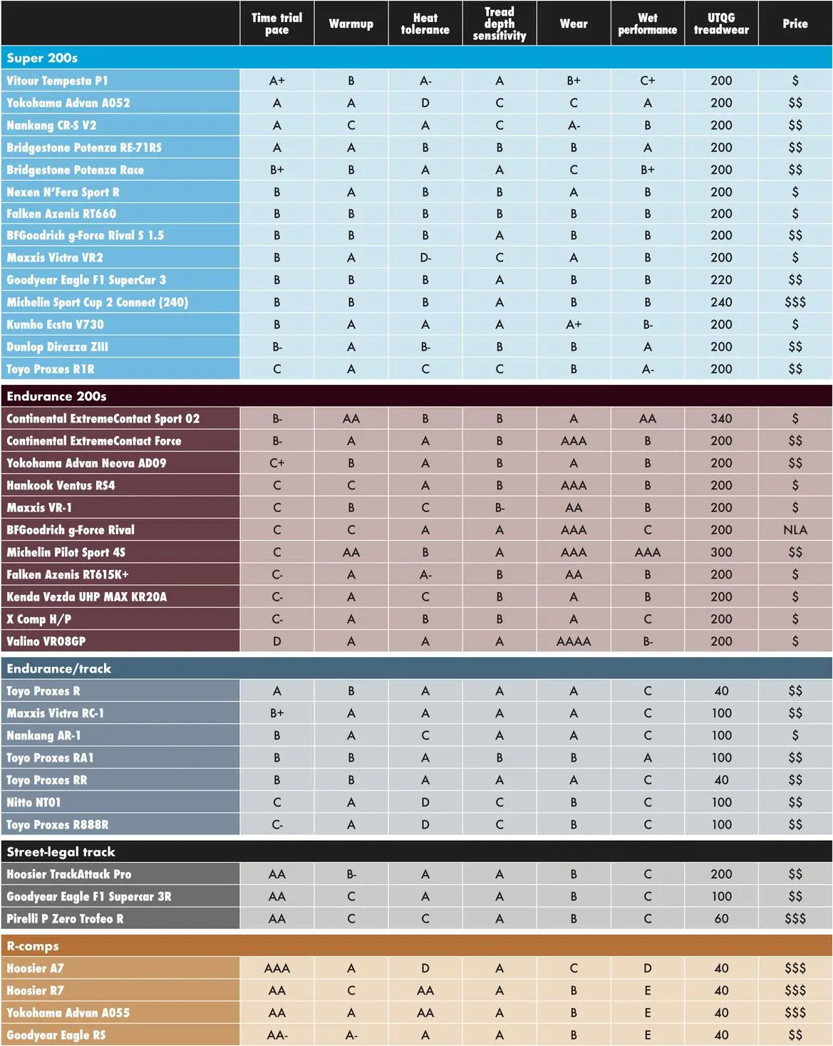

Gross over coaching is a surefire way to not have repeat customers...bummer. My experience(s) have been different but I know exactly what you're describing.
So the Conti ECF is in the same league as the AD09, RS4, and a bunch of other Endurance 200TW tires. You should expect roughly the same wear rate across those tires but their NVH and handling characteristics do vary. I still stick with the AD09 as they are non-directional so you can at least rotate your tires left to right.
Clarifying 'track only tire', almost all tires that have a tread wear rating can be used on the street (have DOT approval). All of the 200TW tires can be driven legally and safely on the streets (in dry and warm conditions). Some will perform better than others in wet and cooler conditions, but none of them should be stored or driven at or below freezing temperatures. I should be careful when using that phrase.
The chart below from Grassroots Motorsports is a rough guide (not gospel) and know they use their track Miata as the test car. Unless you change your wheel setup, we all know that our options are severely limited anyways.
I assume, your track alignment question focuses on tire wear on the street. Excessive toe-in or toe-out results in increase rates of tire wear, more so than camber. So keep the toe specs within OE ranges and just maximize the negative camber to start. When you do get an alignment, try to do it with fresh tires for the most accurate measurements.
If you're running the same set of tires on street and track, you're still likely to wear the outer shoulder before the inner shoulder. If anything, the negative camber helps to balance out the wear between both use-cases. Keep in mind, the Emira cannot get a ton of negative camber in the front with the OEM hardware. In the rear you also don't need much more negative camber than the factory recommendations (you can judge yourself based on the tire wear).
Once you have tires and alignment, the rest is on managing tire pressures and your own driving style.
Lastly, your FR is pretty much done for any track work, you'll see cord soon, if not start to lose major chunks of rubber the next time you go out.

Thanks. I'm just going to replace this set. I should have switched L/R sooner.
To clarify, a better track alignment will be less tire wear? I sort of followed you.
