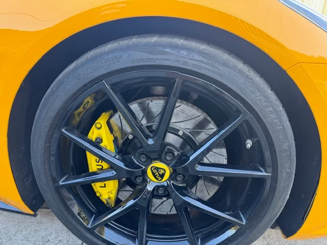

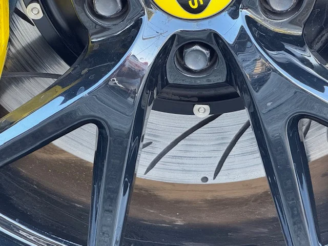

We have front and rear slotted rotor options in the works currently, they should be ready to roll around the end of the month/early May hopefully.
Fronts are just being restocked, rears are new to fit the Emira.

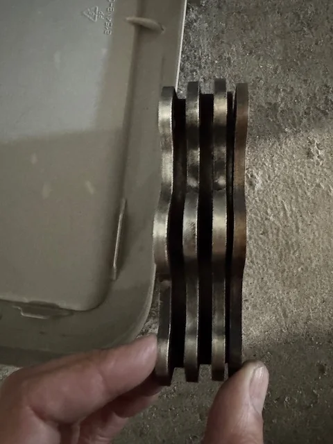

I have the Rotora from GRP. They do not work with EBC Bluestuff pads. I ripped serious grooves on the rotors after a few track days. Needed to have them resurfaced. I'm trying them now with harder pads. That seems better after one tough track day.

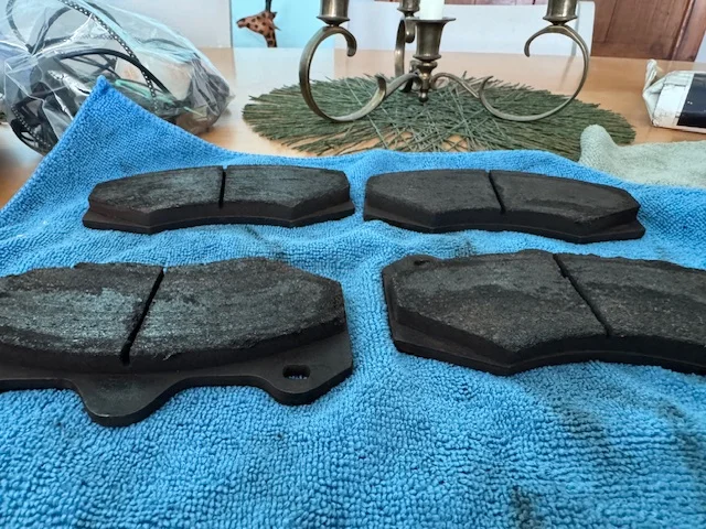

My left rear pad wore out more than my right rear.
I've been going faster at the track. I've been running sport mode. I'm more comfortable after reading more about it. I think the car is doing way to much.
The first set of OEM pads lasted 8 or so track days. Then the aftermarket ceramic pads (not track pads) only lasted two days. But a far more bumpy track (Sebring). Then I'm going faster each time. I'm pretty sure the last 5% of braking does a 5x wear and tear on pads and rotors. I'll know more after this weekend.

8 track days?! Wow. I haven't looked at my pads yet, but I know a couple different people who went through pads in 1 track day. I suspect I'm 3/4's in at this point.
Rears went that long.
I went through 1/3 of my semi-metalic race pads on the front in one day.

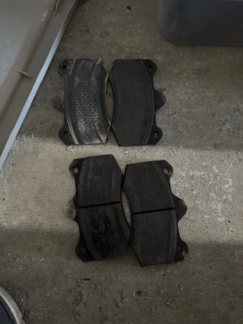

So the Rotora H8 pads pushed hard did about the same as OEM pads taking a bit off. I pushed the H8s all day. The day I was stuff with OEM, I worked into it. I think its the hot time that really trash the pads. I'm going to run the H8s this weekend and take a bit off the braking and see how they do.
These pics are the OEM after a day running at 95%. The H8s measure about the same after one hard day.
I'll try one of the ones you said next.

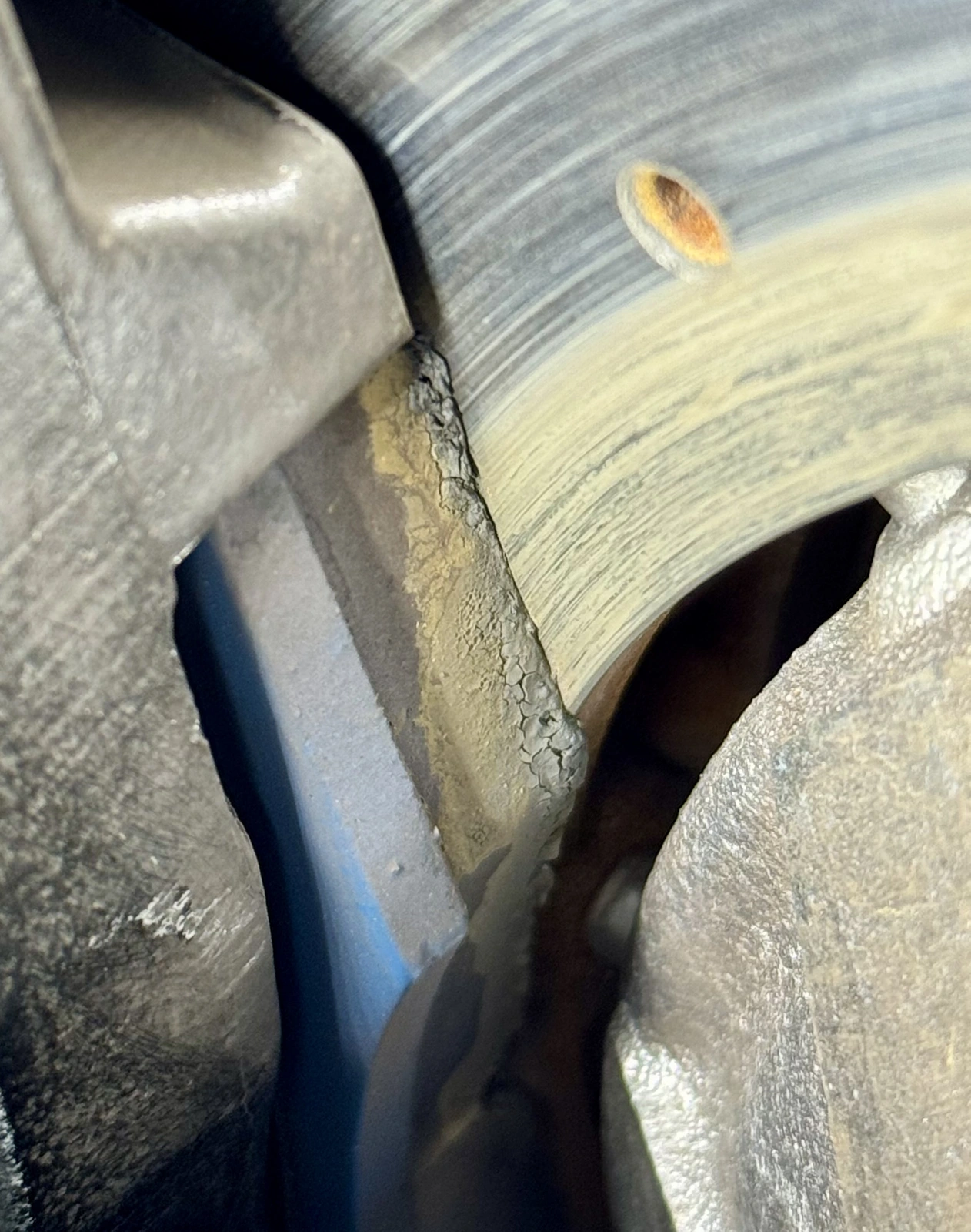

Also the incorrect rear pads that EBC is cool with being incorrect, are building their lip in the rears - as expected. They don't look great and are at least somewhat falling apart - likely similar to the post above.
