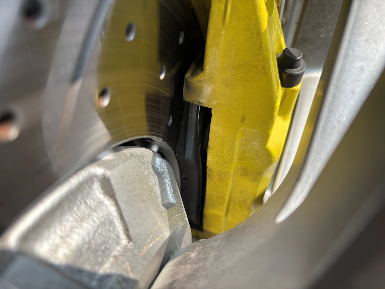

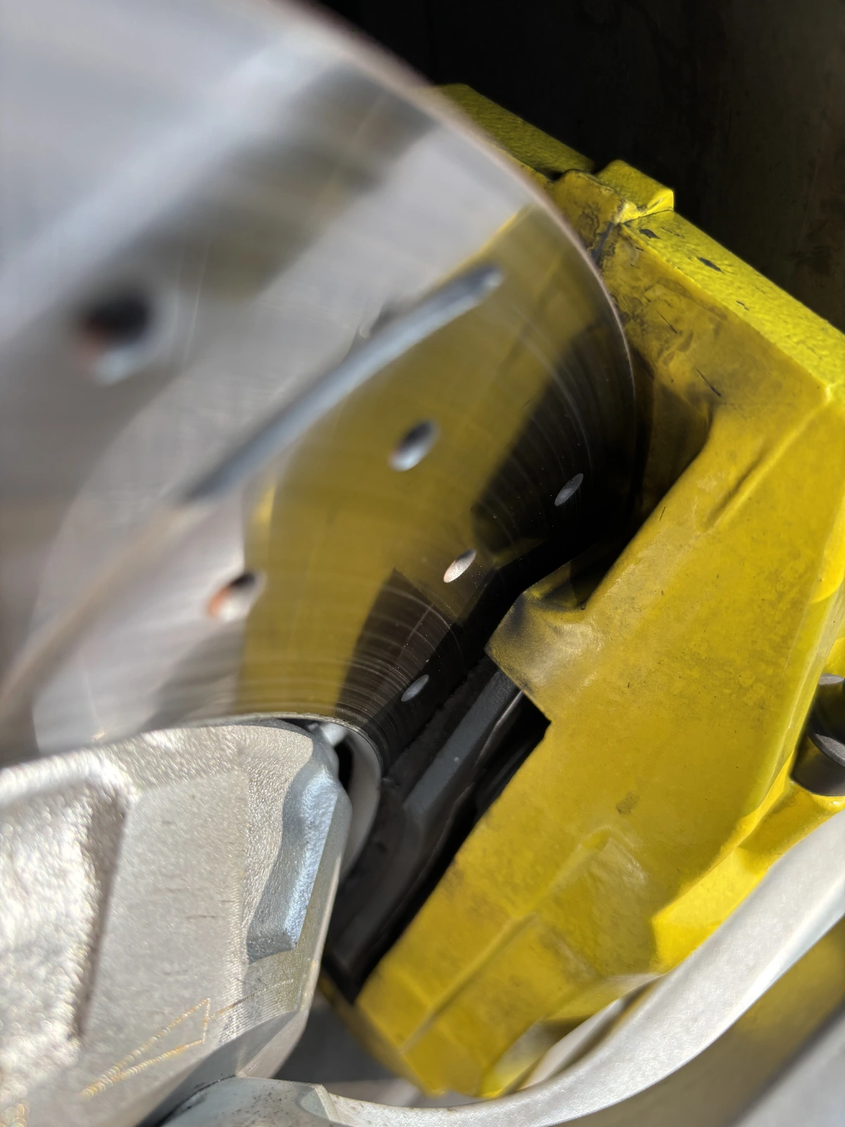

Tracked my emira for the first time, just past the break in period. Ran 3 X 20 mins sessions, by the 4th one I notice the driver side pads has 2-3mm left on one end and 5-6mm on other end they are completely wedged from uneven wear. The other side is at about 5mm even on the pad… I know the OE pads suck, but do anyone notice uneven wear? Running stock fluid.
Brake pads rarely wear completely evenly on the track - the leading edge tends to go quicker, and yes, the OEM pads are no good for tracking. Try some EBC RP-1. They're quite good, and not too bad on the street, no major squeaking, just occasional reminders that they're track pads.
I have almost 200 track days. At least on Nissan GTRs, the pads wear relatively evenly, most but not all of the time. On my (only) two track days on the Emira, both oem pads and EBC RPX pads both wore unevenly.
Mine wear unevenly too, but not too badly. My Elise pads wore unevenly as well, as did the ones in my Focus RS. I just assumed it's normal.

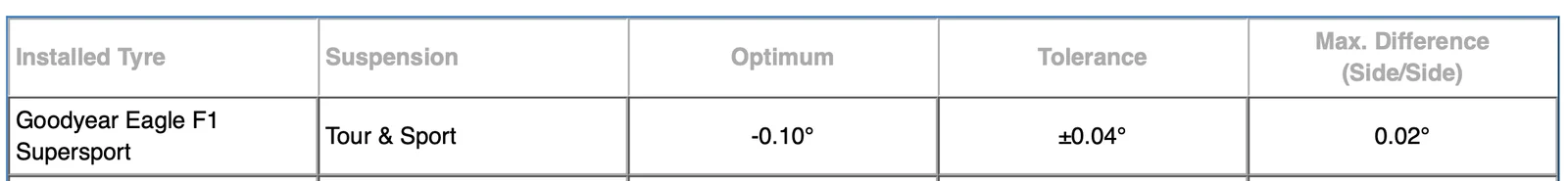

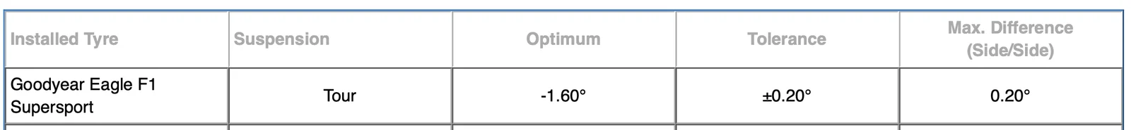

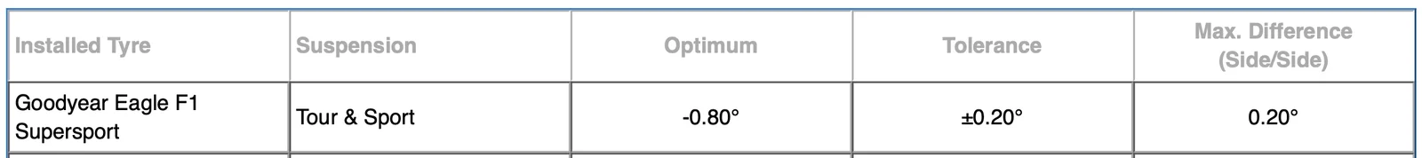

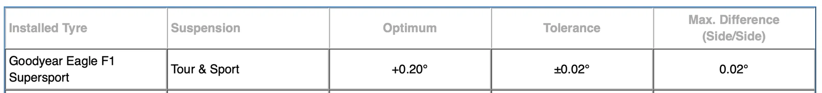

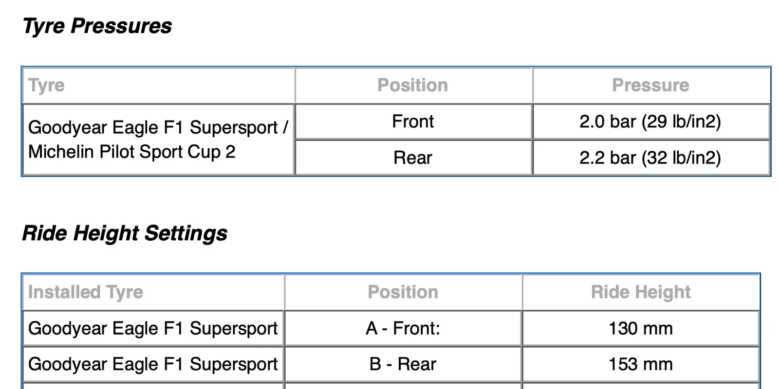

Since you have coils you have far more adjustability than the standard alignment, and interestingly, the emira service manual has different suspension specs for Eagle F1 vs PSC2's.
For the Eagle F1's. Set tire pressures, have half a tank of gas, I use driver weight then you're going to want to set desired camber, ride height, fine tune for corner balance, then toe. Specs for your tire below.
Front Toe (per side):
Front Camber (v6):
Rear Toe (per side):
Rear Camber (v6):
Some modifications to consider.
a. You want to add more negative camber where you can. Better tires than the eagles will take it.
b. Toe settings change for grippier tires and make a huge difference. Front needs to go near neutral or the tires will fight each other
c. Ride height you can set as low as you want, but you should preserve the rake angle from stock or you'll mess with aero of the car
d. Changes to ride height will mess up the rest of your settings. Recheck everything at new ride heights.
You can VERY drastically change the feel of the car with a proper alignment and dialing in your coils.
