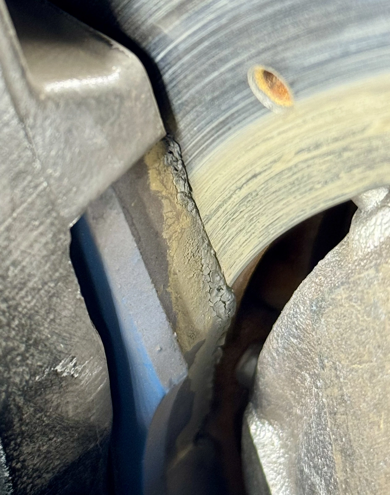

Also the incorrect rear pads that EBC is cool with being incorrect, are building their lip in the rears - as expected. They don't look great and are at least somewhat falling apart - likely similar to the post above.

I never bought the REDs and glad I did not. I really do not like how EBC is OK with the rear pads not correctly sitting on the rear rotors. I am waiting on the Hawk Ceramic Pads - which do cost more but a few owners have reported they actually sit correctly on the rotors. I have an AutoX this weekend with the Emira and I cannot wait to get the Blue's off this car. I also really want to see if they've started to chunk/crack on the main surface (or not), and to re-measure the wear.

I'll have to check on rear pad fitment for the RP-1s when I pull them off to see if it looks like what you shared earlier with the Blues. I don't remember it looking that way but wasn't paying close attention. I already ordered the Reds and will put them on to see how they feel.

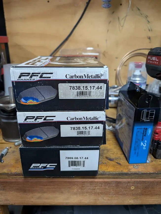

PFC 15/08 is working well for me. Very good pedal feel, consistent travel, strong initial bite if that's your jam, but very good modulation/release characteristics. They didn't score rotors or crumble.
They squeal like a bus when cold, but I can drive them in the street without any performance issues (just to and from the track). The noise they make in the street is impressive though, so I just swap pads.
I don't have enough laps on them to assess pad life, but they seem "normal".

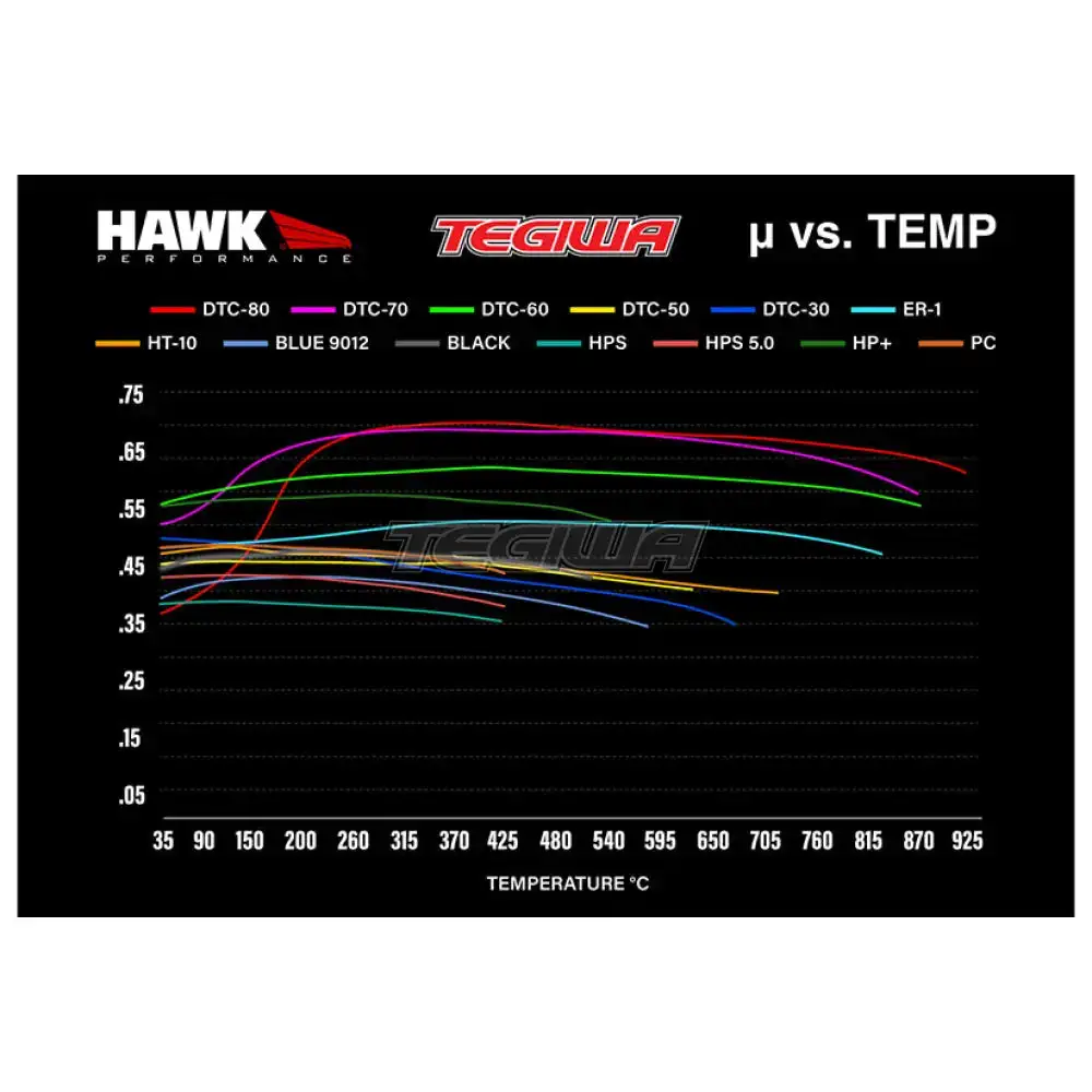

So today I spoke to hawk customer service as I like they’re ceramic performance pads and they put me into the hawk ER1 brake pads. Parts numbers HB585D.660 and HB586D.660
Looks like it’s a step above OEM, has progressive braking, good pedal feel, can drive to and from the track, and most importantly high temp durability. The DTC 60 are discontinued I believe and the 70s and 80s are far too aggressive for me. Looking forward to how these do
