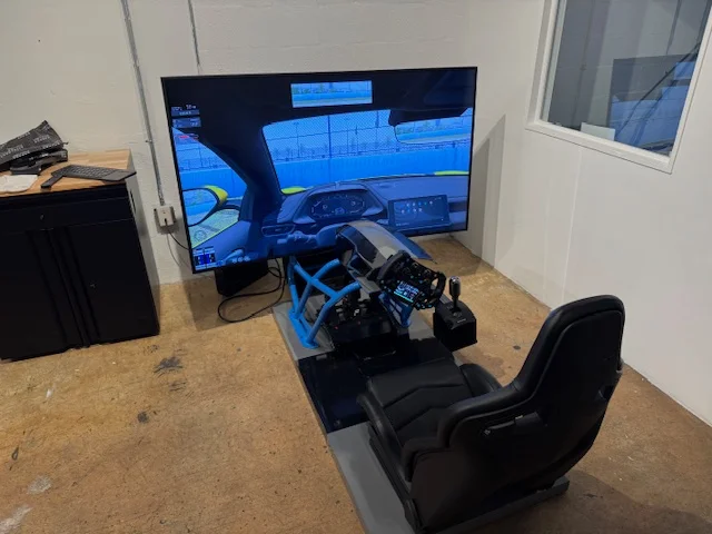

I ran an expensive simulator with my actual car. I get better times on the track. If I go much faster I spin. Lol.

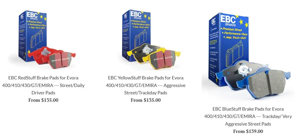

Is there any consensus on what pads are best for mixed track and street use? After reading this thread I think I want to upgrade the brake fluid and pads before tracking. I keep seeing conflicting opinions on EBC yellow and blue. Any insight appreciated.

If you believe this chart, then Blue NDX is the step above our OEM pads. Normal Blues are an equivalent to OEM pads. Yellows would be a step below.
I will be trying the Blue NDX pads but I won't be swapping between pads during the same track day...at least I hope I don't have to due to problems...

Btw the EBC pads go from Red -> Yellow -> Blue for less aggressive to more aggressive driving, right?

Sorry, I had the yellows and blues mixed up. You are correct in the progression towards track work.

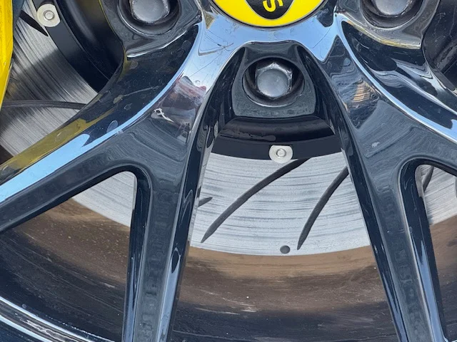

My OE front pads didn't last long on the track. 60 laps or so. I tried EBC Blue. They have over half left after 100 laps or so. But they put slight grooves in my new Rotora rotors. Both felt fine to me.

The seem fine. They stop fast. At some point, that feeling where the car would overgrab on the street slowing down for a light went away. I'm not sure if that's the new rotors or the pads. On the track simulator, the Emira brakes better than most cars.
I'm concerned about these grooves. You can fell them too. All 4 sides of the two front rotors.
