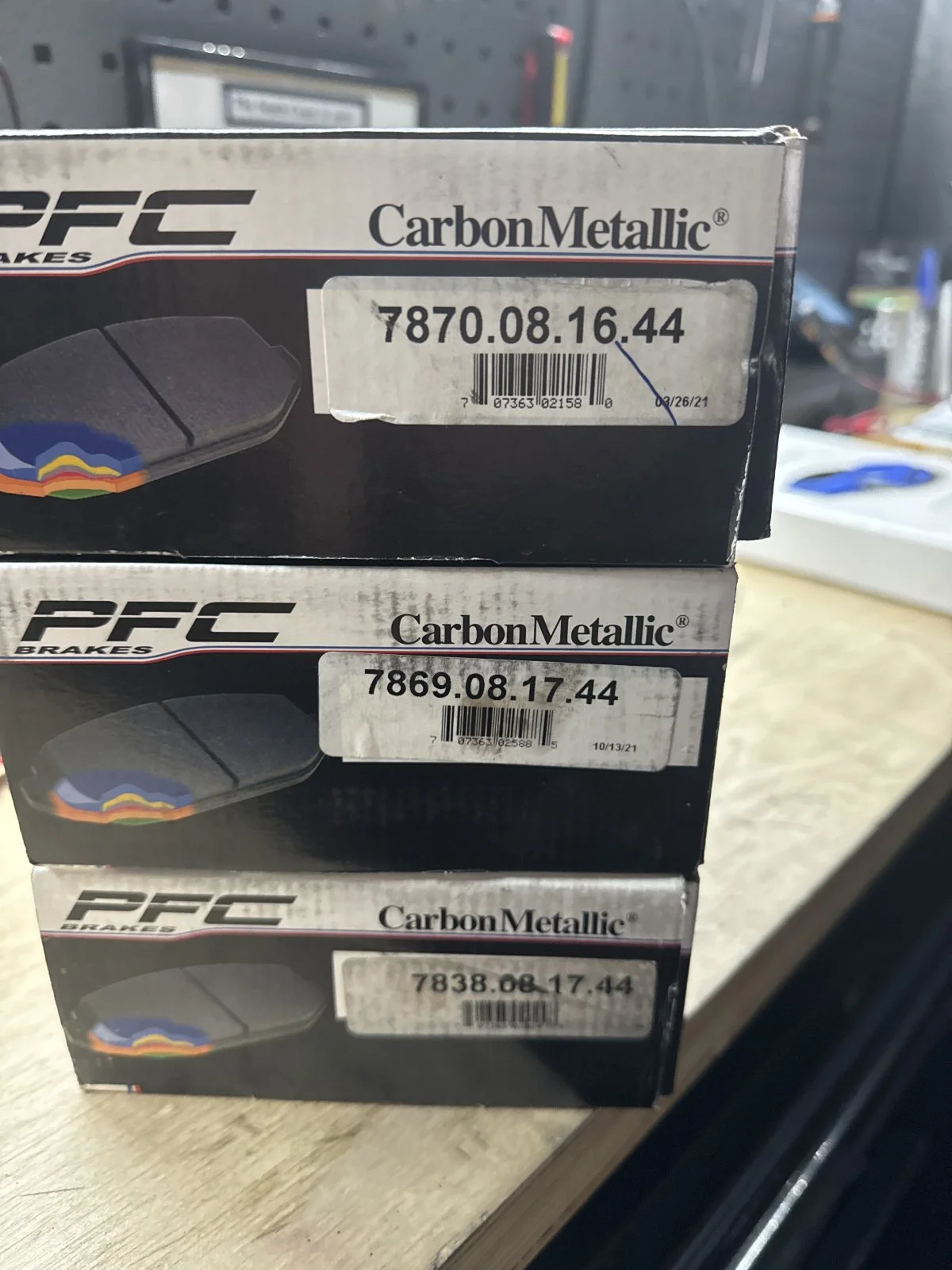

These pads https://www.seriouslylotus.com/performance-friction-front-brake-pads-emira
Pads are down about a third maybe closer to half worn.

That’s the boxes for the pads.

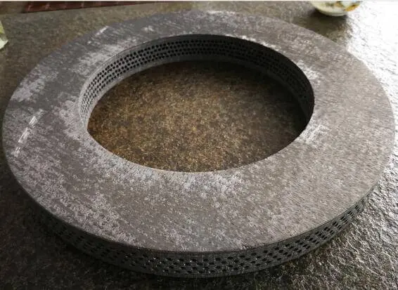

I don't think the rules about drilled v slotted holds for Carbon Ceramics.
I've seen plenty of Carbon Carbon race brakes with drilled holes. Though on more serious "F1" style I guess you do also see something more like
But I don't think I've ever seen a Slotted Carbon rotor.
Yep, hence why I was curious about non-CCB (iron rotors).
