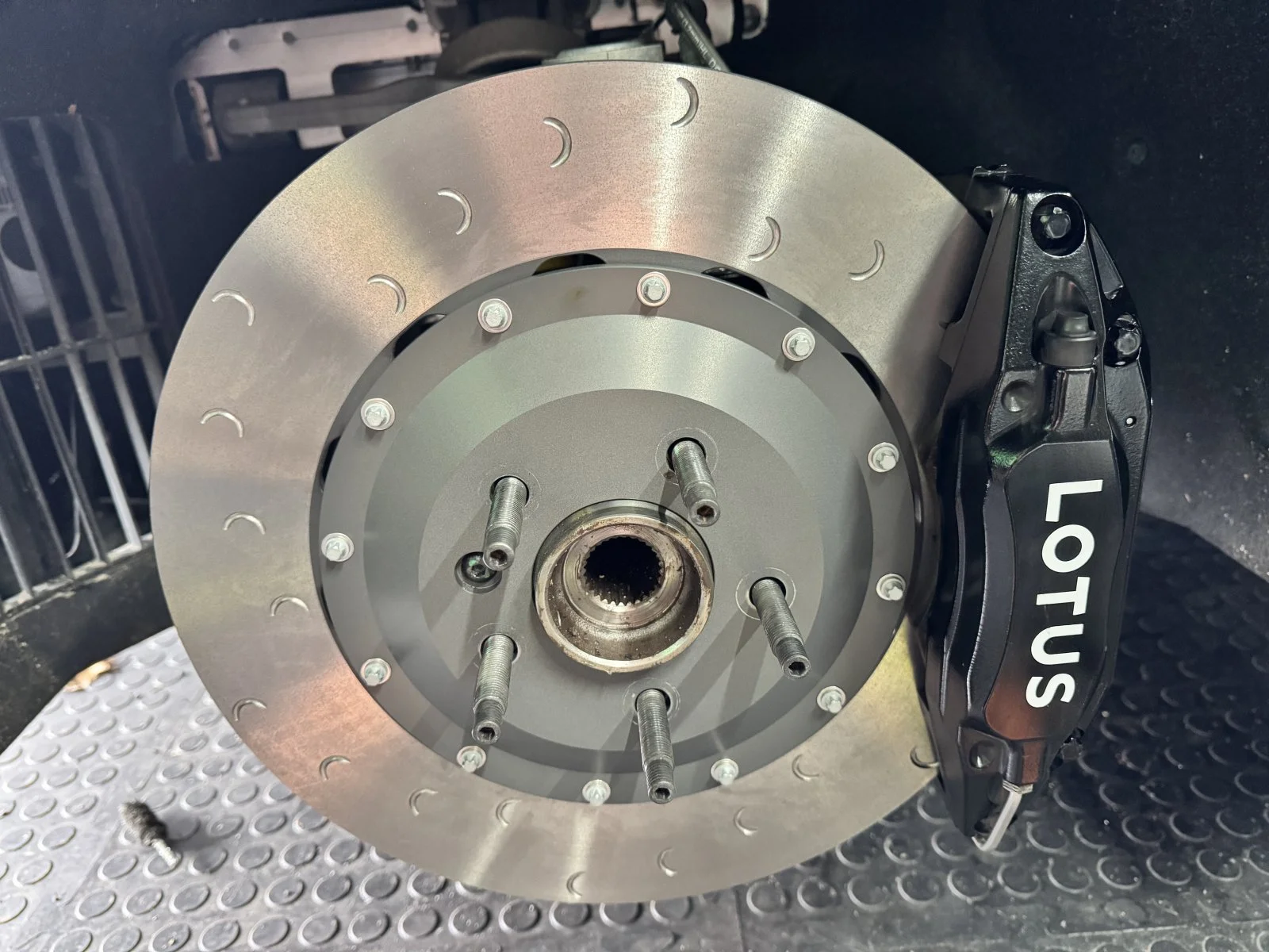

Alcon discs and bells up front. Now to build a rear bell.

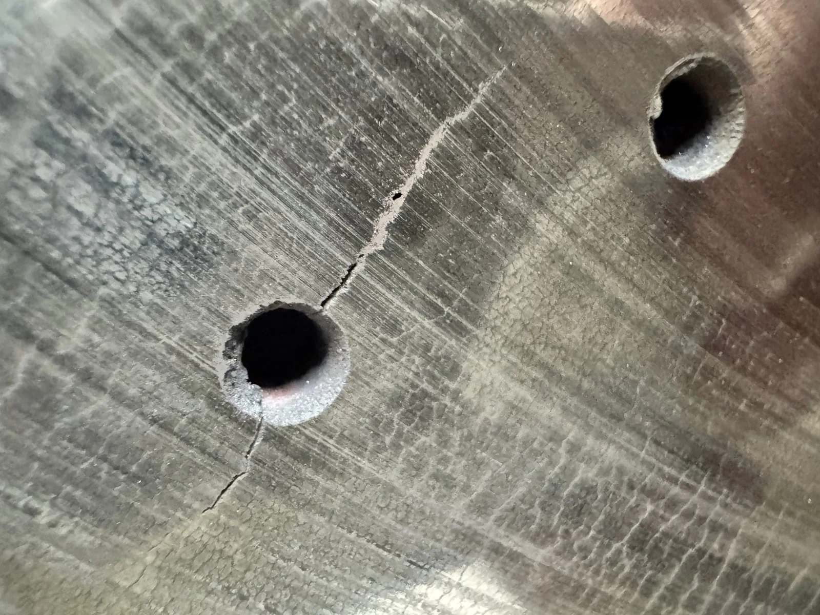

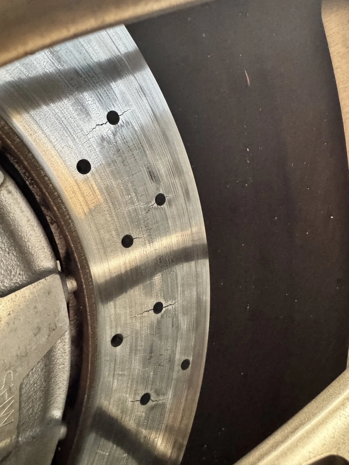

Original discs are not up to track work, no discs that have holes are. That’s why race teams don’t have discs with drilled holes.
You can see how destroyed my fronts are after three hard track days.
Lotus won’t entertain a conversation about upgrades so I am going it alone to make it work.
Not looking for increased braking just discs that don’t fall apart.
Will they entertain a conversation about replacements? Because that should be covered under warranty.
"The standard 3-year warranty covers every component of your Lotus Emira – from the mechanical elements to the interior materials. There is no mileage limitation so feel free to drive as much as you want."
Thanks for the info. What did a set of these run you for the front? I guess you’d get away with the OEM on the rear?
I skimmed my front discs, they were vibrating badly after I’d trashed the OEM pads and swapped in some Endles mx72 pads. I suspect I had left lots of residue from the OEM pads. So far, the skim seems to have fixed the vibration, but they need to be bedded in yet.
My OEM rears are beginning to crack as well. Front hubs are the same as Evora 400 series so availability is easy that end. Nobody that I can find has yet produced a rear bell. I am about to send off a rear disc to get a suitable bell manufactured.
The front discs are £1290 with bells. A replacement disc pair is £600 next time though as bells will remain.

I think you mentioned you used PFC pads - which model? Also, how much pad was worn over those 3 events as you mentioned before the cross drilled holes began to crack? Thanks!
