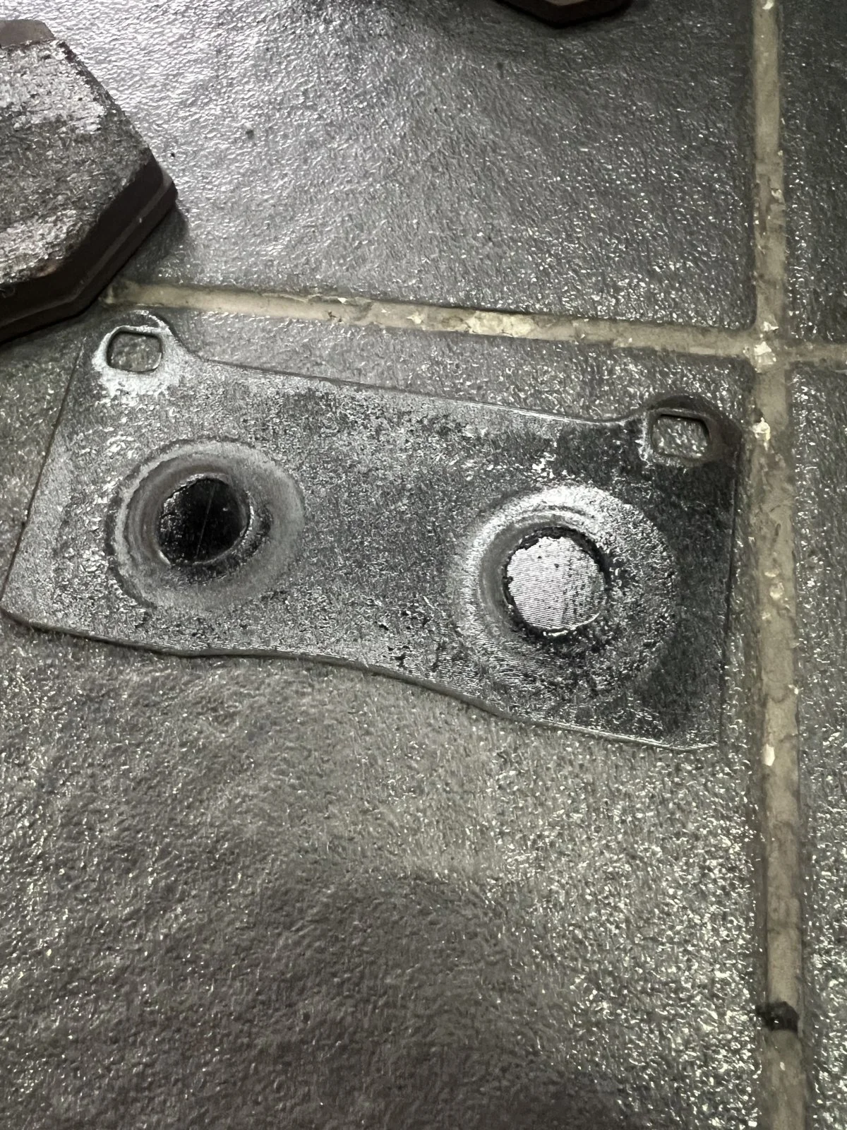

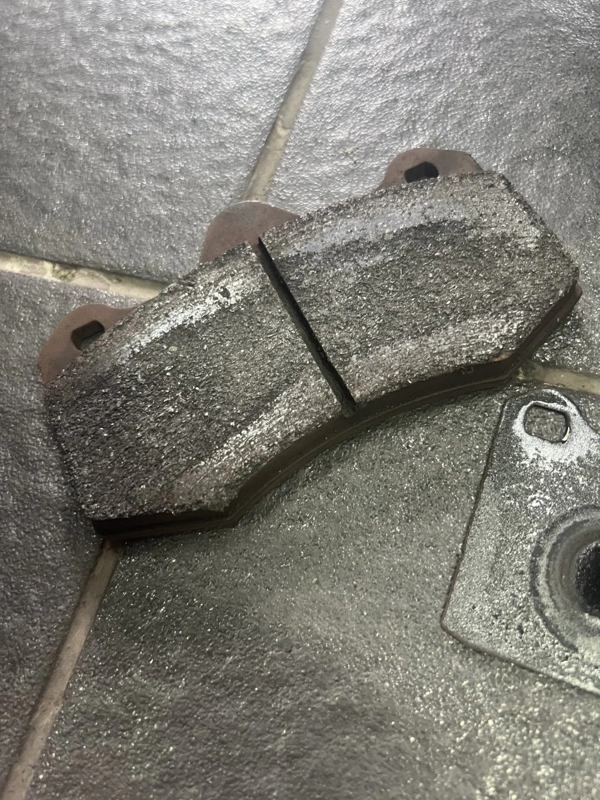

Here are my pads after 1 hard session and a second session with gentler braking.

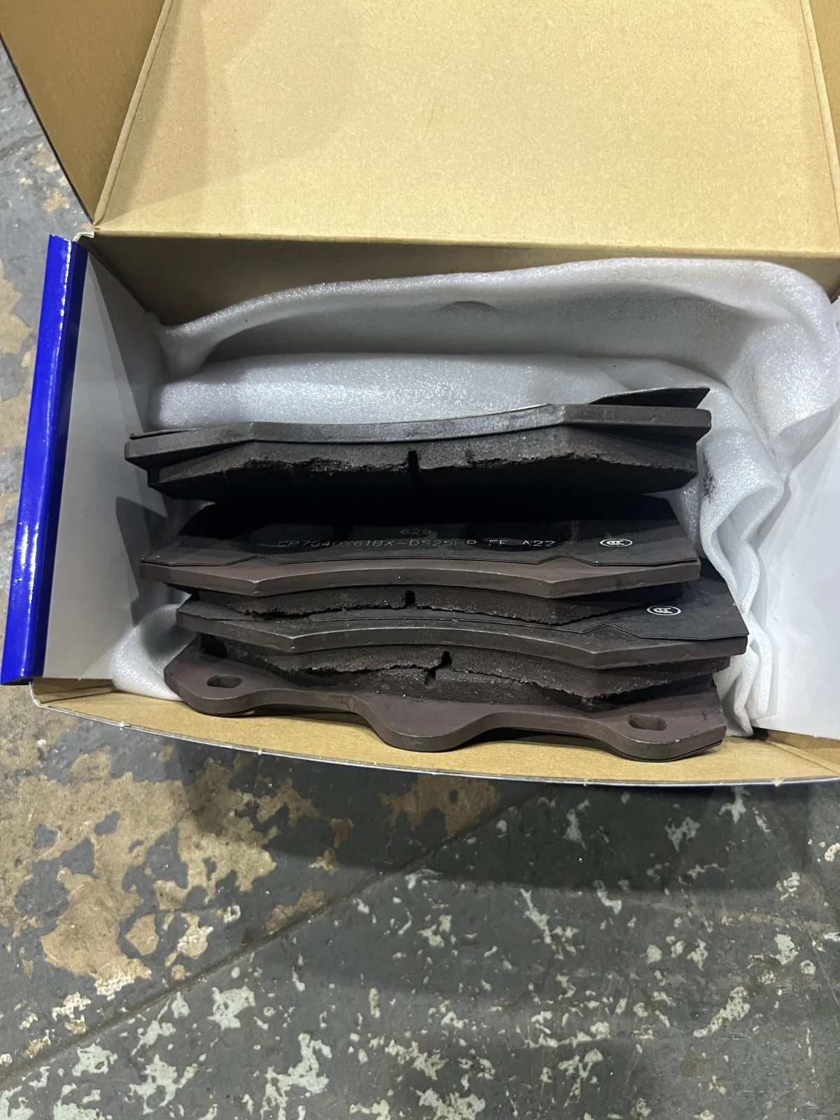

BTW, my discs (front I guess) are vibrating pretty bad after I’d swapped in the Endless MX72 front pads. Tried to rebed them, but it’s not really helping. I suspect the OEM pads had left lots of residue on the discs, but hard to know exactly what’s up and what exactly caused it (I didn’t let them cool down enough). The brakes weren’t 100% before I did the front pad swap, but they are definitely worse after the pad swap (and a few sessions). Bringing the car to Lotus, hopefully they can clean up the discs.

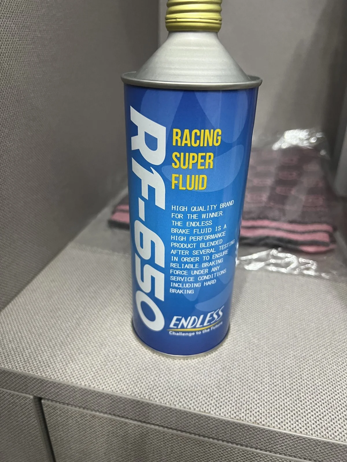

Today I had the front discs skimmed, fitted the rear Endless MX72 pads and swapped in some Endless brake fluid.
Gonna lightly bed in the discs, but so far it seems like the vibration is gone. I suspect the deposits on the front discs primarily came from the OEM pads.
Rear OEM pads are shown below, as well as the disc skimming. So happy to get it fixed. Had to drive 200km back from the track. Wheel was shaking at 70mph plus due to balance issue and brakes vibrated when I touched them, the car felt totally shagged :cry:

Let us know how you like the Endless pads and fluid. I have a friend who swears by both.
