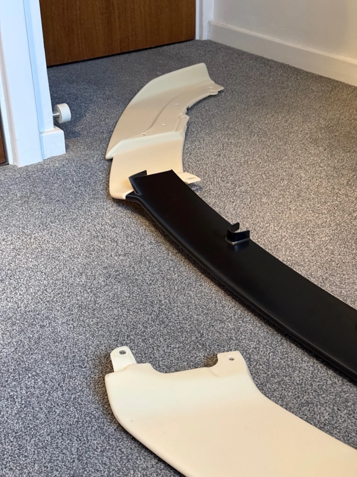

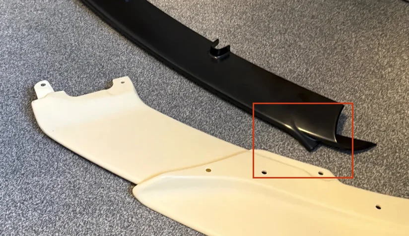

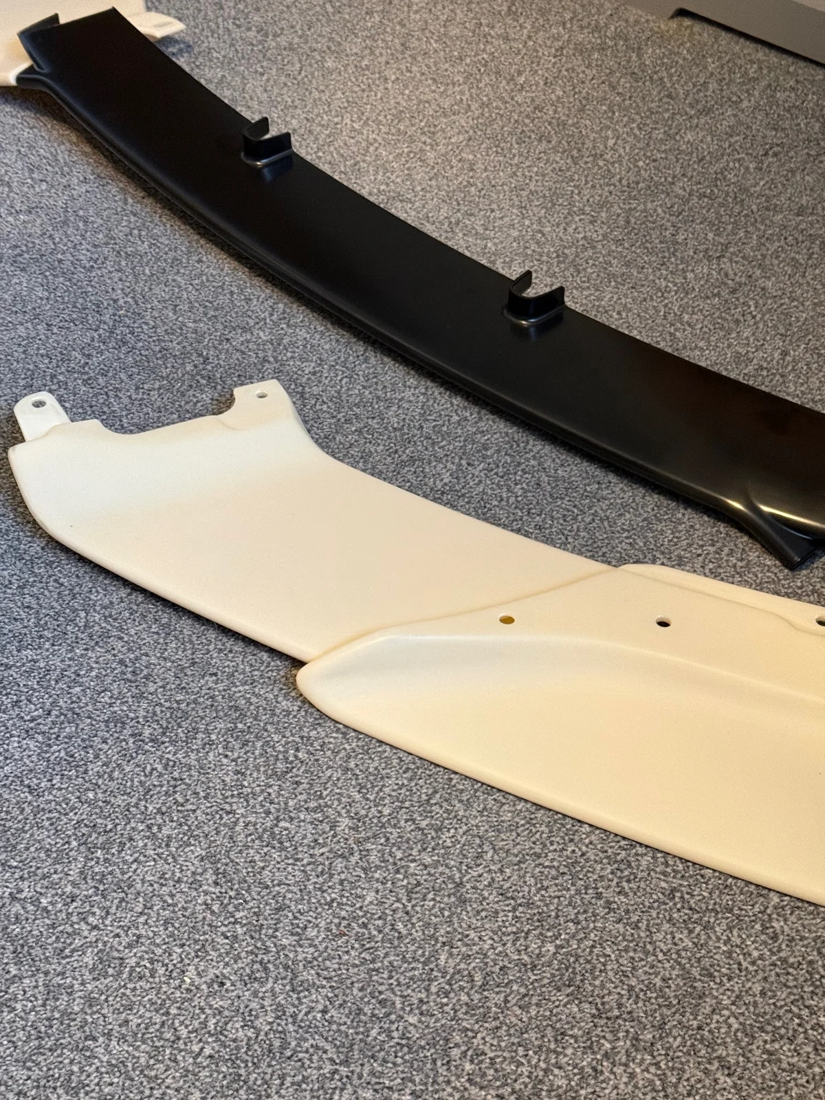

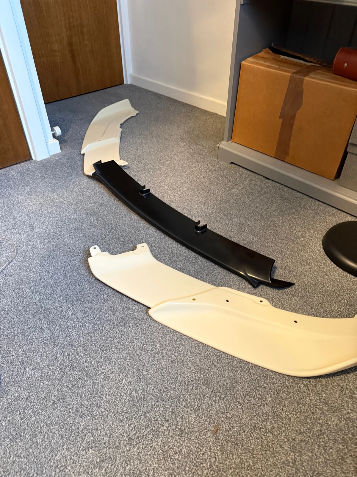

Just received my 420 Sport front lower splitter. It's 3 pieces - all are ABS plastic and two are this off-white colour. Definitely needs painting and prep. Not sure if it needs mounting hardware yet.. I'm going to guess it will need hardware of some sort. The centre piece looks like it might slip over the existing bumper. The two side parts look and feel pretty well made.

I had a few minutes in between calls and I went and offered up the parts to my Emira. Upon initial observation, it seems the parts will bolt right up to the underside of the bumper. The existing black centre piece looks like it will come off and the new one should fit in place. The side splitters have mounting holes that appear to line up with existing screws and/or holes already pre-drilled under the bumper cover. We may need longer screws, some washers and potentially some riv-nuts for some of the pre-drilled holes... but doesn't look difficult. I also have two metal donuts mounted to the underside that I guess are splitter savers on my stock bumper. Those would have to likely come off. Anyways, I'll look to get the parts painted and installed in November or December.
