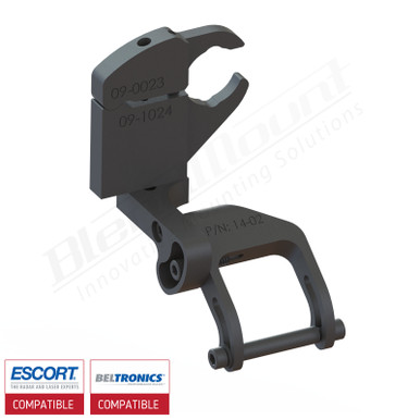

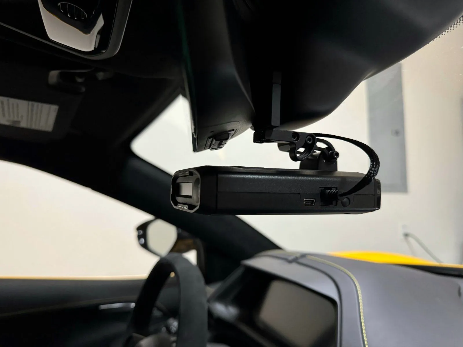

That's a Blendmount. I have a Blendmount in my Emira as well for my Escort detector. Not cheap but very high quality and so much better than the suction cup mounts.
I do have a blend mount for the Evora. Will that one work for the Emira. If so then need to order another one.
Did not see one on their website for the Emira

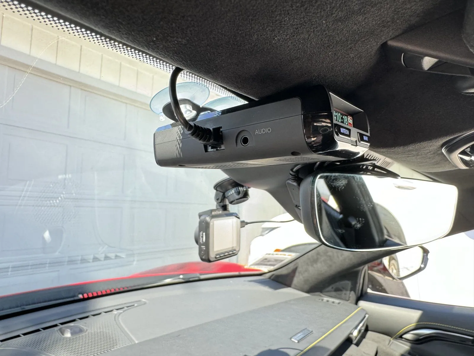

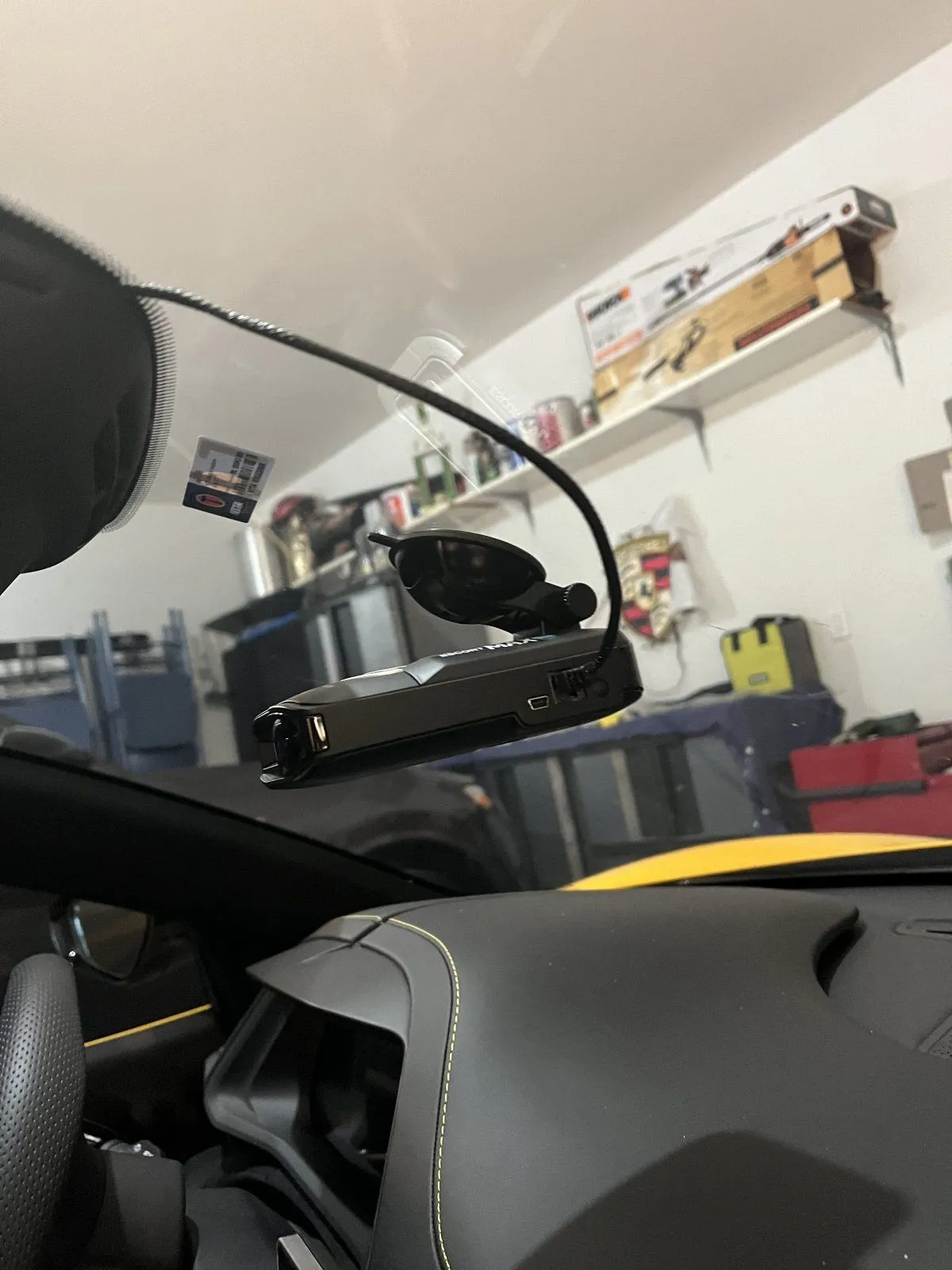

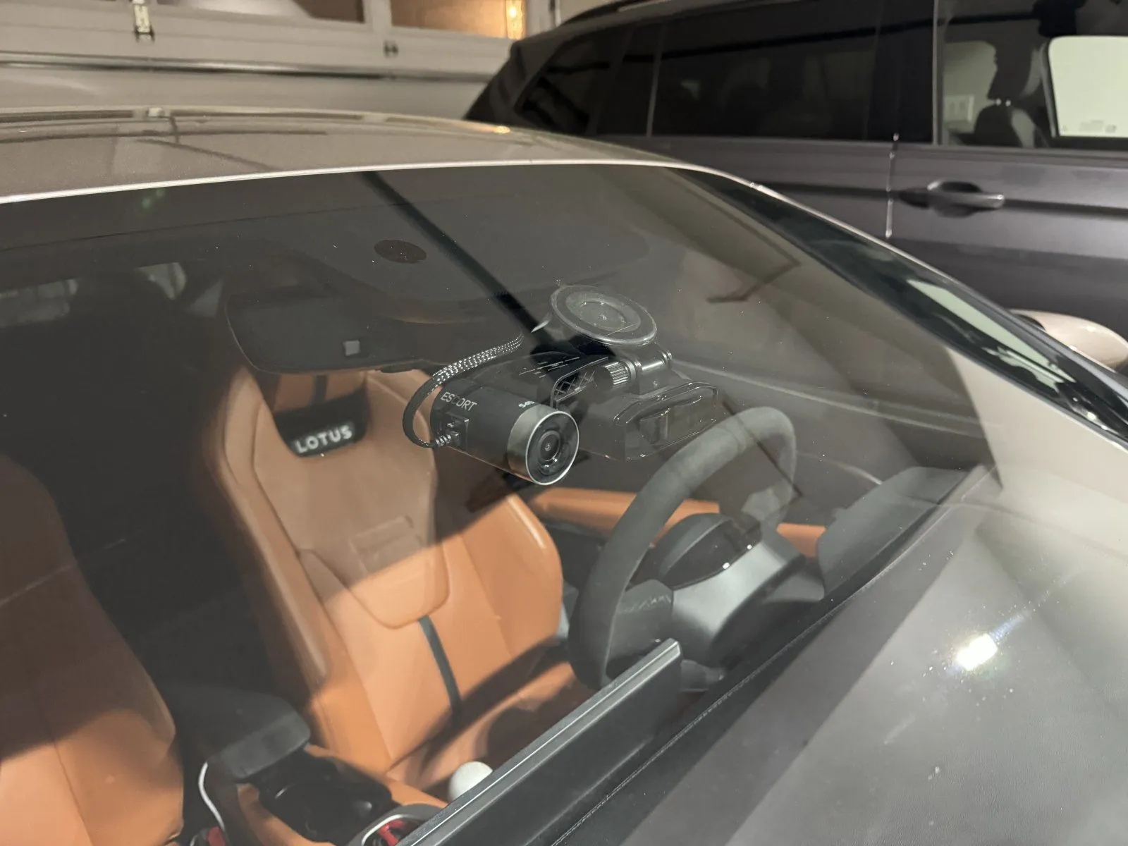

Escort Blendmount:
Valentine Blendmount:
Blendmount thread:
I used the smallest tap in this set https://a.co/d/dhfO3ZW for my redline 360c
Escort Blendmount:
Blendmount thread:

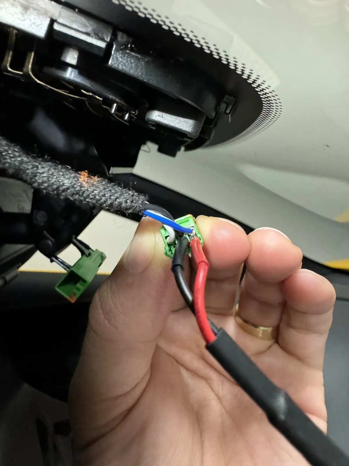

Thanks for those pics! Right now I'm planning to use the 5v to 12v step up USB connector. If it produces the same intermittent issues, I'll go to a mirror tap.
Cool yeah that is definitely easier. My redline was working properly with the usb port but I just didn’t like the bulkiness. Mirror tap is cleaner and saves the usb port for other things.

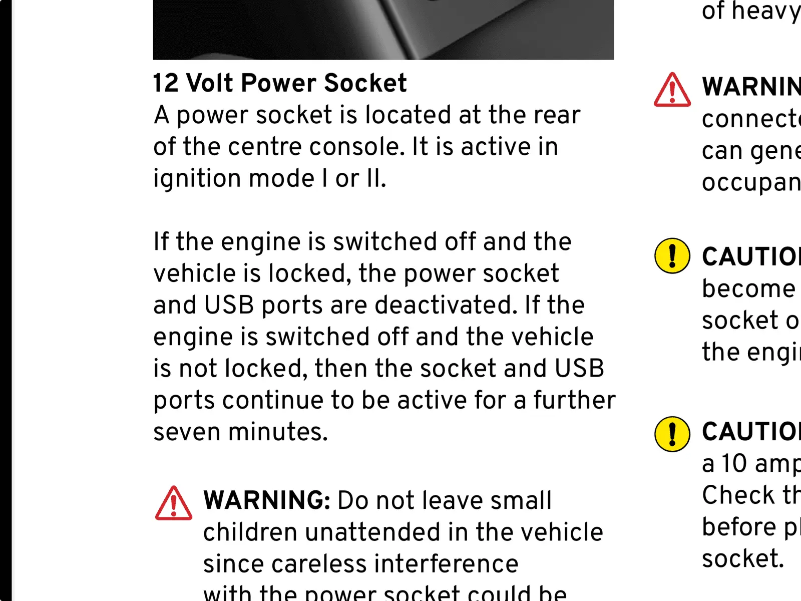

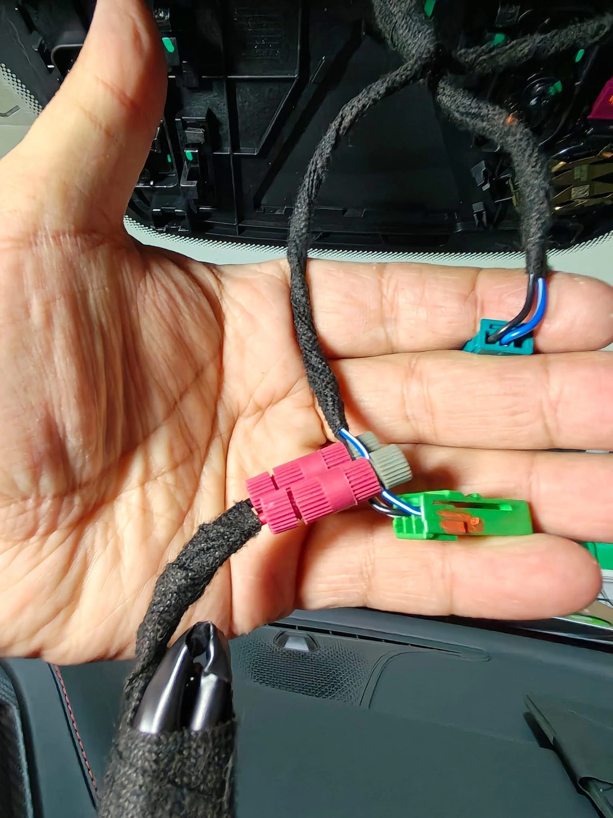

Interesting note...I tapped into the green connector as did others and the Radar + Camera STAY ON even after I turn off and lock the car. I thought this was an ignition-controlled feed? I'll test more later when I have time but so far it seems to be constant on.
This was super helpful. I couldn't find any clips or tabs anywhere visible. Per your guidance, I just got my fingers under the section in the red circle and pulled and eventually it popped loose. I hate removing pieces like this as I always feel like I'm going to break them. The second part comes off pretty easy just pushing upwards.
Ok so it's not constant on but there's some sort of timer. I waited several minutes and it remained on. Tonight when I got home I set a timer for 20 minutes to check on it and when I went out to the garage it was off. So somewhere between about 5-20 minutes it finally powers off.
This is good for me because I really don't want to have to bother with unplugging it or turning it off manually every time the car is going to be parked for awhile for fear of draining the battery. I'm sure eventually it would've happened to me.
The mirror tap method is very nice and clean.
After a couple hundred miles, I've switched from the converter to the mirror tap. My unit cut out a few times during hard driving. It didn't seem to be from the voltage, but more from the usb connection not being really solid. I could wiggle it and it would cut out. So, I went with the tried and true 12v tap. Quick and easy and no more worries.

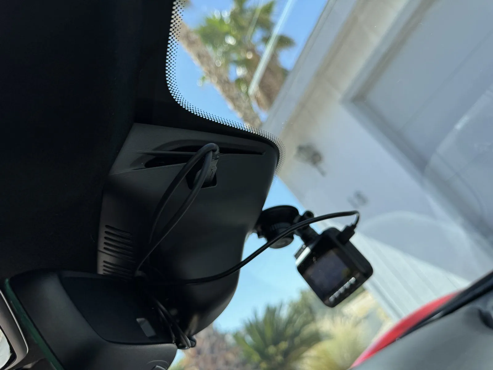

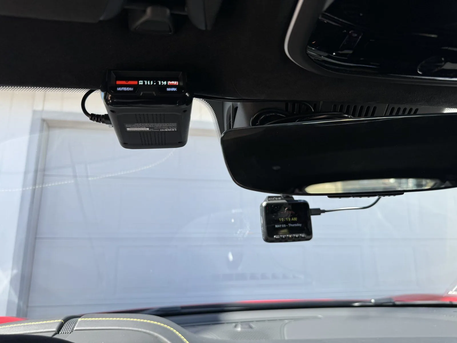

I have a radar detector (Uniden R3) and a dash cam (Rove 4K) both connected to the same USB and both work flawlessly without issue. I use a USB splitter I got on Amazon and the important part is the USB to RJ11 adapter for the radar detector to supply the correct power. Amazon US Links USB to RJ11 adapter USB Splitter
All that "stuff" on the windscreen would drive me nuts
I am 6' 4" so use the top third of the screen rather than lower down, but even so, that would be annoying
Blendmount is nice but expensive.
Ive used mirror mounts from Radar Mount. Same kind of setup but waaaaay cheaper and just as functionally effective. 😉
