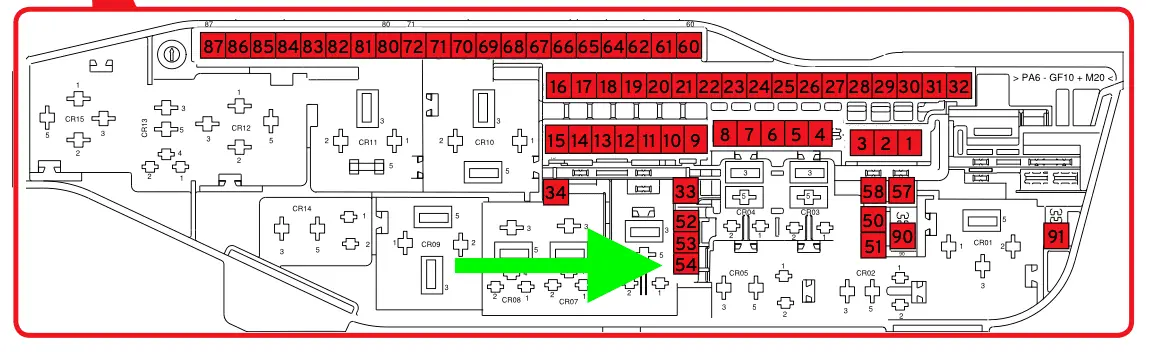

I think I did blow it, since my glovebox light is out. Any idea where the fuse box is? Trying to find it under the passenger footwell.
kitkat
Emira Degenerate
Mar 5, 2022
2,220
4,182
Mountain View, CA
Yup, fuse 54 which is a 10amp fuse.

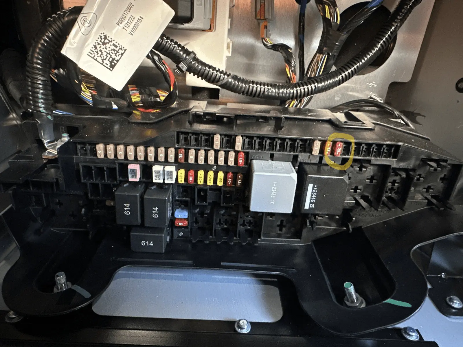

Figured it out - this one:

Figured it out - this one:View attachment 40439
Okay got it then you tapped into the circuit for fuse 82 a 7.5 amp fuse, I think there's other wiring up there that is on a 10 amp circuit, you might wanna tap that instead.
Fuse 82 is responsible for rain / light sensor module, vanity mirror illumination, overhead console, glove box illumination, glove box switch, and interior rear view mirror module.

All fixed up now, the 7.5a fuse got replaced and all is well. Car is throwing an error for SRS or something but I’ll see if I wait that out and it clears.

FlyNavy01
Jan 14, 2022
283
571
WA/FL
Bunch of spares per the manual, but since none of them line up with the diagrams well I’m not going to bother trying to tap them.
Easier to do the mirror tap and the usb above the rear view mirror.
The diagram @kitkat posted is correct, it's just mirrored because it's on the other side in the UK. Once you flip it everything should line up?
