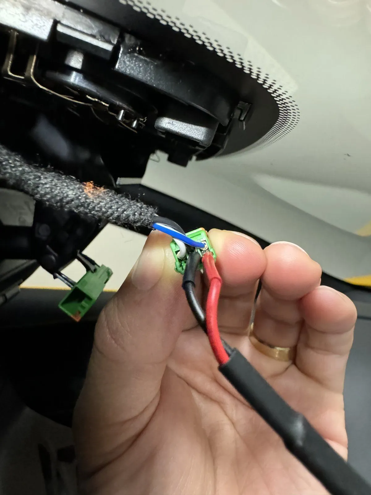

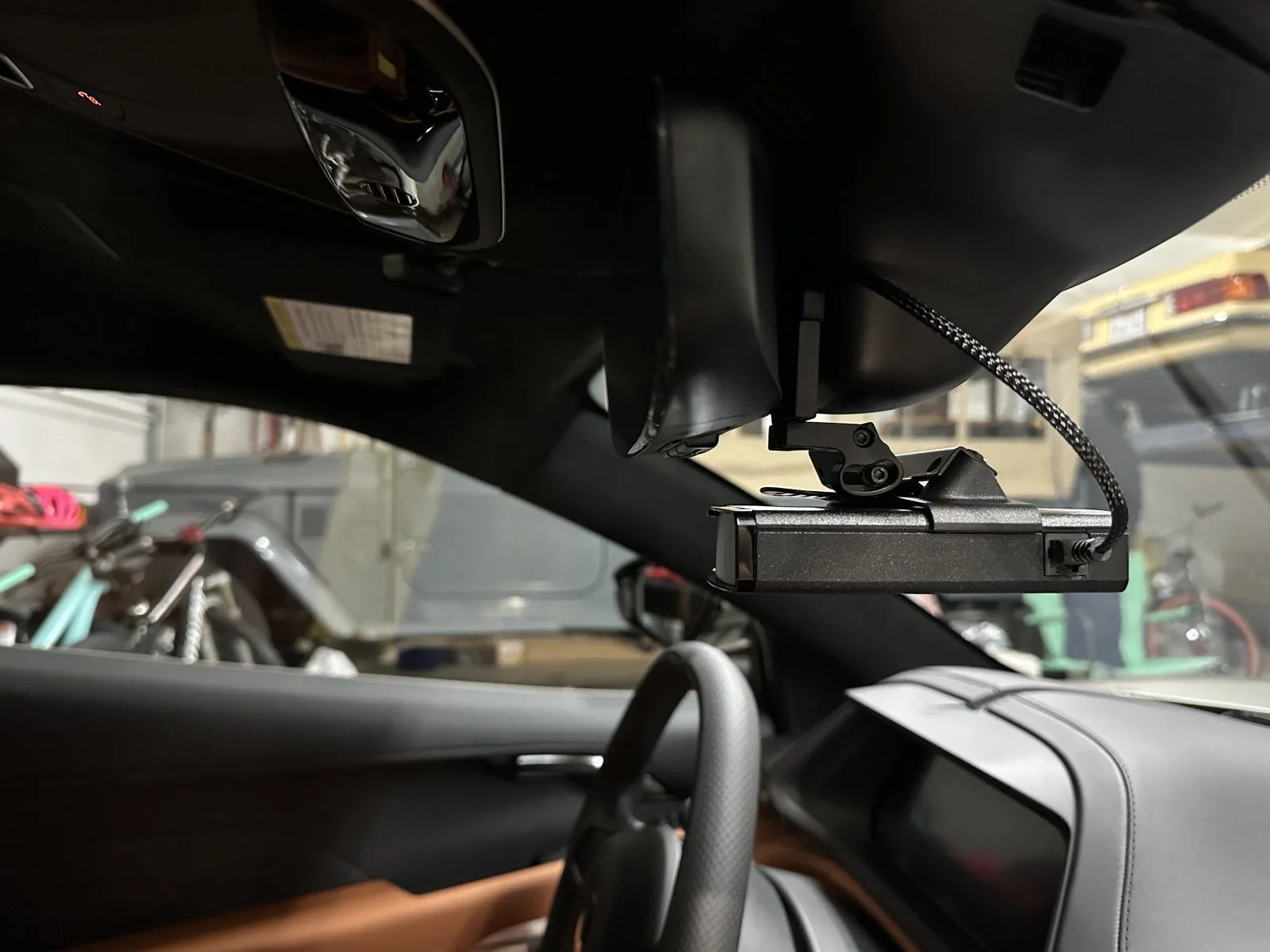

What mirror mount are you using.
That's a Blendmount. I have a Blendmount in my Emira as well for my Escort detector. Not cheap but very high quality and so much better than the suction cup mounts.
