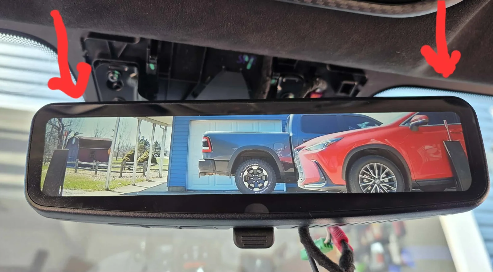

This weekend finally had some sun but it was still 32F outside. I decided to test out the Korean digital mirror. I removed stock rearview mirror and mounted up digital mirror. Taped the camera to the upper rim of license plate frame under stock rearview camera and roughly ran the camera wire into cabin through passenger window from outside. Hooked up positive power and negative ground of the digital mirror to a spare Antigravity Lipo battery i had laying around from the 4C. This is only a digital mirror, not a smart mirror with dashcam capabilities. But mirror UI is easy and image looks clear with great refresh rate.
Note: I didnt complete full install on Saturday as it was super chilly outside and I didnt want to spend time dropping the rear diffuser (again for the 25th time) and remove the rear bumper to install camera and do wire routing as well as replace rear vents with CF ones and replace exhaust tips.

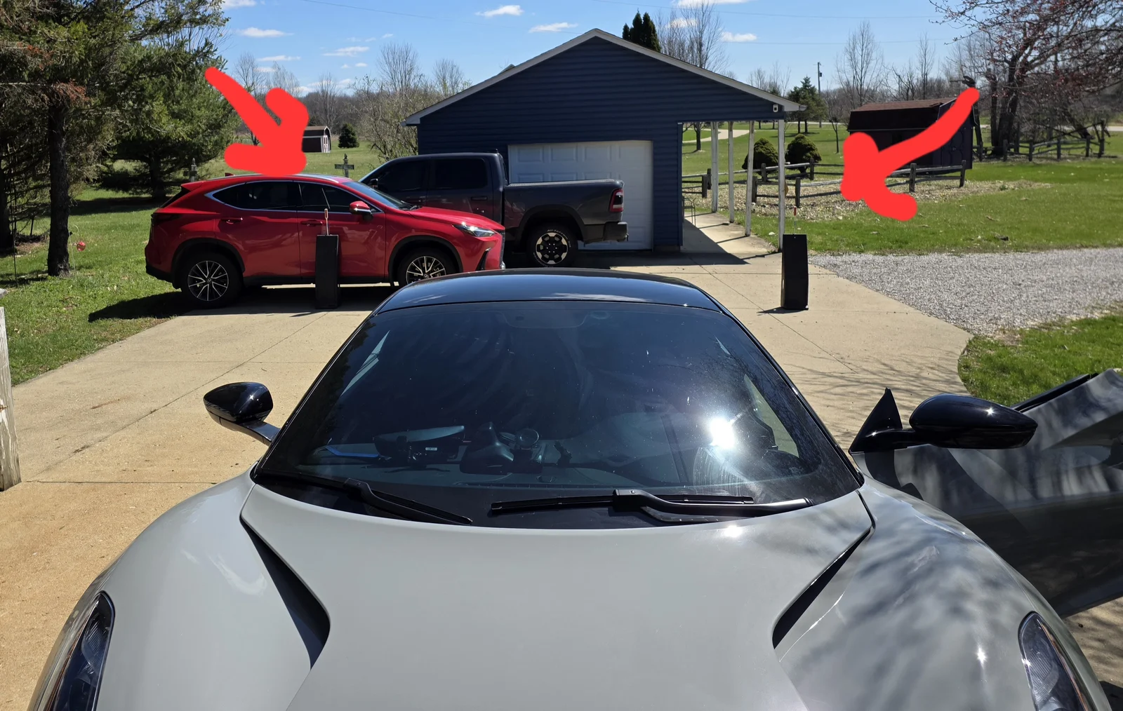

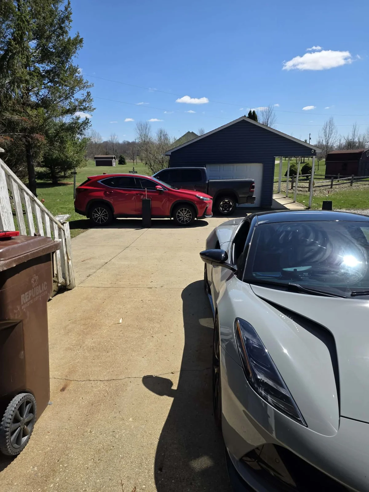

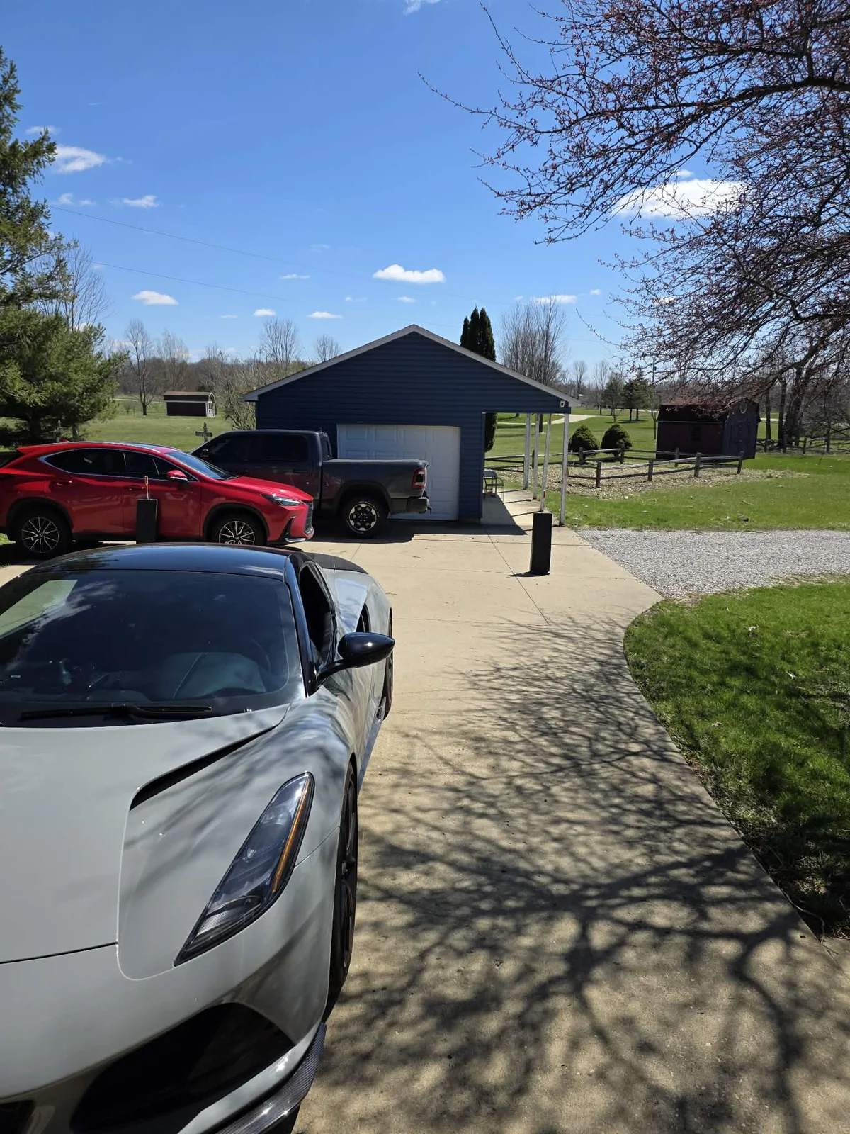

Distance of the Lexus is about 15 feet behind Emira:
Red arrows are blind spot markers I set up to show extent of FOV in
digital mirror

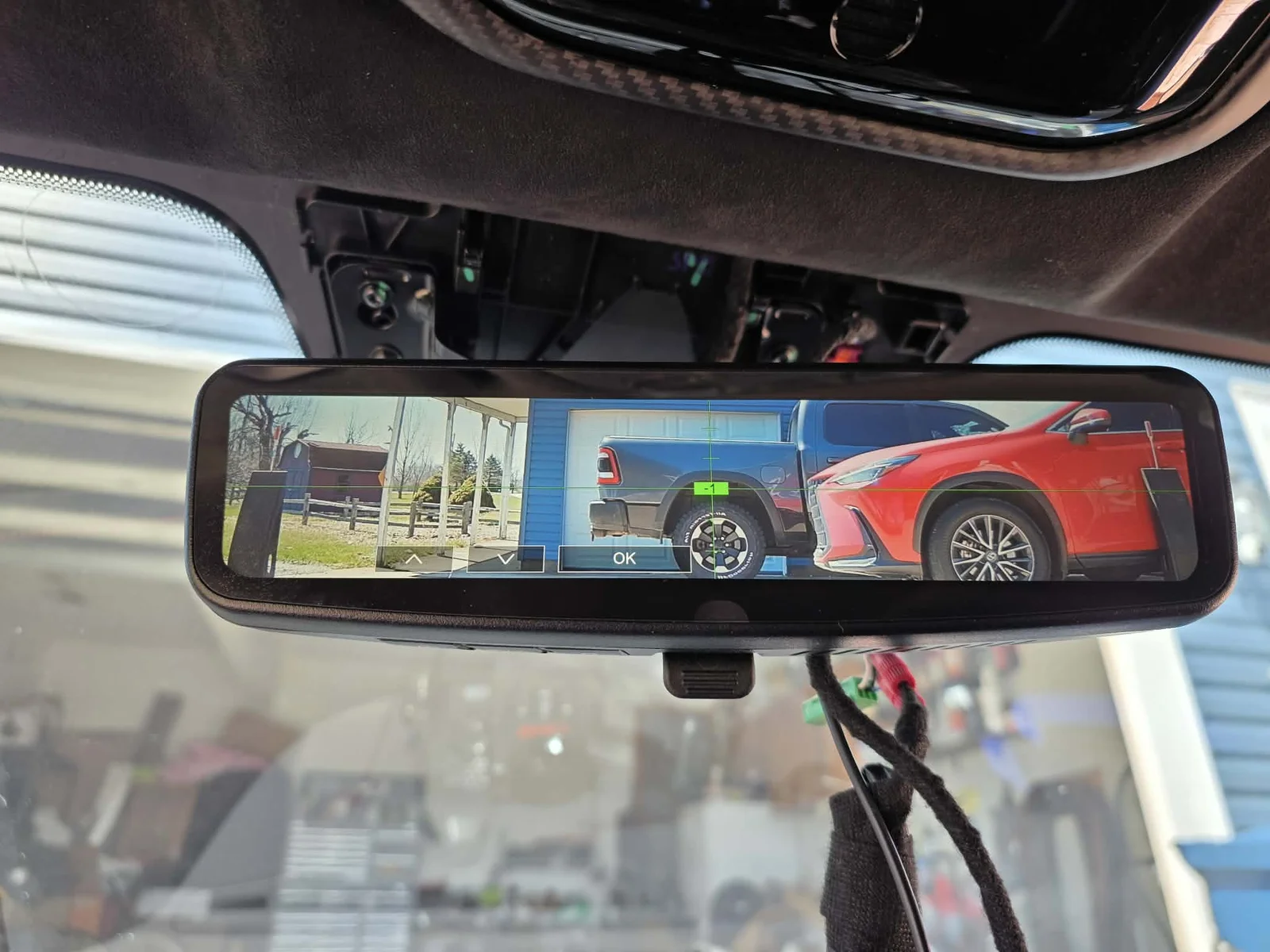

Digital mirror has green reticle for up/down adjustments so if you mount camera high or low. If you plan on mounting to left or right of stock camera, slight axial rotation adjustment may be needed to center focused view as mirror does not have left or right adjustment.

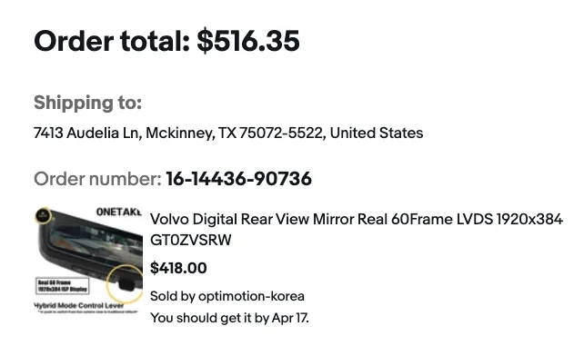

I will order this Volvo kit, especially since the seller covers return shipping should it not work.
I will post to the Group Buy thread as well. This is $418 + $34 shipping (instead of $90 they sent to me on the invoice) and minus the 7.5% PayPal / Currency Exchange fees.
I ordered with expedited shipping for $24 more.
I see Kaz was going to ask if there was any Homelink capability for this new mirror kit (posts 13 and 14 on the thread). I note lower right buttons in the above photo taken by docron, but don't know if they link to a garage door opener (and if so, how many doors?), or serve some other function. What did you find out Kaz or docron?
I note that 675430VME comments in thread post #5 that this replacement mirror can be easily converted back to a "regular mirror" with the touch of a button. Perhaps that explains the function of one of the 3 lower buttons in the photo? I'm assuming this is all the same camera/mirror L2LOGIC set-up from Korea?
Do we know if both the "camera mirror" and the "regular mirror" on this L2LOGIS system, have auto dimming functions for night driving?
Getting a photo of a night view of the "camera mirror" showing traffic behind with headlights, would be a nice addition to this thread (dimmed and not dimmed, if possible). I did look at the manufacturer website video but it seemed to show rain (daylight situation?) in a city (night with street lights?) set-up, versus a pitch dark set-up.
