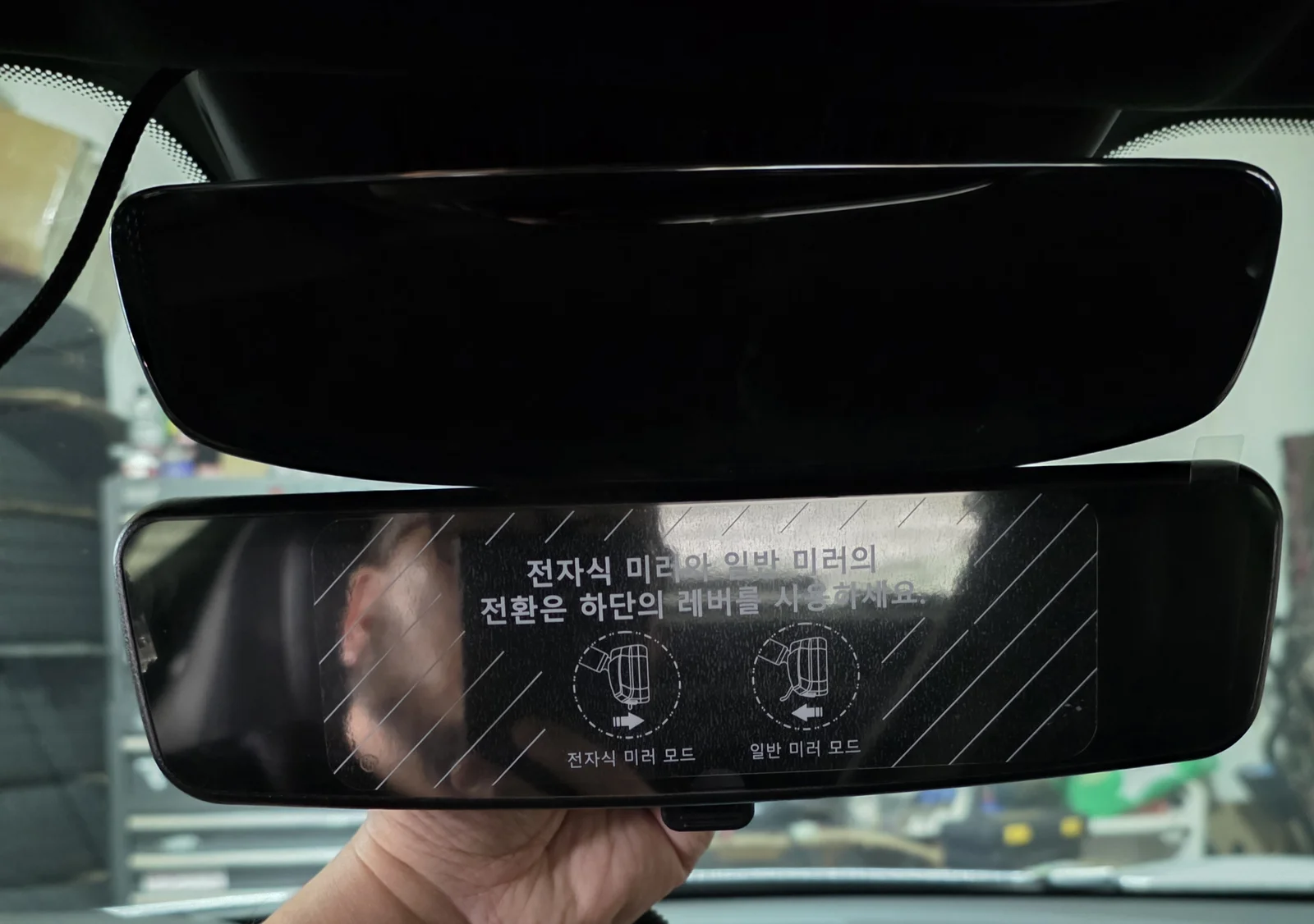

our kits arrived last month just haven't had time to install...on first look the kit will fit perfectly like OEM - I am probably installing later this week and soon for @docron
Obligatory DIY por favor.
I havent installed mine yet because the weather has been crap and I will have to remove the rear bumper to install the camera but plan to do a DIY when i get to the install. @Kaz’s AV shop should provide some insight and tips on the install when they do his.

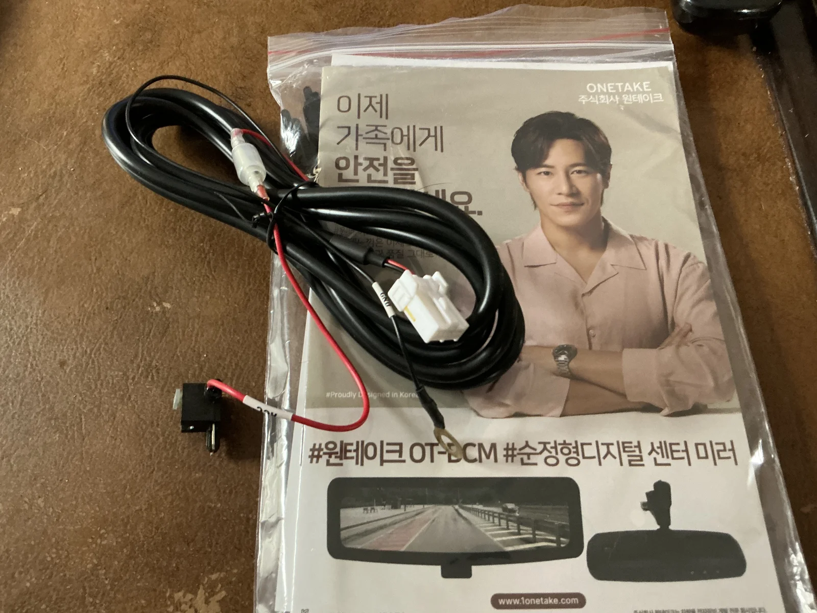

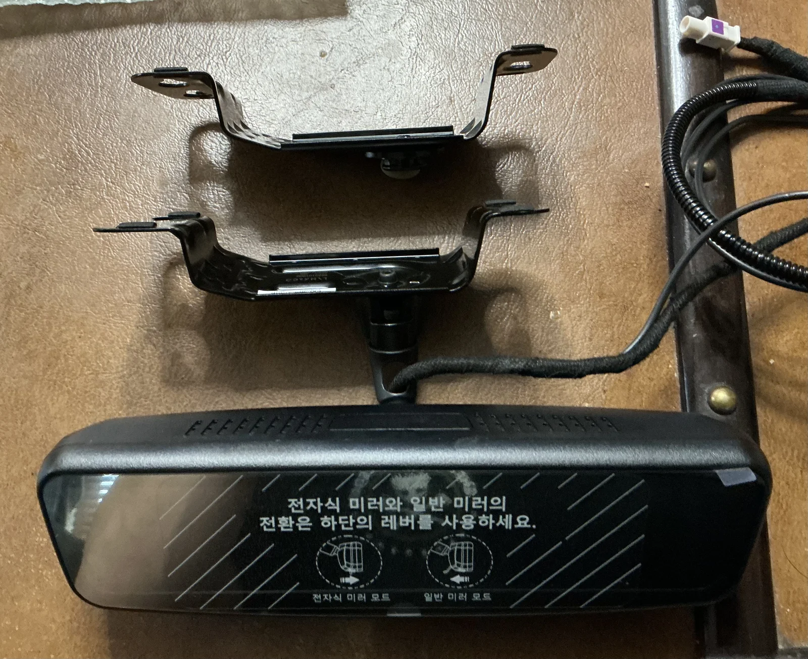

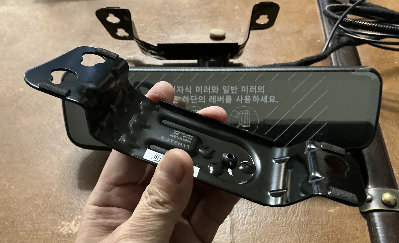

But to get started, you reuse the metal mounting bracket from the OEM mirror. I ordered a couple spare mounting brackets for Kaz and I which was about $40. You dont necessarily need a spare as you can use the one already there.

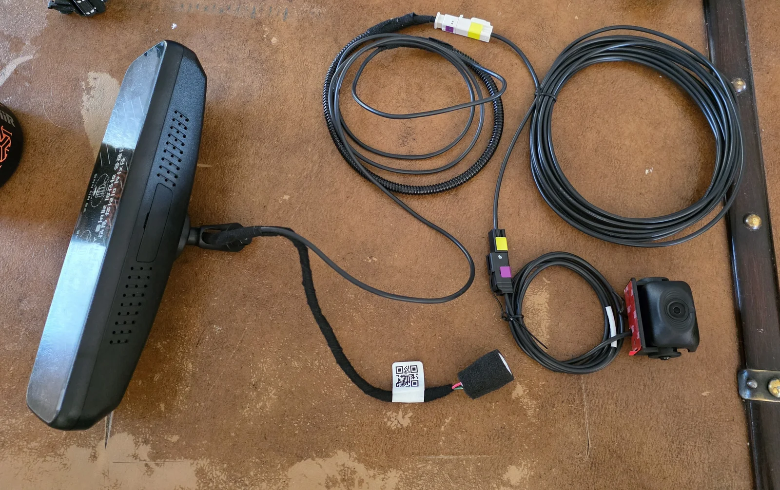

Power cord will be pretty straight forward, just plug and play into mirror wire harness, run power wire along headliner down passenger side A pillar and plug add a fuse into fuse panel and ground in passenger footwell.

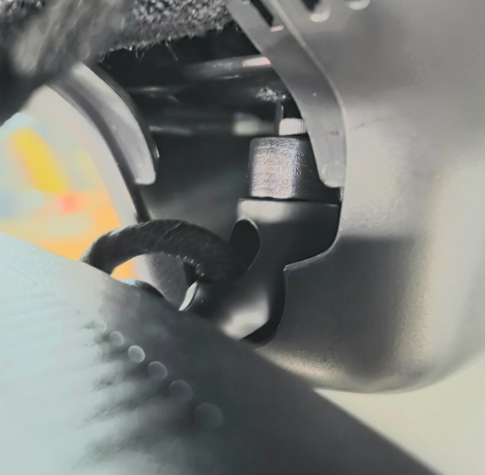

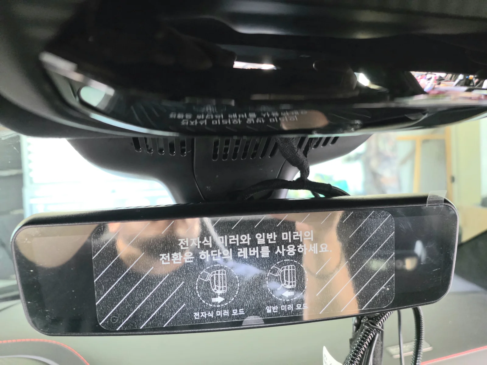

Mirror kit from Korea is great. Supplier that Kaz worked with took my measurements of stock mirror mount to hopefully allow stock plastic trim to fit around mirror stalk without having to trim plastic surround pieces. Success! No need to trim at all!

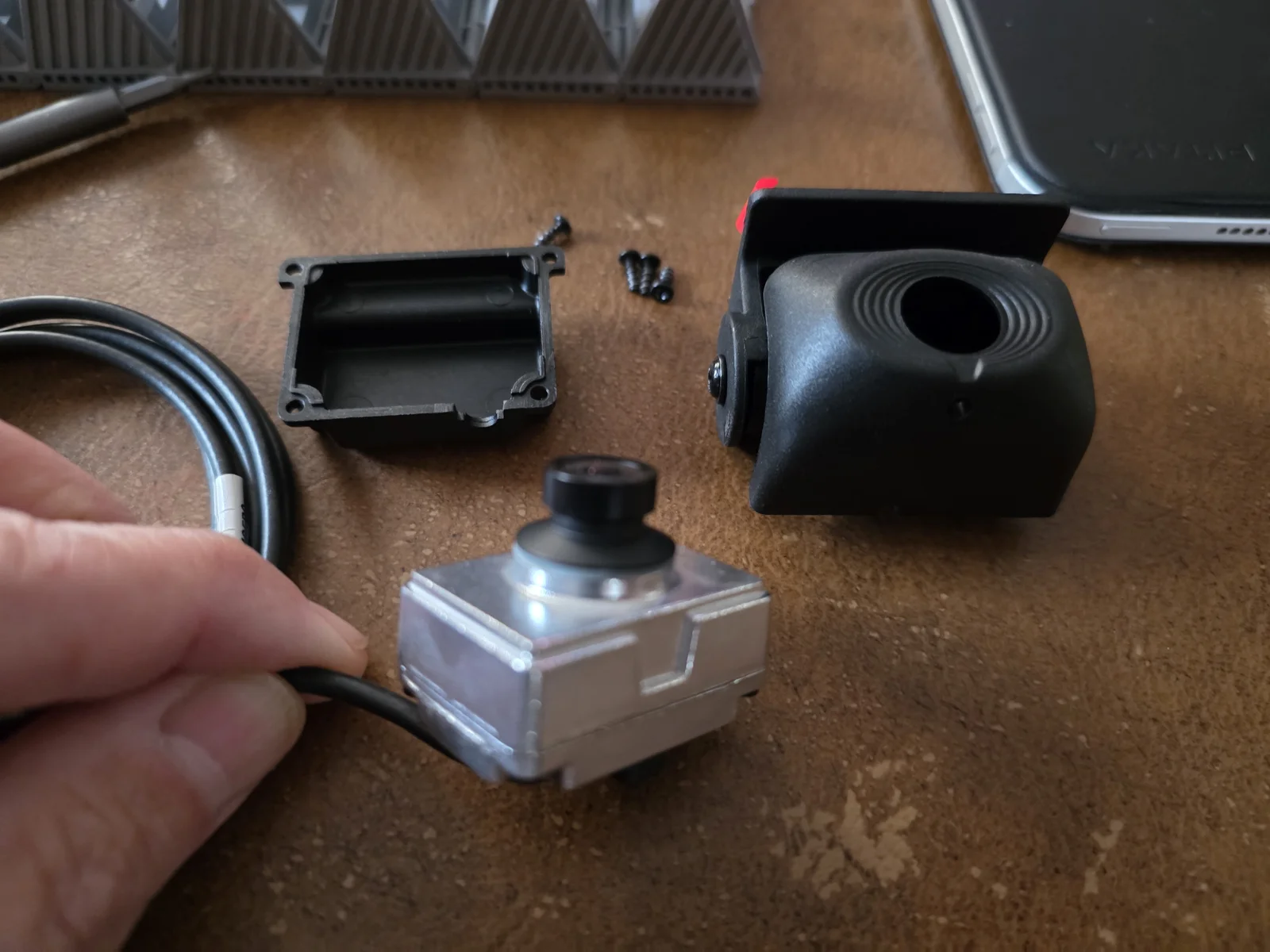

Challenge will be where to mount the mirror's camera… the camera and its housing are larger than stock. We want to preserve the stock camera for the center screen for parking assist. Ive contemplated about drilling my license plate to create a peephole for the camera lens and mount camera behind the license plate but I dont know if the camera housing can tolerate the exhaust heat.
We’ll see what Kaz’s install shop does for mounting second camera.
