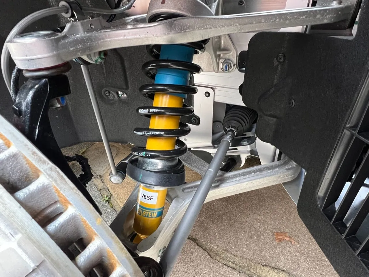

I'm kind of curious what that piece was that someone mentioned the dealers were taking out to get a slight drop. Do we have any closeup pictures of the Emira suspension where we might figure it out?
I think this depends on control arm lengths and overall geometry. Really hard to know without an actual car to measure and estimate through range of motion.

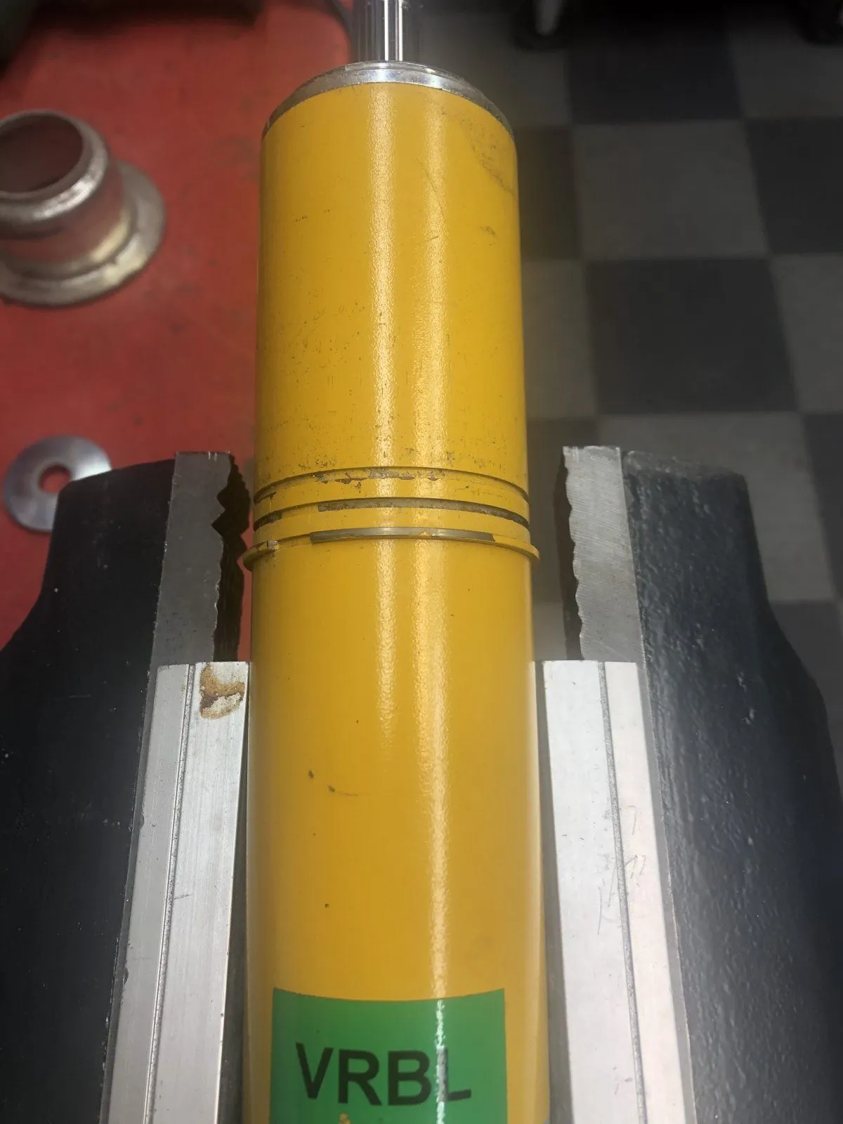

What the dealer mentioned is likely the circlip position on the Bilstein dampers that the spring seat sits on. I tried looking in past videos where it's configured but couldn't find a good shot.
Edit: The BOE lowering cup site on greg's mentions it in the notes.
"NOTE --- If fitting these on a GT please know that it will sit approximately 10-15mm lower than a 400 does with them installed. You may want to adjust the circlip position on the shock body to raise the car slightly for some middle ground on the ride height to avoid rubbing on hard corners and large bumps."
Like this?
From my Evora when I fitted the BOE lowering cups.

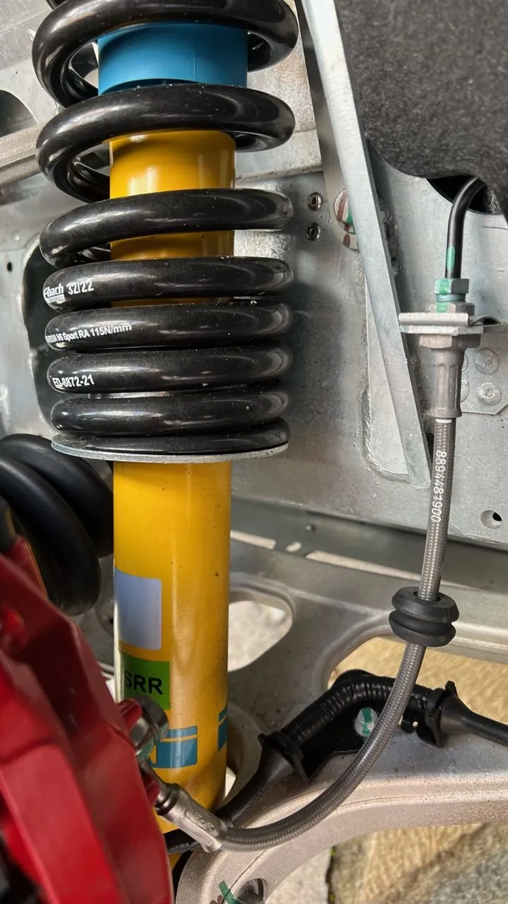

My sport option Emira has the front on the middle groove.
Rear is hard to tell as the spring obscures the cup but I think it’s on the top groove.

Looks like you could lower the Emira sport setup by 5mm, maybe a little bit more. Thanks for that information!
Edit: This is likely how Lotus fine tunes the ride height of the Sport and Touring springs. I know there's minimal difference between the two springs but with the same damper body lengths and weights -- it's hard to match ride heights. This also allows them to use the same spring perches.

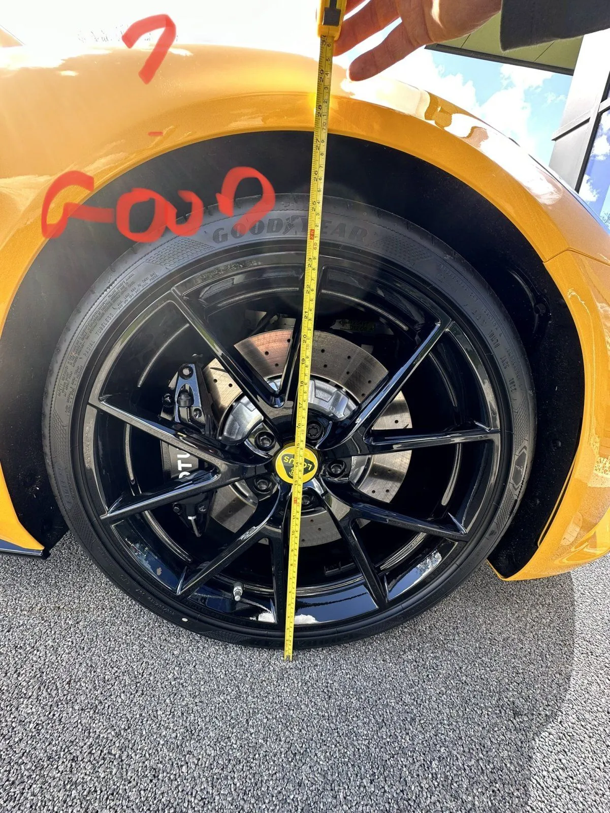

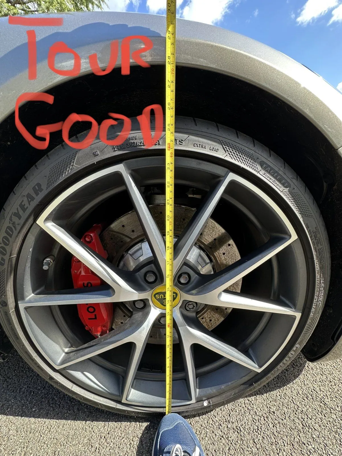

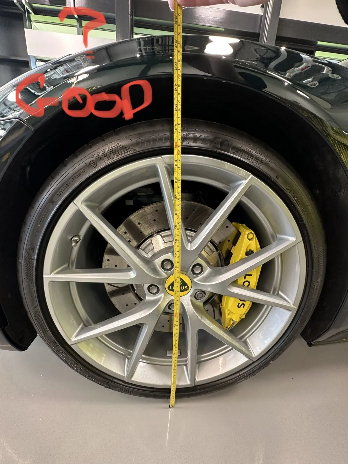

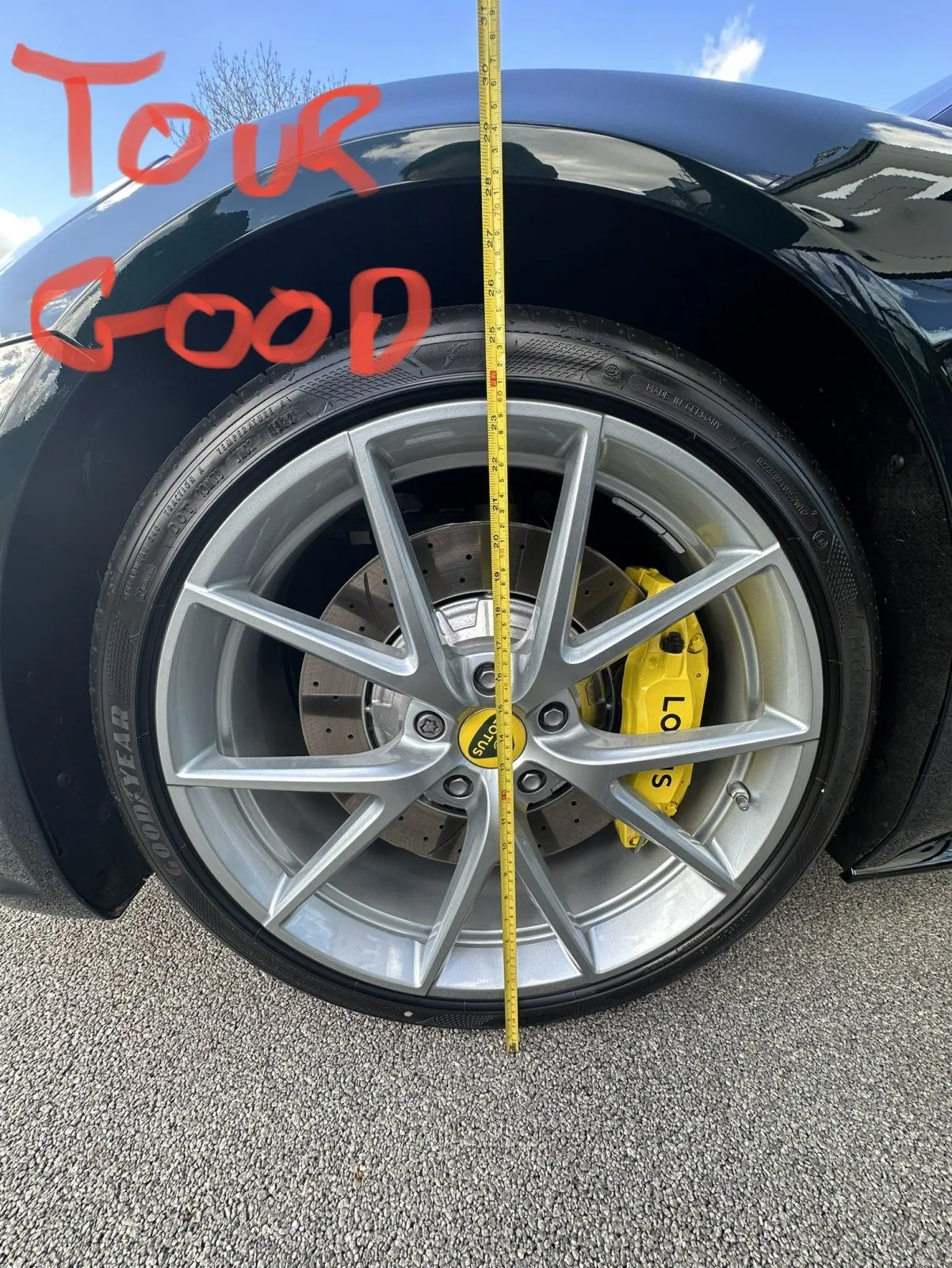

Bit delayed posting this but I asked Scott about ride height when picking up from Hethel last week.
He said he had been assured by Gavin that there was no difference between Sport and Touring.
I took along a tape measure and measured cars that I could get close to. 3 of them I knew the suspension 2 I did not (the Hethel car is an Op on here who picked up the following day). The other DV car also picked up on the 14th.
Obviously I can read the tyre make !
Posted below for those interested. I am not sure it’s a big enough sample size to draw any meaningful conclusions although my car (DV Tour Goodyear) did have a noticeably higher ride height than the two confirmed Sport set ups.
Perhaps other owners with cars can measure ? Through centre of wheel vertically to bottom of wheel arch.
Man these gaps are absolutely huge…
Thanks, useful to have the measurements. But need to re-measure after about 200-500 miles of use when it has settled.
The statement (again) from Gavan is the key thing. But I doubt it’ll be the end of the debate!
