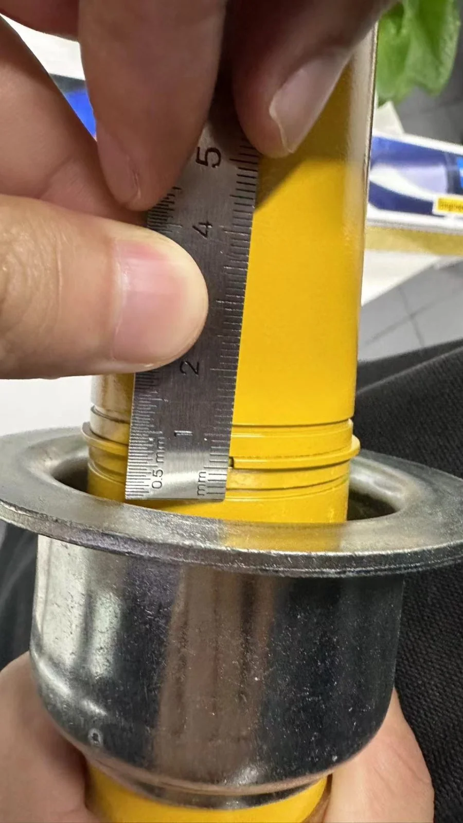

Circlip position will be the same but spring rate for tour is lower. We have done that and compared to sport.
Interesting. Any idea how much the move from top clip position to bottom translates to gap drop to the tire? 1/4 inch...1/2 inch... 3/4 inch?
Should be 12mm per groove

Mine has sport spring at the lowest circlip position while my friend's tour also at the lowest position, his sits lower than mine, something like 1/4 to 1/2 inches.
I don’t think it’s as much as that. If I’m not mistaken there is 10mm between the highest and lowest slots. 10mm on the shock might mean a bit more than 10mm lowering of the car, but I don’t think it’s much more than that. The drop is noticeable, but still pretty subtle.
On my car I’d estimate about 12mm or 1/2 inch. Sport I4, going from highest to lowest slot on the shock.
you are right, sorry, it should be about 6mm per groove, my bad.

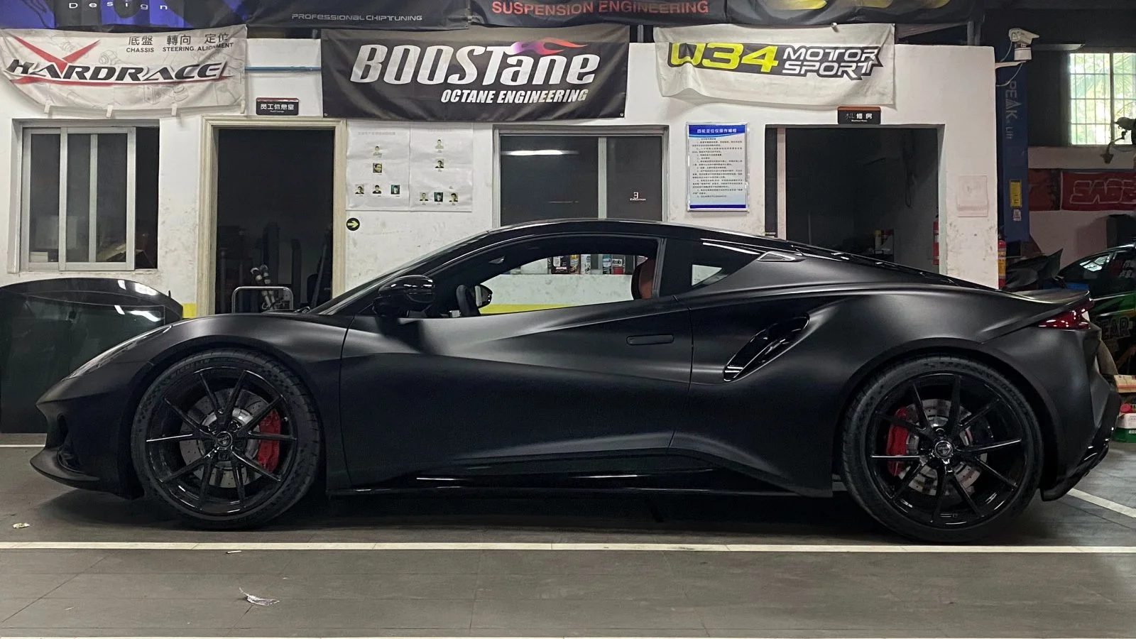

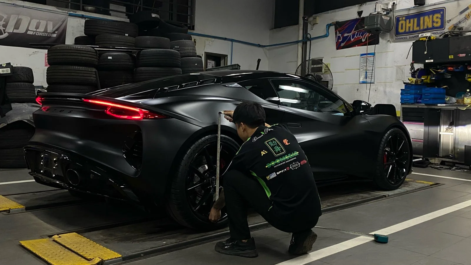

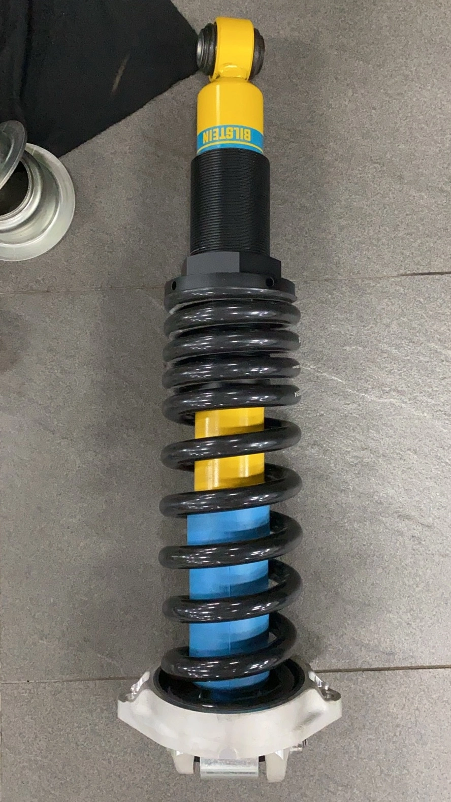

I love everything about my Emira except it sits a little too high for my taste and the suspension is a little bit too jumpy for street use in my case. So for those who are not aware, our blistein shocks come with 3 ride height settings. Mine is a sport suspension which sits at the highest, by moving to the lowest, will give me 10mm lowering.
This is how it looks like with 10mm lowering, which I think it looks much better!

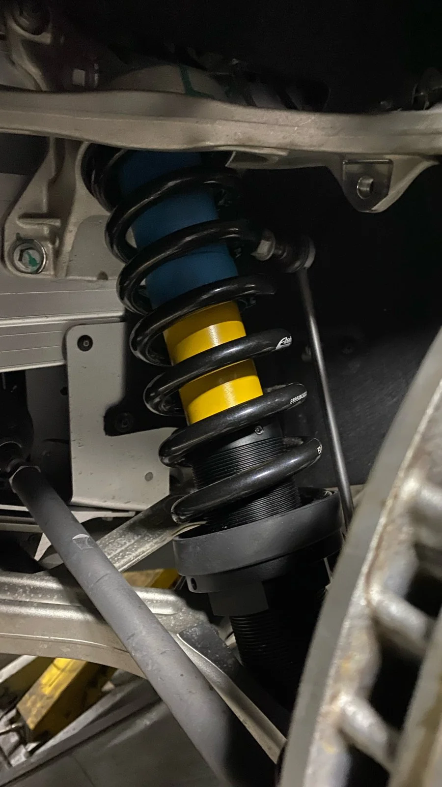

But still I am hoping to just lower slightly more to give that very aggressive look so I ordered the GRP lowering kit. It is able to give me that extra 5mm I am hoping for, and it does the job. Quality is good and very easy to install. Now I am sitting 15mm lowering than stock and I am happy with it. Ride quality is not big of a difference but since the spring rate has been decreased, the ride is a little softer which is perfect for me for street driving, a nice surprise with a smoother ride.
View attachment 52403View attachment 52404
With a 12mm spacer now its perfect, however I wont recommended it if you do track a lot, as cornering is a little soft comparing to the stock setup.
