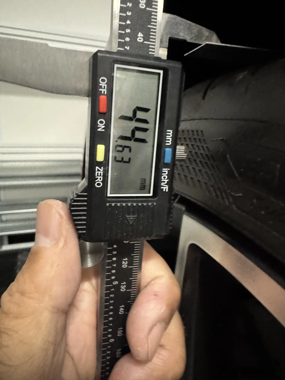

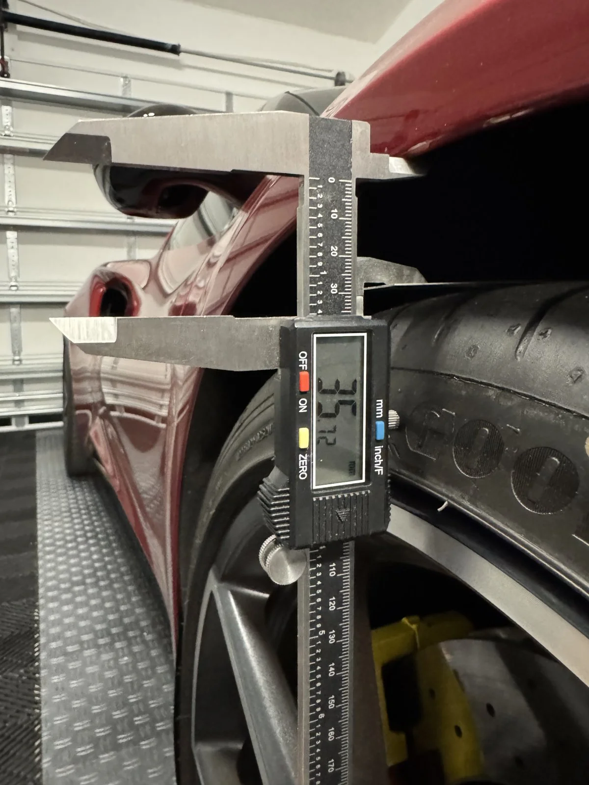

Quite a number of members have posted here having installed the GRP Lowering Sleeves. I decided to order them as well and received them fairly quick. I subsequently spoke to Greg who gave me a few helpful pointers on the coil-over removals and sleeve adjustments, but I'm still undecided as to how many millimeters to drop. I'm inclined to initially go 15mm and see how the arch gap looks.
I understand that the wheel arch/tire gap is a controversial theme with some finding the OEM gaps perfectly fine, but I, along with many others, do find that wide gap to take away from the car's sportiness. I particularly dislike the excessive gap, IMO, in the rear wheel arches where they are even more pronounced. Since I first observed it, my eyes keep constantly being drawn to that rear arch gap. This brings me to my point... in preparation for the sleeves' installment, I began taking some true measurements, the results of which are shown below...
Front Arch
Rear Arch

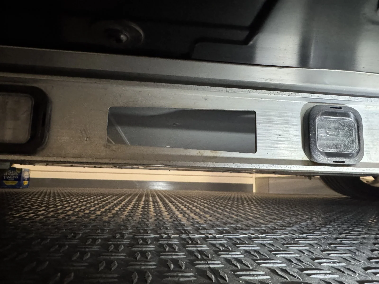

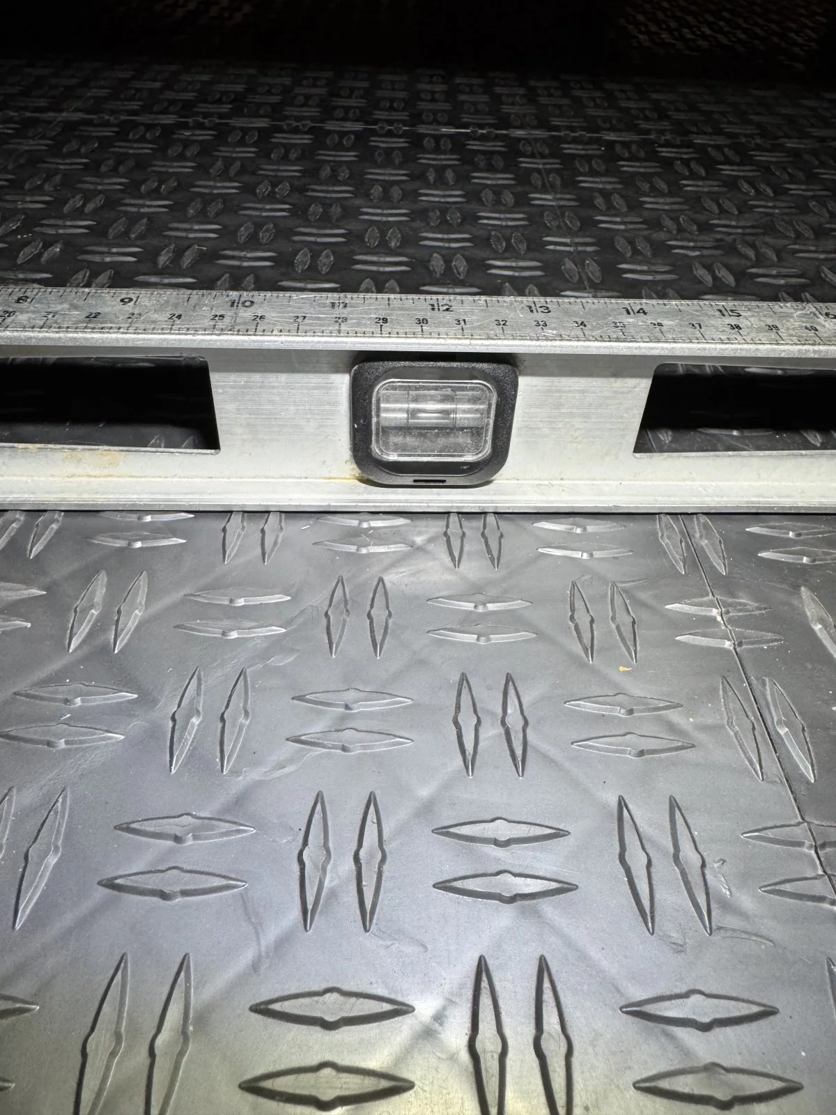

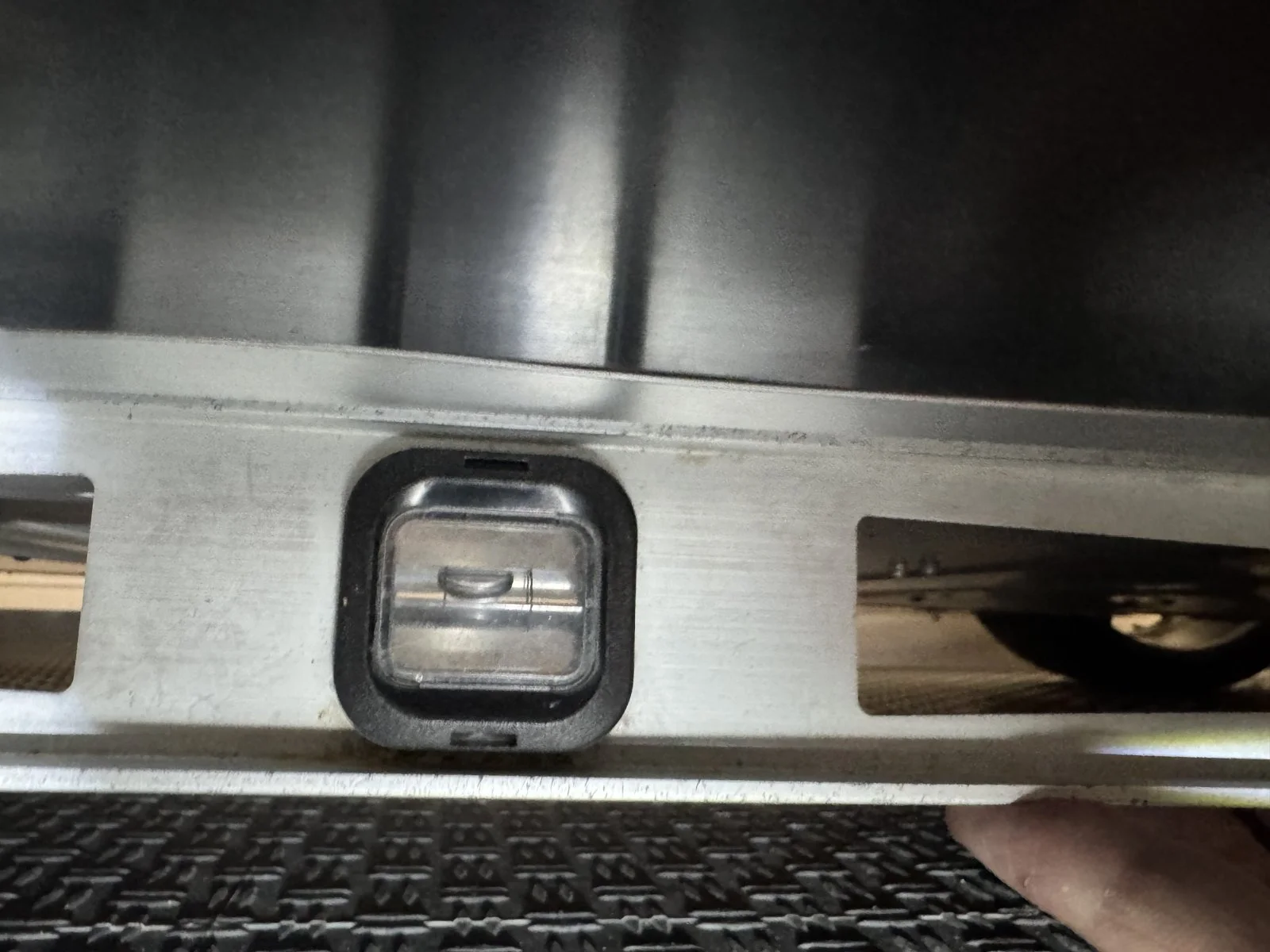

I was intrigued with the difference front-to-rear, so I took a level to the bottom lateral rail by the mid-section under tray. This rail has a perfect unobstructed groove where to place a level. What I discovered was this...
Not level, with a high bias to rear.
Proof that it wasn't the garage floor's fault.
This is to visualize the difference in level. The leveling gap approx. 5mmView attachment 55834

These measurements brought me to the conclusion that the rear wheel arch/tire gap is indeed much greater (9mm) and not a mere visual illusion, and that, in general, the front of the car is lower than the rear.
