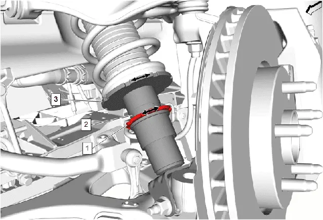

I'm just saying some cars come with adjustable spring height adjustment stock. Base level C8:

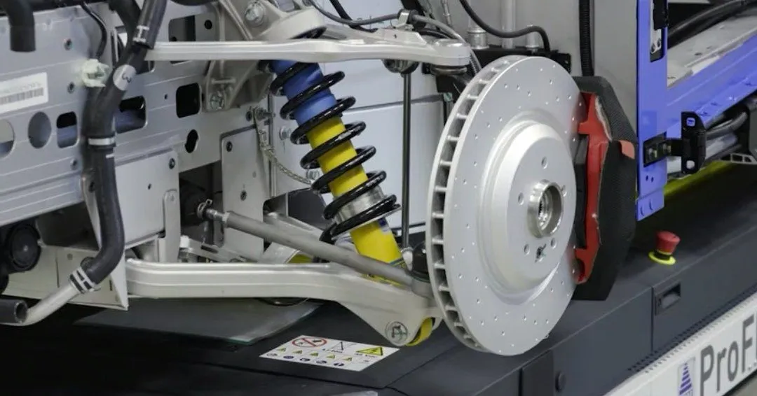

Here's a very early shot of an Emira prototype on the pre-production line being hand-built. This shows what appears to be a linear Eibach spring, likely 2.5" ID or 70mm ID, it's difficult to tell without directly measuring.

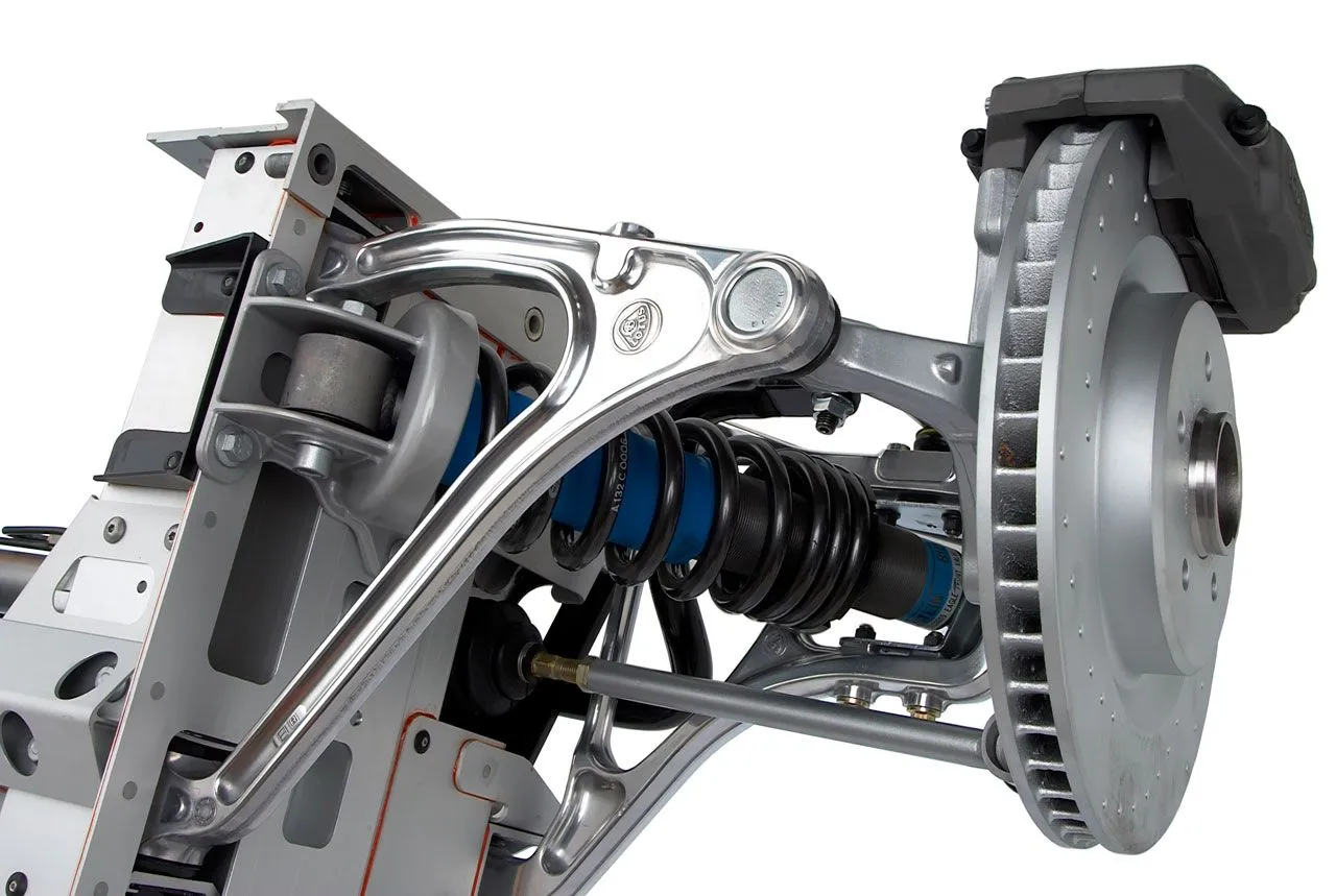

Here's an Evora (non-GT I think?) suspension for comparison... note the progressive (non-linear) spring.

C8 has this, just sayin
