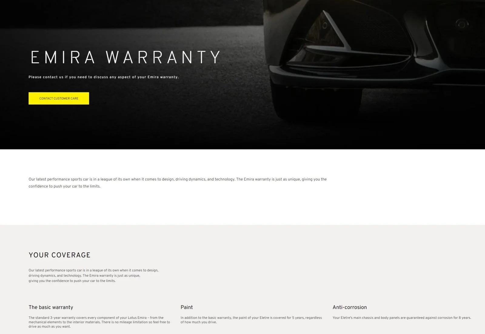

This is my concern. We know now that the paint warranty is 3 years, not five as stated on the website for the last two years. What if you get this problem in the 4th year of ownership? Knowing that Lotus has form for exorbitant parts prices, I could easily two new doors and extensive respray work coming to 10 to 15k.
Has this now been confirmed? Last I read, 1 person said it had been confirmed at 3 years by, another said they’d been told 5 also by CS 🤷🏽‍♂️
I was told by CS recently it was 3 years. I pointed out the discrepancy with the Lotus UK website which has said quite clearly for two years that the paint warranty is 5 for years not 3. They checked with their warranty department and stated that the website is wrong and that the paint warranty is definitely 3 years only. This seems like pretty outrageous backtracking to me, but as far as I am aware none of us were given any kind of document at time of purchase stating the length of the paint warranty, so we are stuck with it. This could become  a very, very expensive issue for owners who get paint blisters after 3 years.
Claim submitted and approved April 9th. Finally in for door replacement today. Fingers crossed for a decent paint match!
It’s still showing as 5 years under the warranty info on their website. You’d think given the issues they are having, they’d have removed it quick sharp if it’s wrong.
I’ve taken a pdf and screen shot and would fancy my chances of fighting it out should the worst happen, but it would be a nightmare I’d rather not have to get involved in.
Given the blistering is caused by an issue with the design of the door, it may be a case of “when, rather than if” on early cars before the door was redesigned. If this is the case, maybe the ones with issues showing inside the warranty period are the “lucky” ones 🤷🏽‍♂️
Given the blistering is caused by an issue with the design of the door, it may be a case of “when, rather than if” one early cars before the door was redesigned. If this is the case, maybe the ones with issues showing inside the warranty period are the “lucky” ones 🤷🏽‍♂️
@Gooner your correct, a number of the Lotus websites in various countries still display the paint as being covered for 5 years. What is consistent with other areas of Lotus quality control is that many refer to the Eletre instead of the Emira......this despite being on pages specifically for Emira warranty information (at least the UK site has Emira).
Unfortunately for the USA it's clear cut that paint/panels are only covered for 3 years per the official warranty guide:
As for the UK, things are a bit more opaque as their official guide does not specifically call out the 3 years and instead provides an email address for owners to confirm their coverage:
Most of the handbooks throughout Europe specifically call out 3 years in a similar fashion to the USA guide. Considering the majority of the Lotus written material lists 3 years, this period seems to be their actual intention. The 5 years listed on various websites is just more of Lotus being Lotus.......

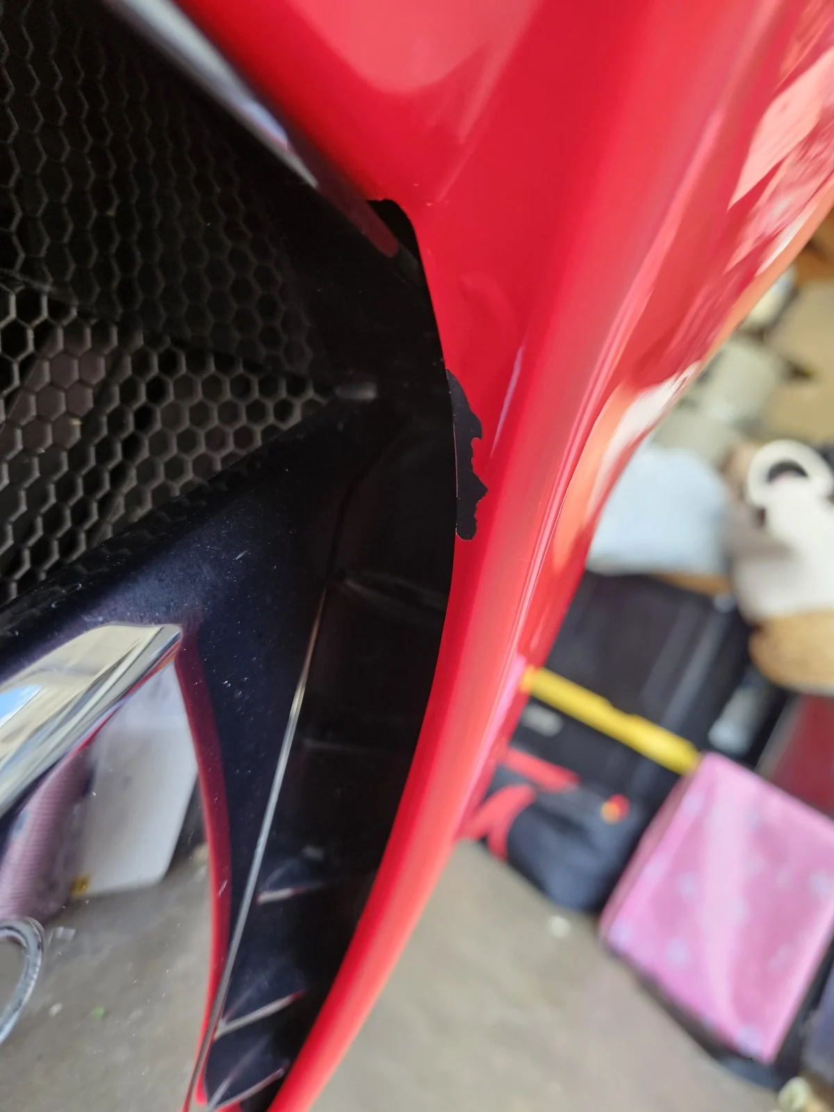

Seems to be going downhill from here for me for my Vivid Red. Just noticed paint peeling and bubbling on driver side bumper inlet. Luckily it's very hard to notice unless you duck down to inspect it.
What's going on here? Kind of hard to see but there is a bubble on top of the peeled paint. I've pressed it and feels like will fall off anytime soon aswell. :(
Welp!
Bumpers aren't grp but ABS, so this is most likely poor paint adhesion. A respray should fix this.
Yup I'm sure it's an easy fix but is this also happening to some Emira or just an unfortunate issue on my end?
I’ve seen various issues with the abs bumpers, some paint bubbling some adhesion issue, not nearly as widespread as the other issues. Think you’re just unlucky friend :(

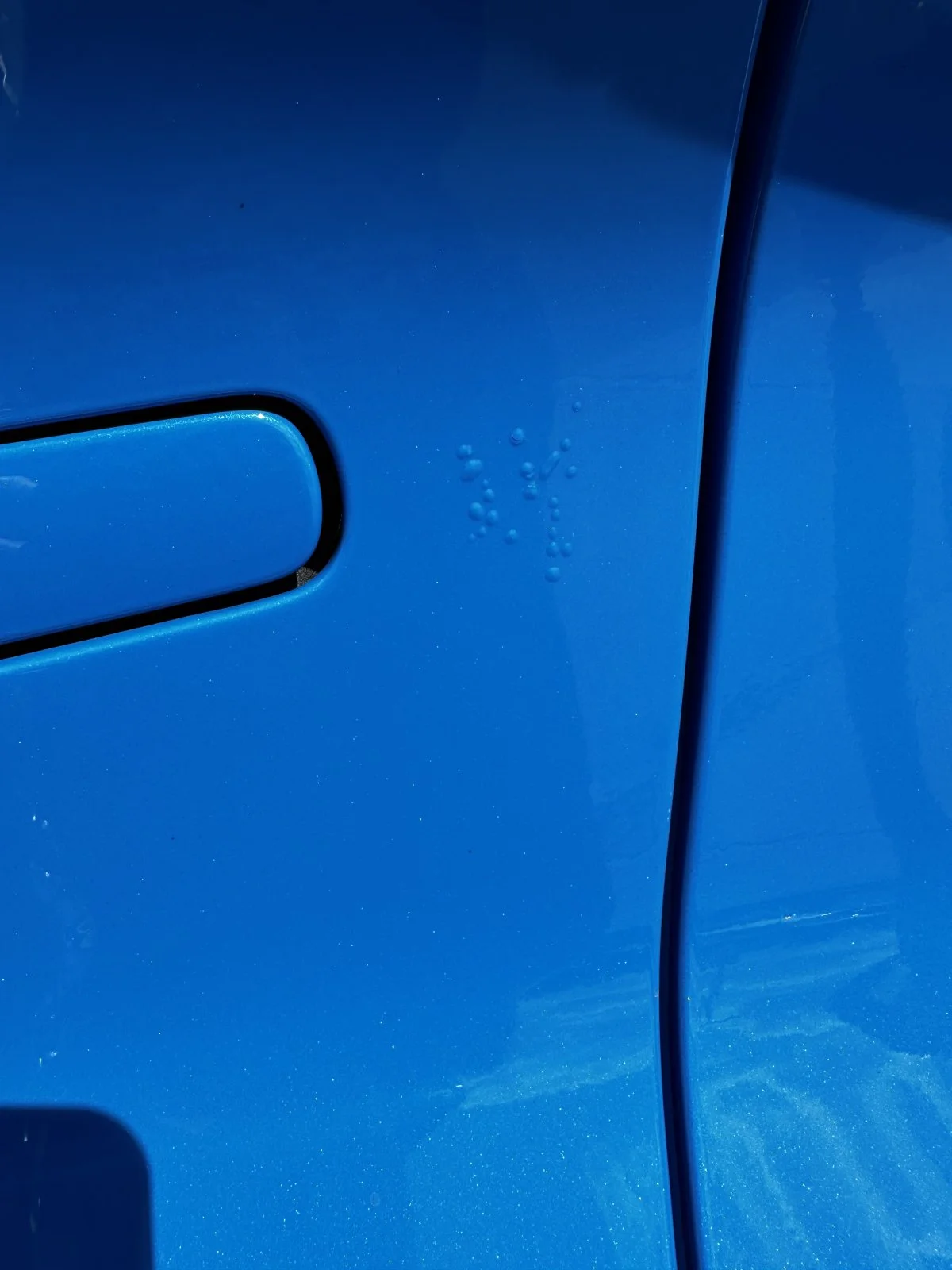

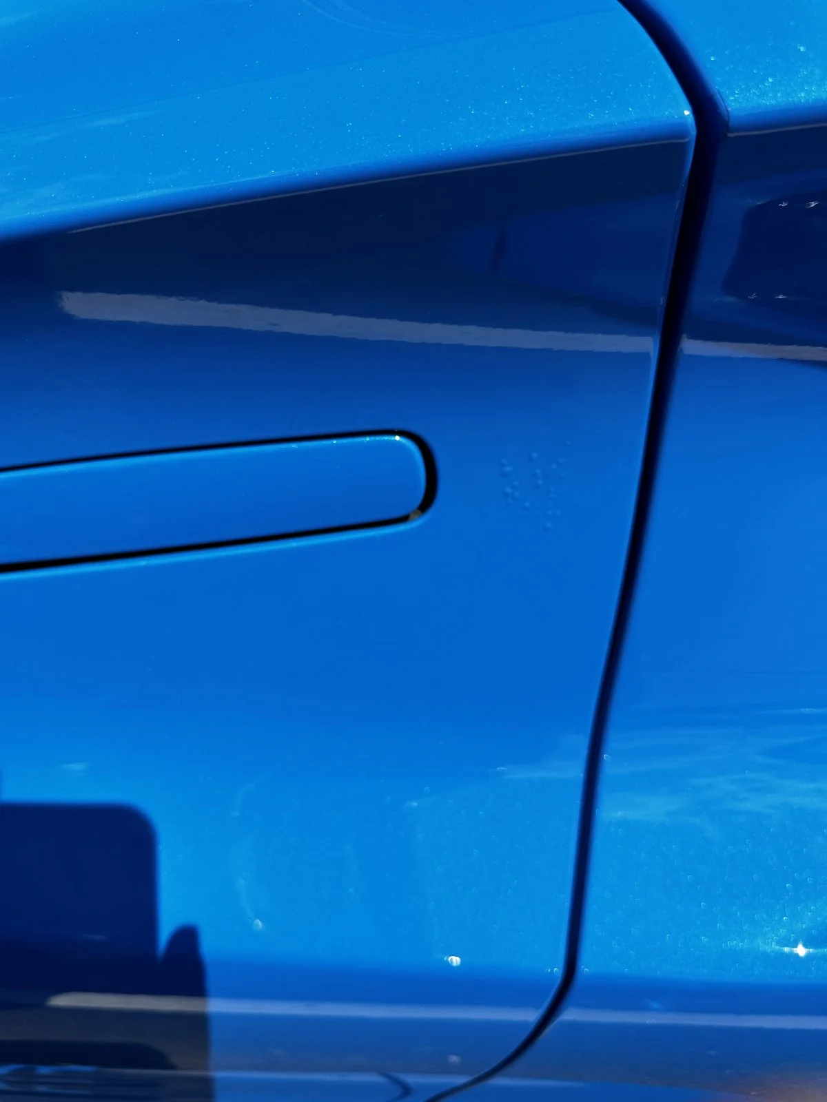

After 1.5 years of ownership I now have the blistering paint on both doors - see attached pics of passenger door, which is far worse.
Build date as per certificate is 10th October 2022!
Car was delivered in Dec 2022, then fully PPF'd, only covered 4081 miles, is always garaged, not used in the wet, last washed 3 weeks ago, which has more than likely delayed the appearance.
Went for a drive in the sunny weather last Wednesday (17th July) - The blistering wasn't there when we set off but was there 5hrs later...
Dealer wanted to see the car. They will replace both doors and cover the cost of the whole PPF to be redone pending Lotus approval.
But, I'm number 39 in the queue at my dealer, so 6+ month wait, plus I'll lose the use of the car again for a while, plus my time and fuel driving it back and forth...
Pissed off is an understatement :mad:
