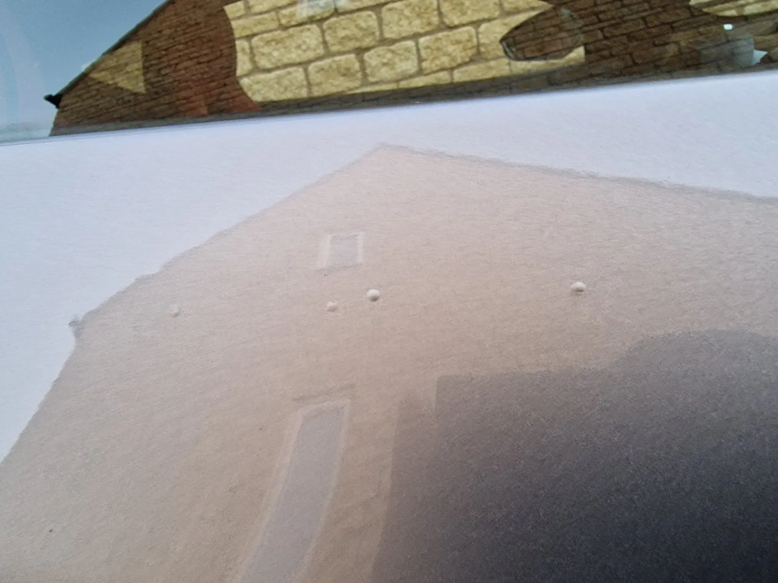

Thanks to this thread I checked yesterday and under the driver door window there is blistering/bubbling under the paint!
My concern is.... putting on a fresh new door with a metallic colour like nimbus grey via warranty.
How is it possible to check the manufacturing date ?
Should have a Sticker on the Drivers Door Inner Sill that contains Vehicle information..... At least in the US all cars have this Sticker, not sure about other locations.....

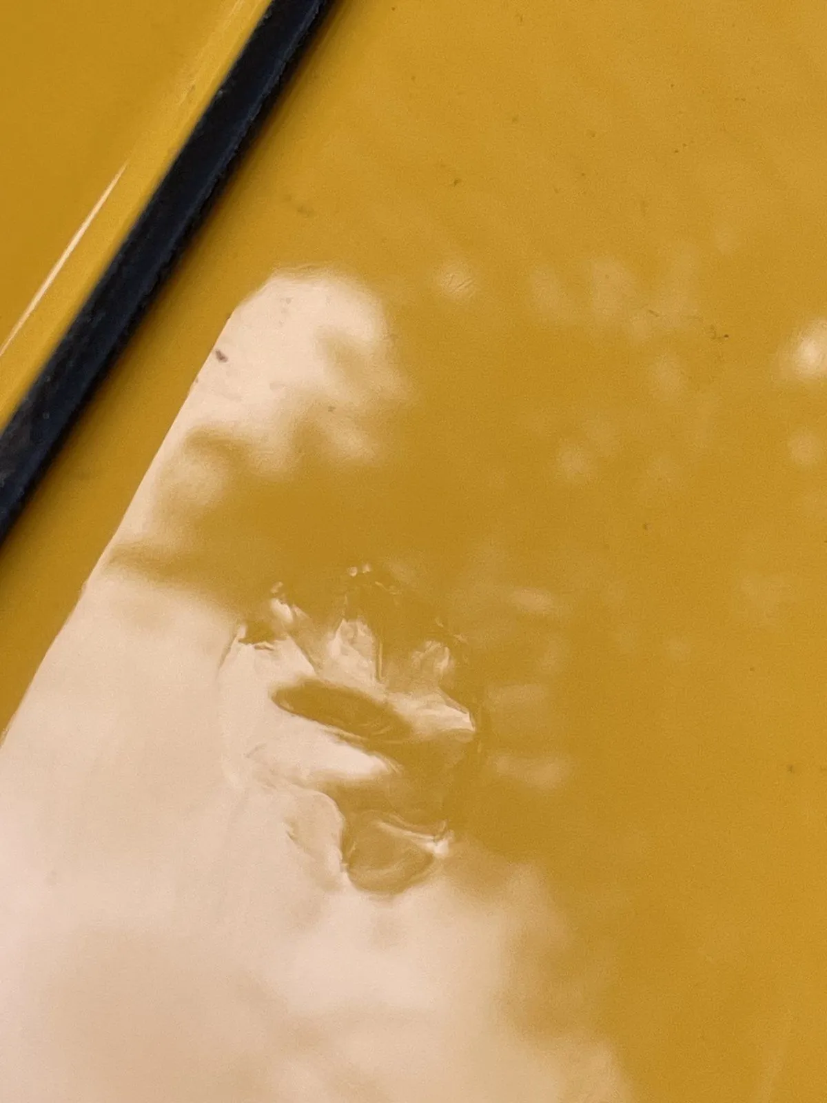

Had this strange paint anomaly appear on my nose cone near the Lotus badge , it appears to be coming up through the paint. Anyone else had similar issues ?
Thoughts appreciated
Sure looks like it.
Anyone know if the nose cone is also made of TCA Ultra Lite or just PC/ABS plastic?
HI Emira LV, limited paint bubbling appears to have impacted a number of cars. A few have had similar issues on the top of the doors just below the window line.
Mine has it on the passenger side door (RHD version).
My local dealer is waiting on Lotus UK to confirm the fix but thus far the dealer has not provided any feedback.
I have full protective PPF and at first thought it was the PPF bubbling.
