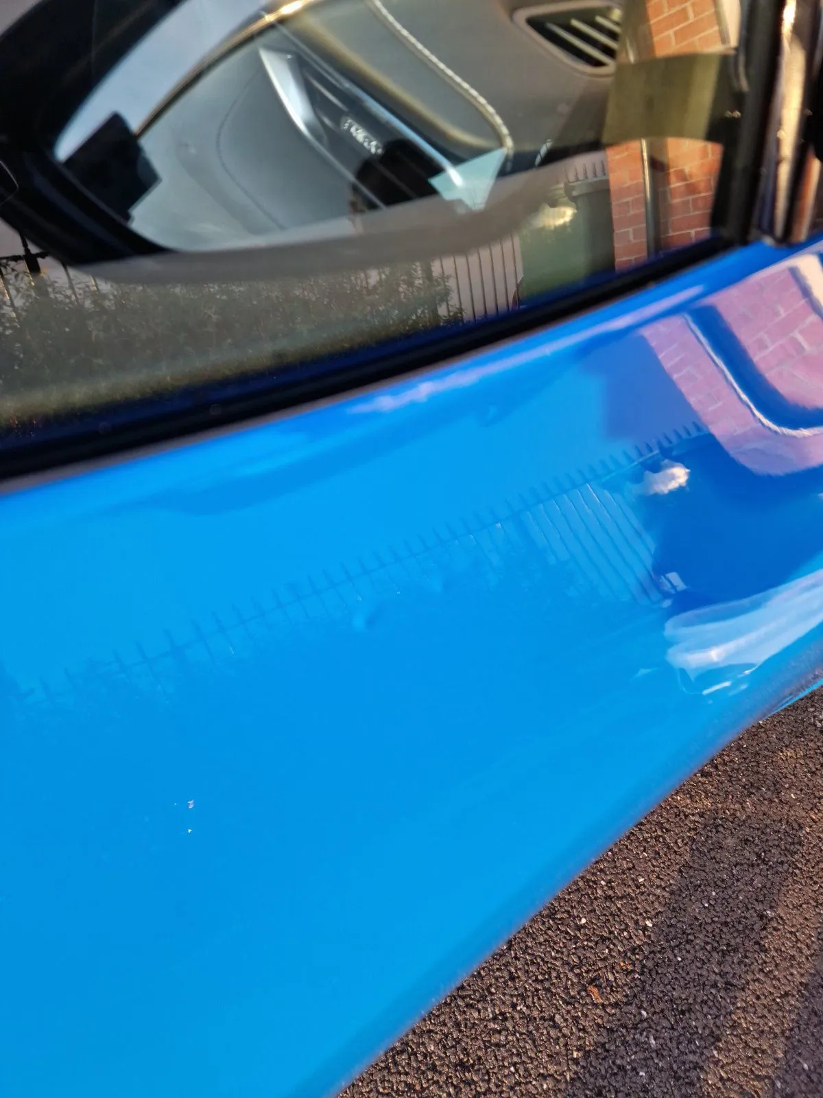

I spoke too soon with mine. Cleaned the car yesterday and noticed blistering on the drivers door

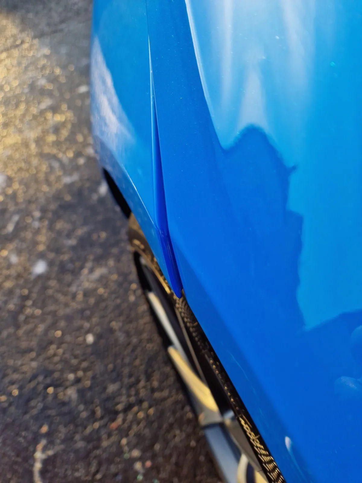

I also noticed the rear bumper is out of alignment
They're picking up a week tomorrow to look at the aircon issues so I'm just going to compile a snagging list and then start the arguments between Lotus dealer and Lotus HQ....
I spoke too soon with mine. Cleaned the car yesterday and noticed blistering on the drivers door View attachment 33749
I also noticed the rear bumper is out of alignmentView attachment 33750
Good luck and you will need plenty of patience. I had the same on both doors and the rear bumper being out of alignment (but not as bad as yours). For the Lotus diehards, It doesn’t really hit hard until it happens to you. It’s pretty upsetting spending all that money with so many issues.
I’m certain, it will happen on the other door too so you might want to wait or fix one of them at a time.
I'm wishing you the best.
