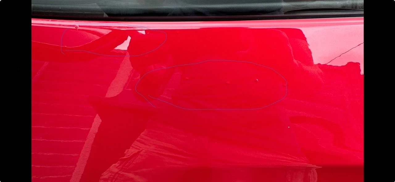

Hi, I now have the same blistering problem, mine was April 23 build.
Booked in for the works to be done at my local dealer in a few weeks.
This is really souring what should be a great car experience

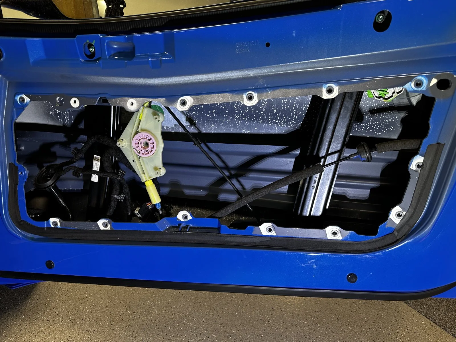

My cars' build date is 10th Oct 2022. There is a single drain right at the front of the doors (you'll see this during / after hosing off the car where water can be seen dripping onto the black door seals at the very front).
Also I have the white “Substance” on the backside of the door panels / skins…..which obviously didn’t work ;)
Yeah When I was washing the car I saw water is coming off in the front of the door I mean like you said I saw water dripping on front lower black pack
