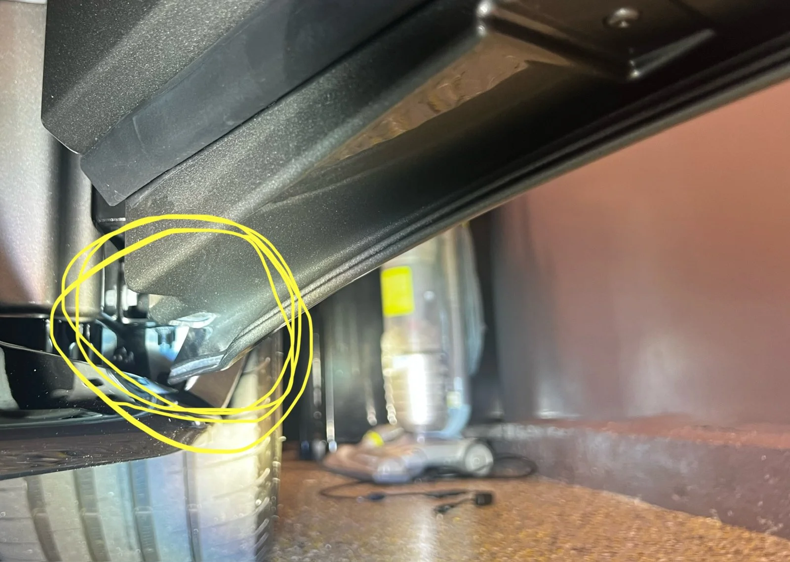

Is this the drain hole? I saw this at the bottom of my door towards the hinge. Does this mean I have the newer door?

Not sure until I see the new ones. I’d imagine there is some form of drainage on the original one buts it’s improved on all the newer ones.
@Rupes - I’m sure this won’t happen again after the fix. They said all the doors been fitted to the new cars have the correct drainage and are resin sealed on the inside so they can’t become porous.

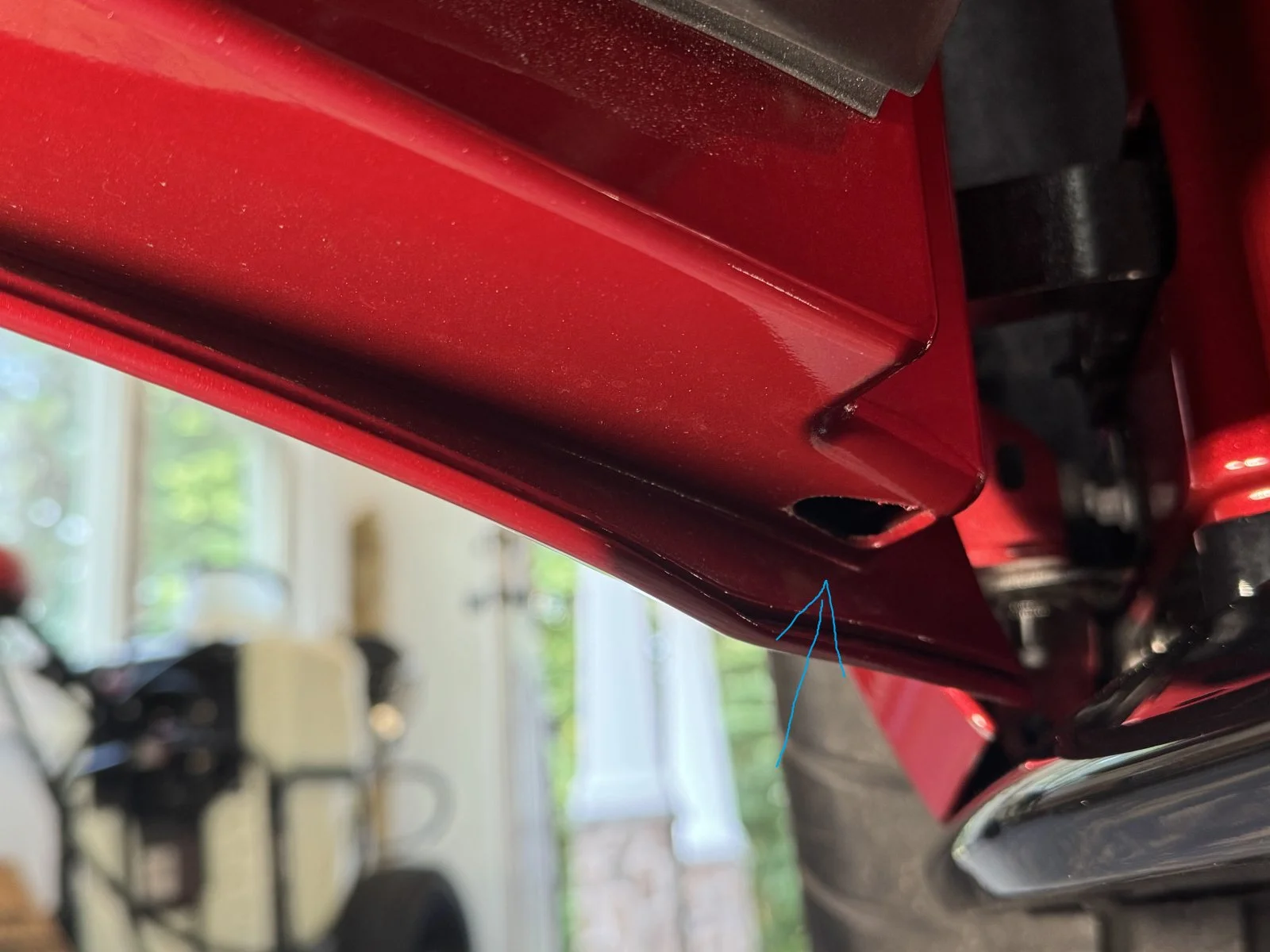

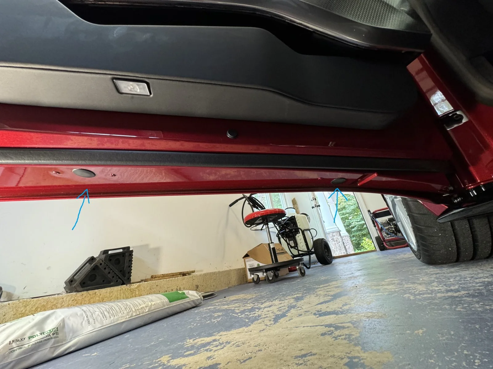

After looking through some of the previous pics I wanted to see what drain holes were on my Emira. My Emira was an April 24' build. In the first pic i have the drain hole all the way towards the front of the door. I have noticed water dripping from that area after a wash (guess that means it is doing it's job). In the second pic there are two other holes that have been plugged with rubber stoppers. Once it gets a bit cooler out or this weekend I will take a scope up into the door to see if I can see any coating.
I think the front drain hole is present on all vehicles regardless of manufacturer date.
