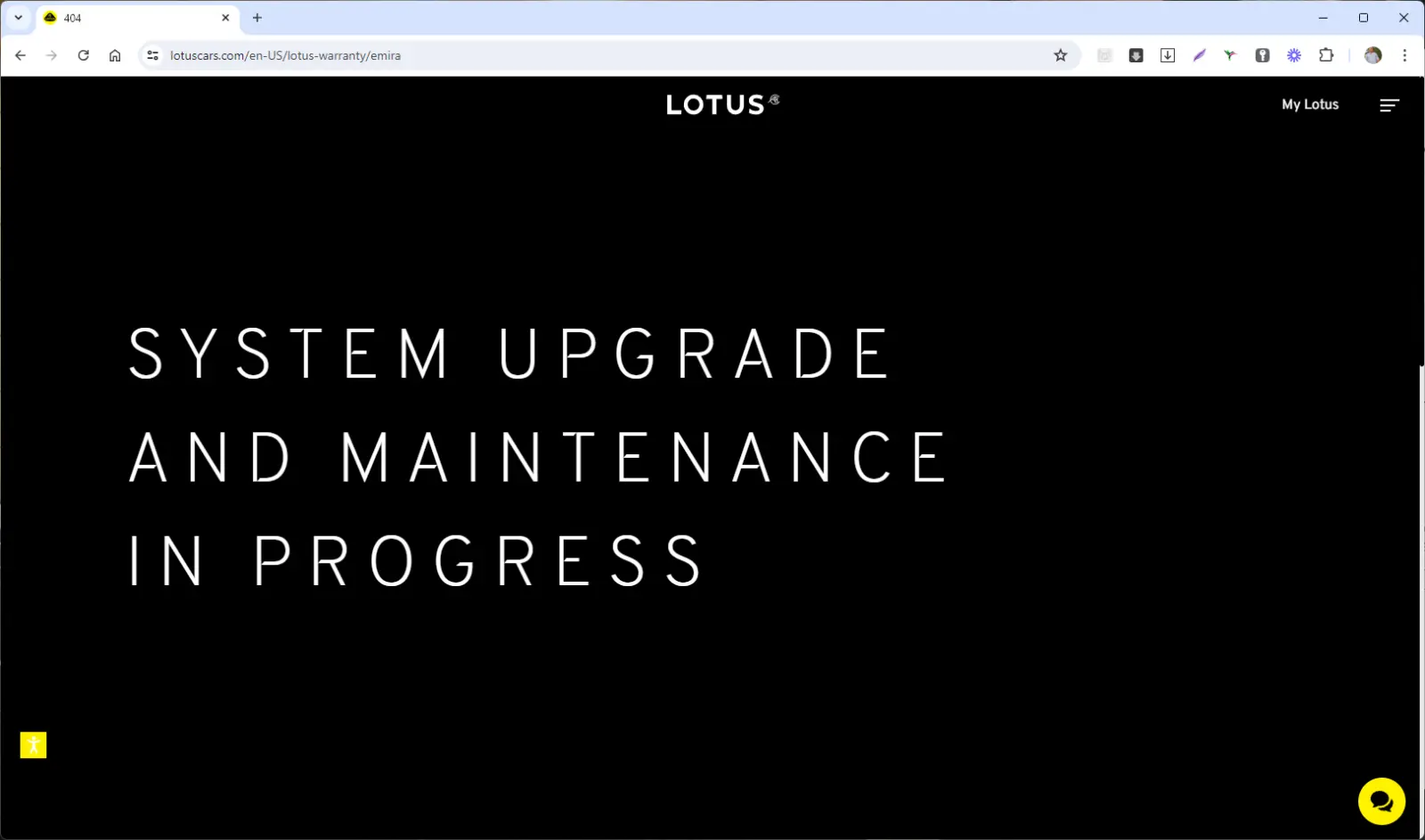

US Page : https://www.lotuscars.com/en-US/lotus-warranty/emira :oops:

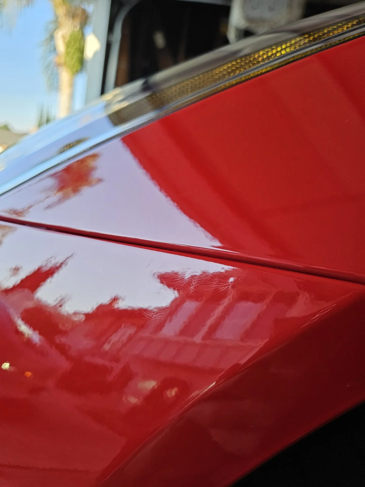

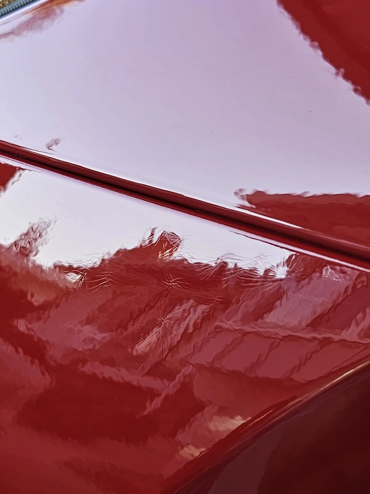

My Vivid Red vin#1253 has a paint blisters now showing at front left bumper. My car arrived at the port 04/20 and picked up at Boardwalk lotus a month ago. Dropped off the car to Galpin earlier this week for Fuel sensor issue and when I got it back to inspect it, I found new blisters or cracks. These cracks were not present on Monday during dropoff and today just showed up during my inspection. Also showed advisor before driving off to document the issue.
Any suggestions how to move forward? Should I have them replace with whole new front bumper or repaint? 😭

I am not a paint expert, but that that does not look like paint blistering to me.
It looks like it if from panel stress from being hit/pushed by something.
agree, it looks different to the "normal" paint blistering seen on other Emiras
I surely hope this is not from service tech doing. Did find it odd that 30miles was added to my car when I picked it up. Can't really think the need to be driven so far just to check why my fuel gauge is stuck at 1/3... unless a mandatory test? Who knows..don't want to think about it that way. Might make my blood boil.
It doesn't seem to appear like an external damage. I tried pushing it in that part of bumper and won't budge. That part of bumper is hard And had no play.. Hard to see but at the center of each cracks is a bubble. Like something is pushing it out. There's about 4 of them but hard to see
Fuel gauge issue might have to drive the car to see how it reacts.
Agreed. My understanding is the troublesome panels with this car were made by the same manufacturer, and that manufacturer does not make the front bumper.
I’m sure someone here with more experience on this subject can confirm.
This is correct. The panels that have been an issue thus far are made by Teijin Automotive Technologies and they only make the doors, rear quarters and the inner, outter and lower shells of the tailgate.
All the info so far indicates that the panels are the issue, not the paint. This therefore could be a separate (and unfortunate) issue. It also looks very different given the presence of cracks in the paint that I’ve not seen on any other examples of paint blistering.
