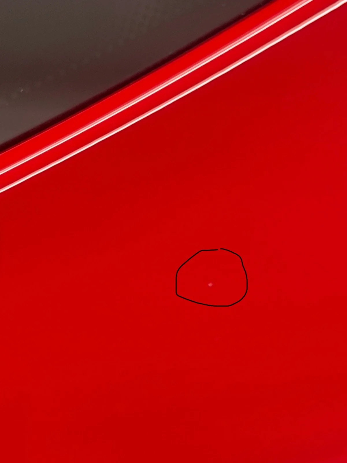

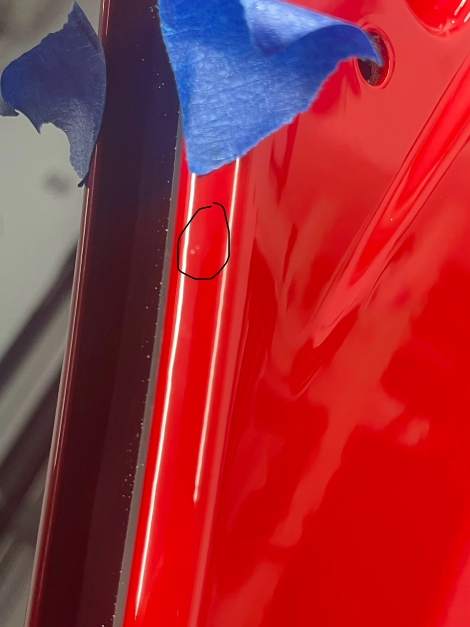

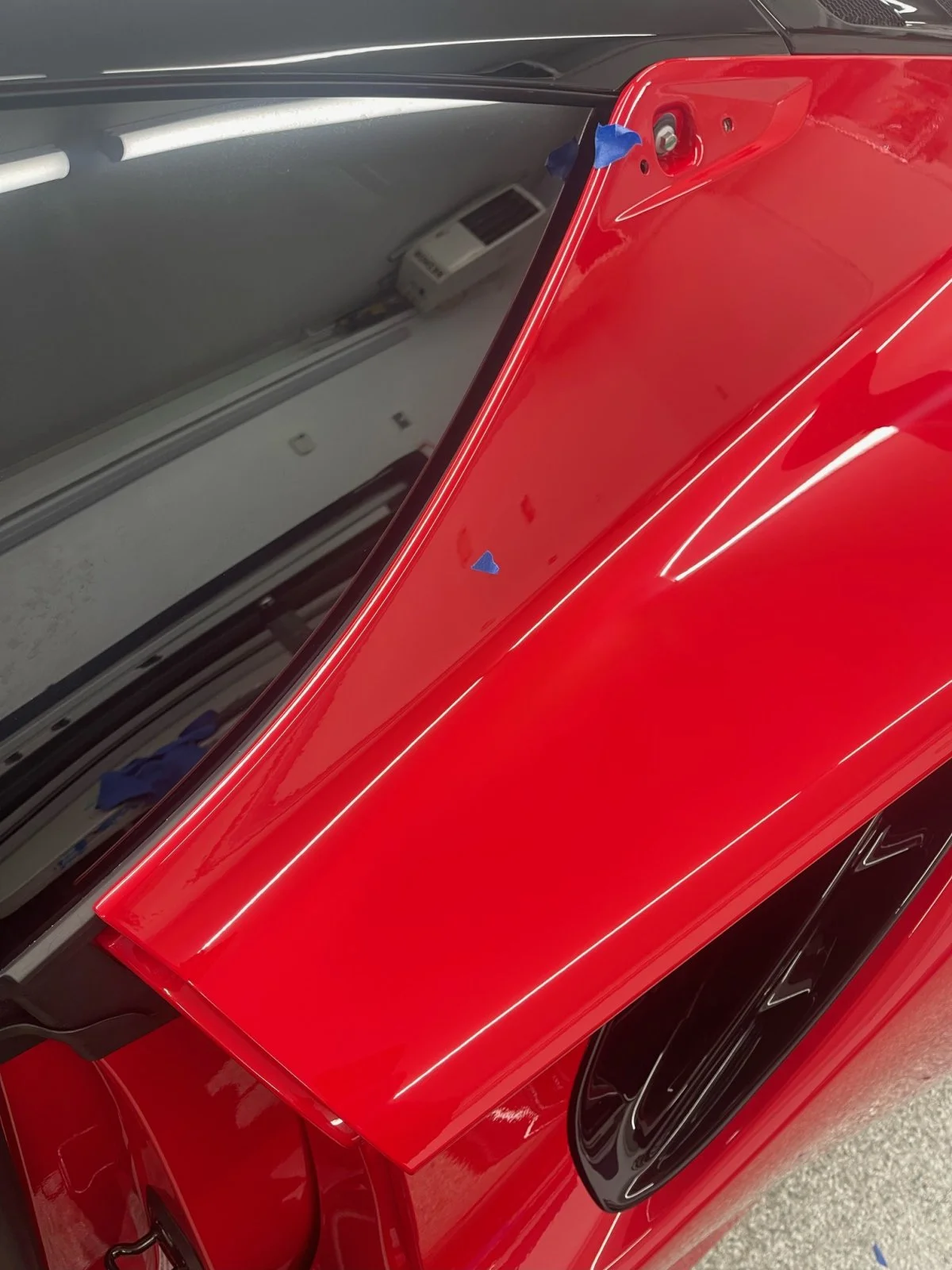

So PPF place just called to say they found what appears to be 2 little bubbles on the driver side quarter panel. They at first thought it was something with the PPF they had just applied and so removed the PPF only to discover these babies. I'm stuck at work today, but will be heading out first thing tomorrow morning to inspect for myself.
Isn’t it strange to see that on a new car?
Guessing the bubbles didn't appear during initial inspection / paint correction process prior to PPF install?
I'm so baffled at this point, I was there on Monday morning due to paint bubbling/crumbling on the rear bumper (posted earlier in this thread #268 and #277) and did not notice these. The installer swears that they did not see them during multiple inspections or during the pre-PPF prep process......implying that they popped up. I'll post more detailed pics after I visit in person tomorrow.
I don't believe the rear bumper and quarter panel are even the same underlying material.......this is so amazingly frustrating.
That sucks, sorry to hear it. And your car is another example that proves this issue isn't limited to the doors.

So some good news for most you on this thread. I've now checked this out in person and I don't believe these little bumps are the blistering issue. The bumps are so tiny that my 47 year old eyes had quite the time even seeing them. They are so slight, roughly the size of a grain of salt, that I'm thinking they were there all along and did not pop up afterwards. The bumps only became visible due to the PPF having a sort of tent effect over these tiny raised grains. If this was a 10 year old Chevy I would have done a quick wet-sand to get them down......

Micro blisters magnified by the PPF? They look like tiny pinholes before bigger blisters appear.
That's how mine started, then a white substance, presumably part of the resin, started to appear.

I wouldn't describe what I saw as "pinholes".....more like a red grain of salt stuck to the surface. They were so miniscule that I couldn't even photograph them with the PPF removed. I just went back through this entire thread and can say that what is on my car does not match any of the pics posted of the blistering. Maybe it's a case of wishful thinking on my part, but based on my eyes I'm currently believing this is not the same issue. I get the car back late Monday and I plan on driving it plenty........I'll keep everyone posted if things remain static or progress for the worse.
Obviously I'm super frustrated that I have a paint bubble crumbling/peeling away near my taillight and now the added stress of this BS on the quarter panel. All I know at this point is that I'm going to drive the shit out of my car, blistering or not!
It sounds more like some minor contamination of the paint at the factory. Frustrating but much better than paint blisters from moisture!
