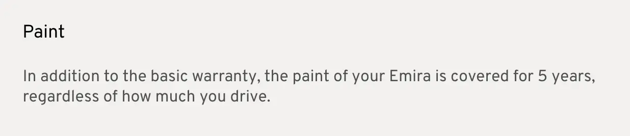

Quick update on this. Lotus CS have just told me the paint warranty is 3 years, not 5. The extended warranty specifically excludes paint, so if anyone gets the blisters after 3 years you are on your own facing big bills.

Very surprised by this. The website clearly states it's 5 years.
Detail can be found here - https://www.lotuscars.com/en-GB/lotus-warranty/emira
Below is a screen print from the above link (which is the GB site). Would be great to get a definitive on this as 3 years for the paint given the issues we are seeing would be enough to put me off a purchase (although clearly too late for me now :ROFLMAO:)!

I have replied to CS pointing out the discrepancy between their response and what is explicitly stated on the website. Will update when I get a reply.
I thought I read that the 5 year warranty only applies in the UK. The U.S. market only has the 3 year warranty on paint.

I queried this with CS and they have told me definitively that according to their warranty department the paint warranty is 3 years, not 5, and that the website is wrong.
So what do you think? A genuine mistake on the website? Or some serious backtracking given the number of cars with paint blisters and the escalating warranty costs? :unsure:

A lawyer would have a field day with this. It's in plain English on their website and has been for a couple of years. They can't suddenly claim it was a typo.
Paint
In addition to the basic warranty, the paint of your Emira is covered for 5 years, regardless of how much you drive.

Plus we have the confirmation from a dealer as per Speedys post. Feels like they don’t really know 😂
Either way, I’ve taken screenshots of the website and will save them down in case a “discussion” is needed in future!
