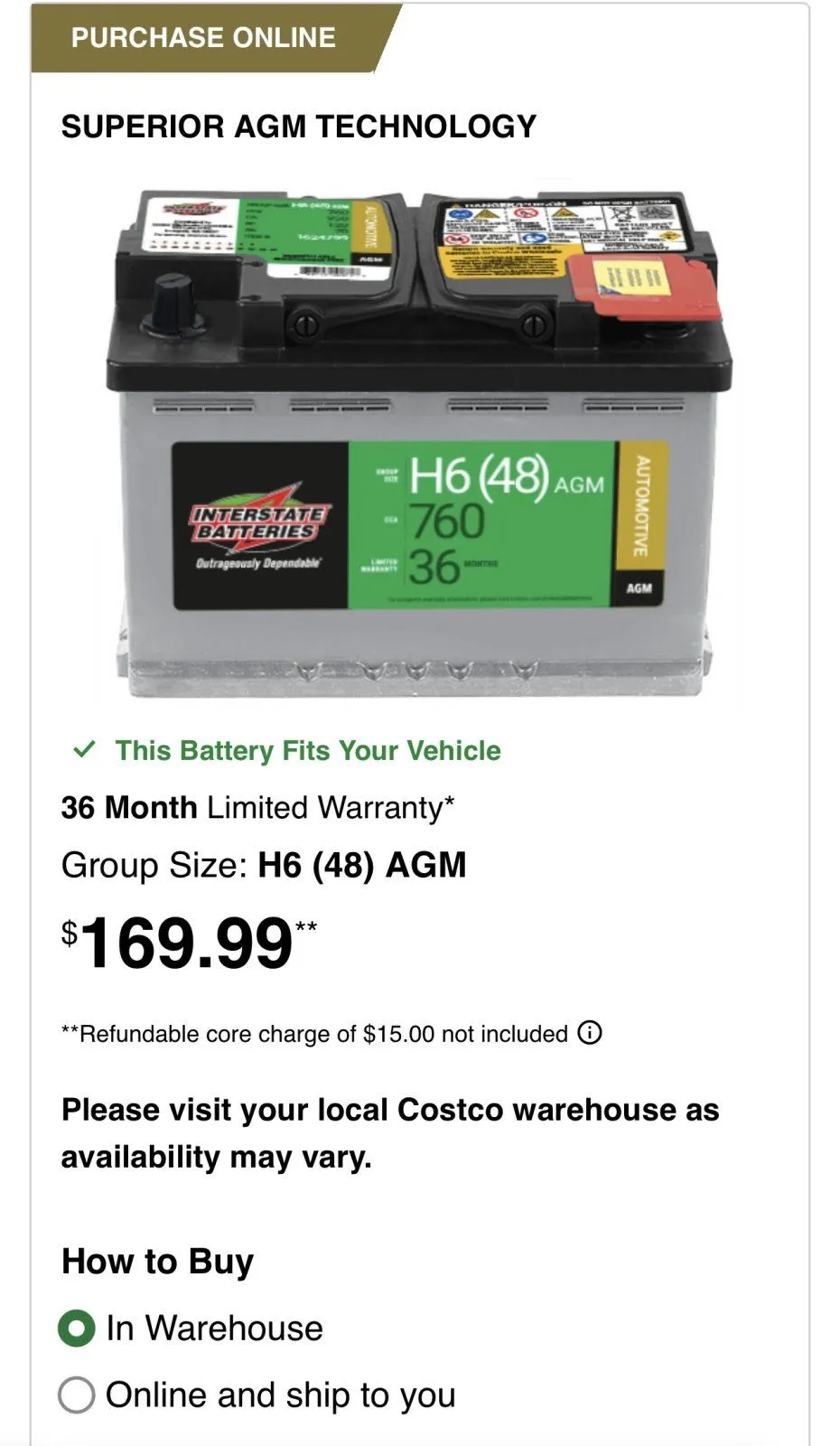

The Emira in our garage won’t be winning races with a lightweight car battery that shaves a few pounds from the trunk…
I hate Costco, but…
A few hundred bucks more for a 10 year battery that fixes electrical gremlins, lowers risk of being stranded, and also removes 31 lbs from a rear weight biased car is well worth it to me. I already have mine, just waiting on the car to arrive.
Fair points indeed

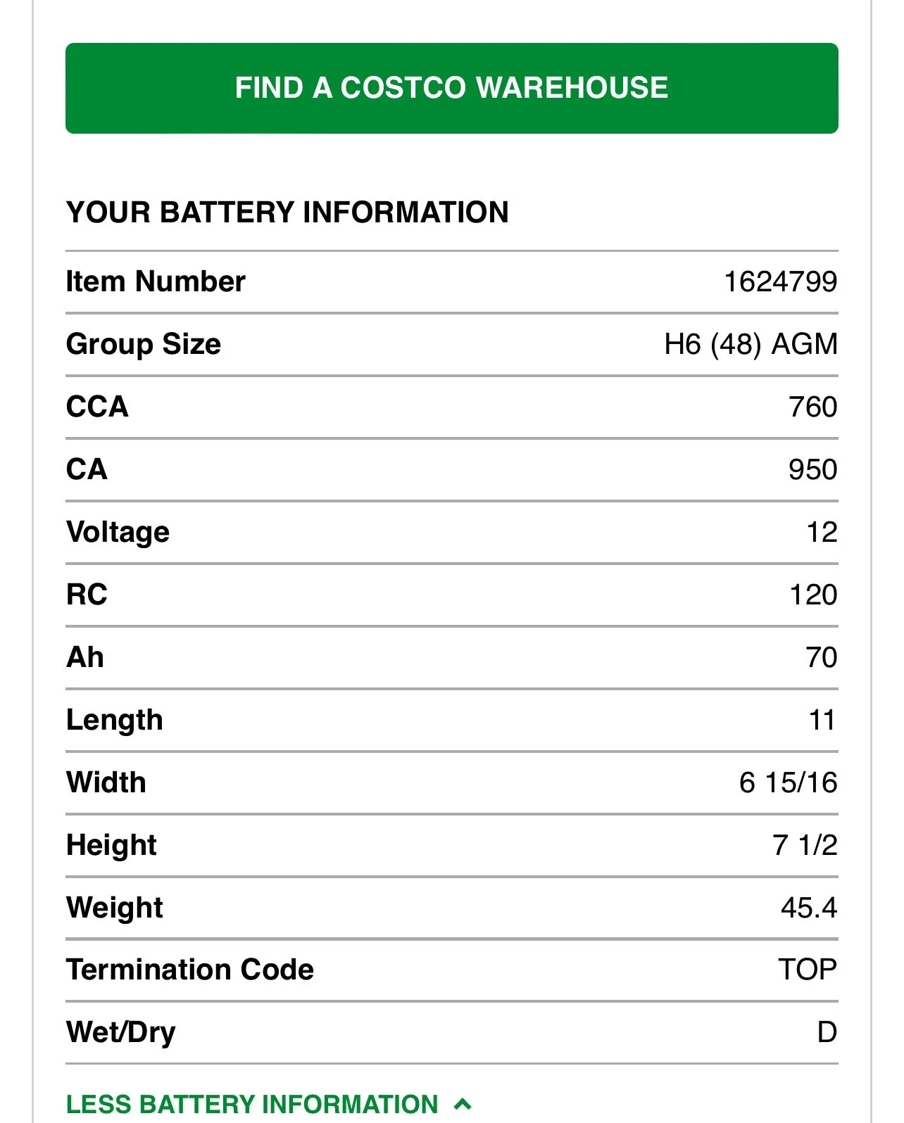

What's the correct battery size for the Emira?
I'm assuming it's an AGM battery?

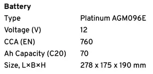

Stock battery is H6 size, 70Ah AGM.
From the handbook:

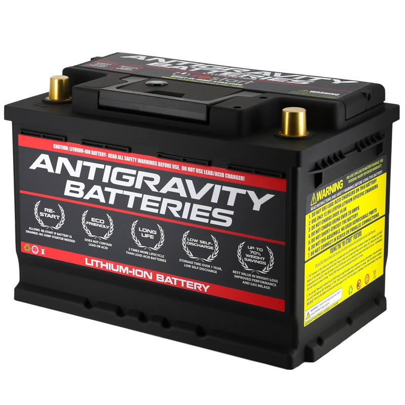

A lithium equivalent capacity would be ~35Ah due to the difference in discharge curves. So the 40Ah battery GRP sells would provide more usable capacity than stock, double the cranking amps, and be about 70% lighter for those interested. The "re-start" function is huge for me. If the battery becomes fully depleted, it still saves enough in reserves for 1-3 engine starts, theoretically keeping you from ever needing a jump. Good insurance for me who plans to run a dash cam with parking mode.
