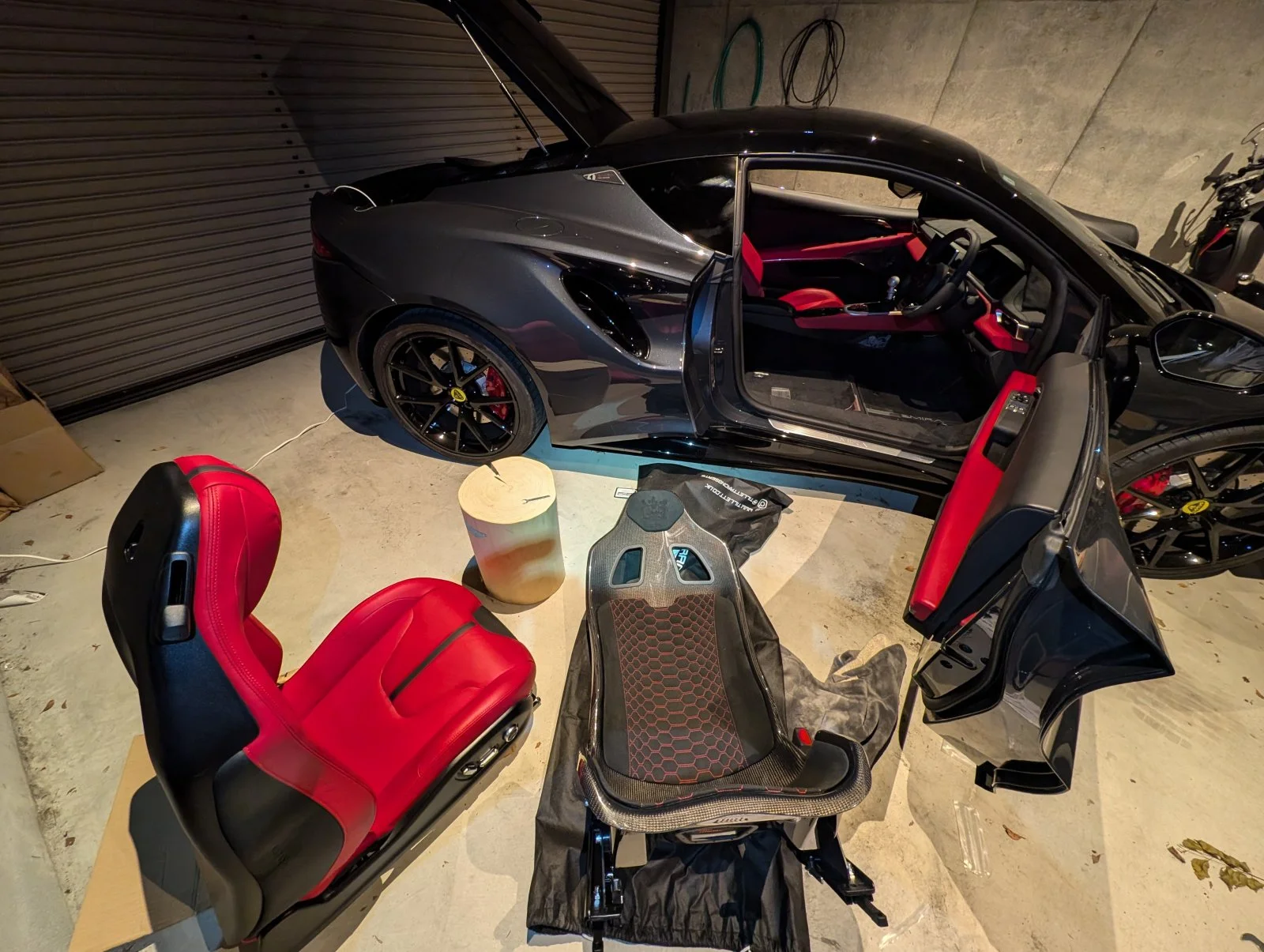

Received a pair of seats today, and my first impression is.... Can't wait to put them on but can't, as only one runner set is included. Let's hope they'll resolve this soon enough.

Update: They found where the runner was hiding and it's on the way to me now. Pretty impressive customer service I must say.

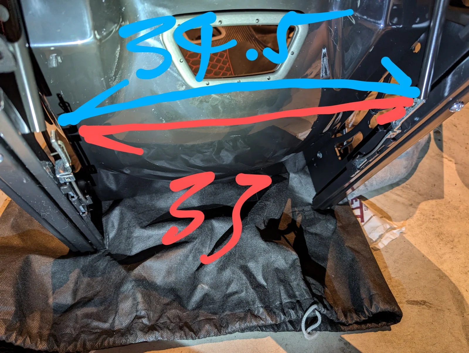

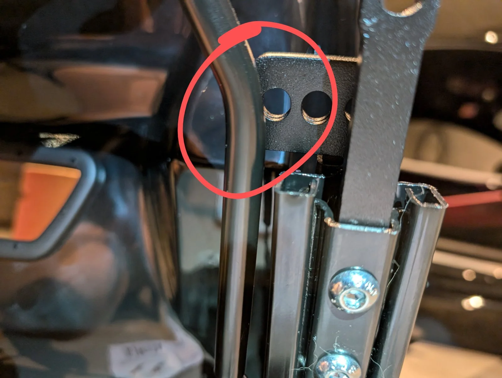

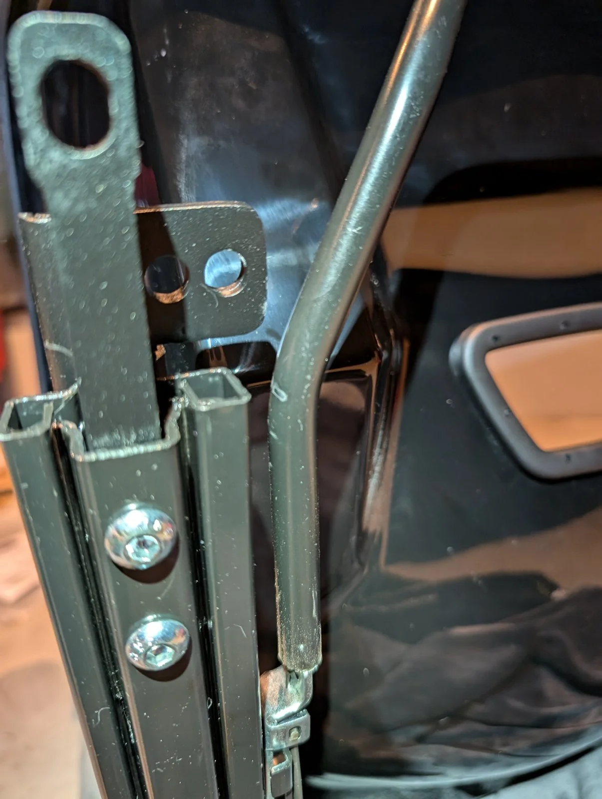

Installation log: Stuck. Just when I thought I was 99% done, I realized that I couldn't engage the cross bar to adjust the seat position. Apparently the cross bar seems to be too big and interferes with part of the bracket.
View attachment 53257View attachment 53259View attachment 53260
That should work. It’s close but I’ve not had any problems yet. It might be the handle bend.

Yes, but my cross bar is wider (or the bracket narrower) than yours. I ended up cutting 1.5 cm off the ends of the cross bar to make it work.
You can see the scratch from before the cut.
