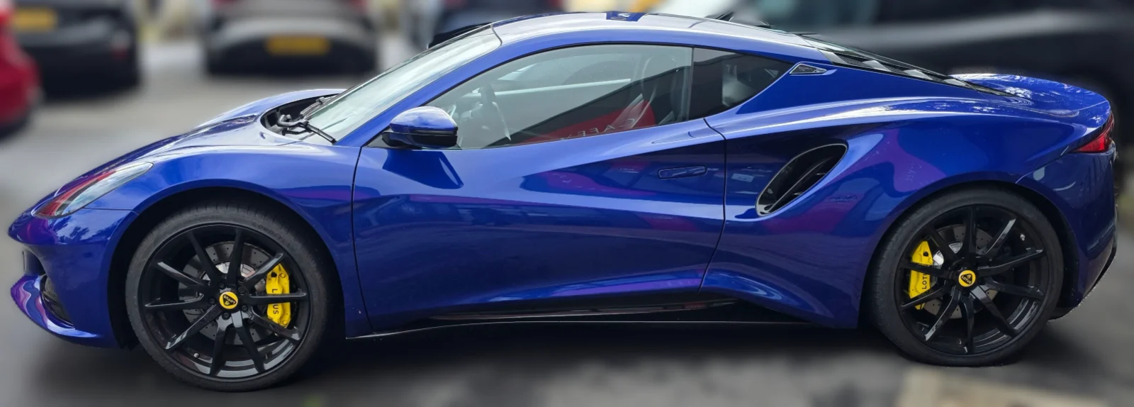

Deposit Paid - on nearly New (400 miles on the clock) Atlantis Blue V6 Touring (will probably get the Nitron's ordered) but most certainly ordering some Tillets! Steve very kindly let me sit in his (before I went to the dealership)
Congratulations and welcome! Bet those first 600 miles are going to be tough keeping revs under 4000 or whatever the run in guidance is!
Got it! Now at 500 miles :)
Took the long non motorway route home. I need to learn how to use Android Auto and waze better the screen is too cramped i beleive there is a way to make waze full screen. However did not bother me too much I enjoyed the drive more!
