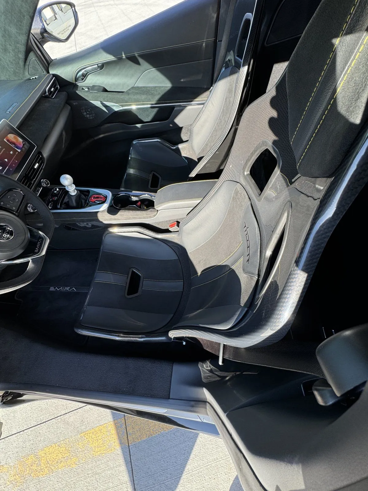

Just finished the install on the B10XL seats in our shop car and the results are beyond expectations!
The seat position is 10x better, especially if you are taller. You can actually get the seat bottom down where your line of sight is right in the middle of the windshield. No more slouching! There is plenty of adjustment for all heights though, you can get as much or little recline as you want also.
The belts and hardware all match up perfectly to make it a direct bolt in type kit. No extra hardware needed.
We are still working on addressing the airbag light. Hoping to offer a plug in solution that eliminates the airbag light and the seat belt warning for the drivers side. More to come on that soon.

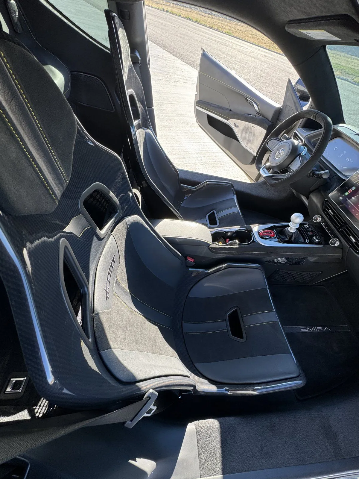

I personally find the B10's more comfortable than the stock seats due to the much more formed fit, nice bolstering and planted feel. They really transform things and give a more connected feel with the car.
As discussed here prior the stock seats are total boat anchors in comparison, they are about 55lbs each while the B10's are about 10lbs each (before hardware/brackets)

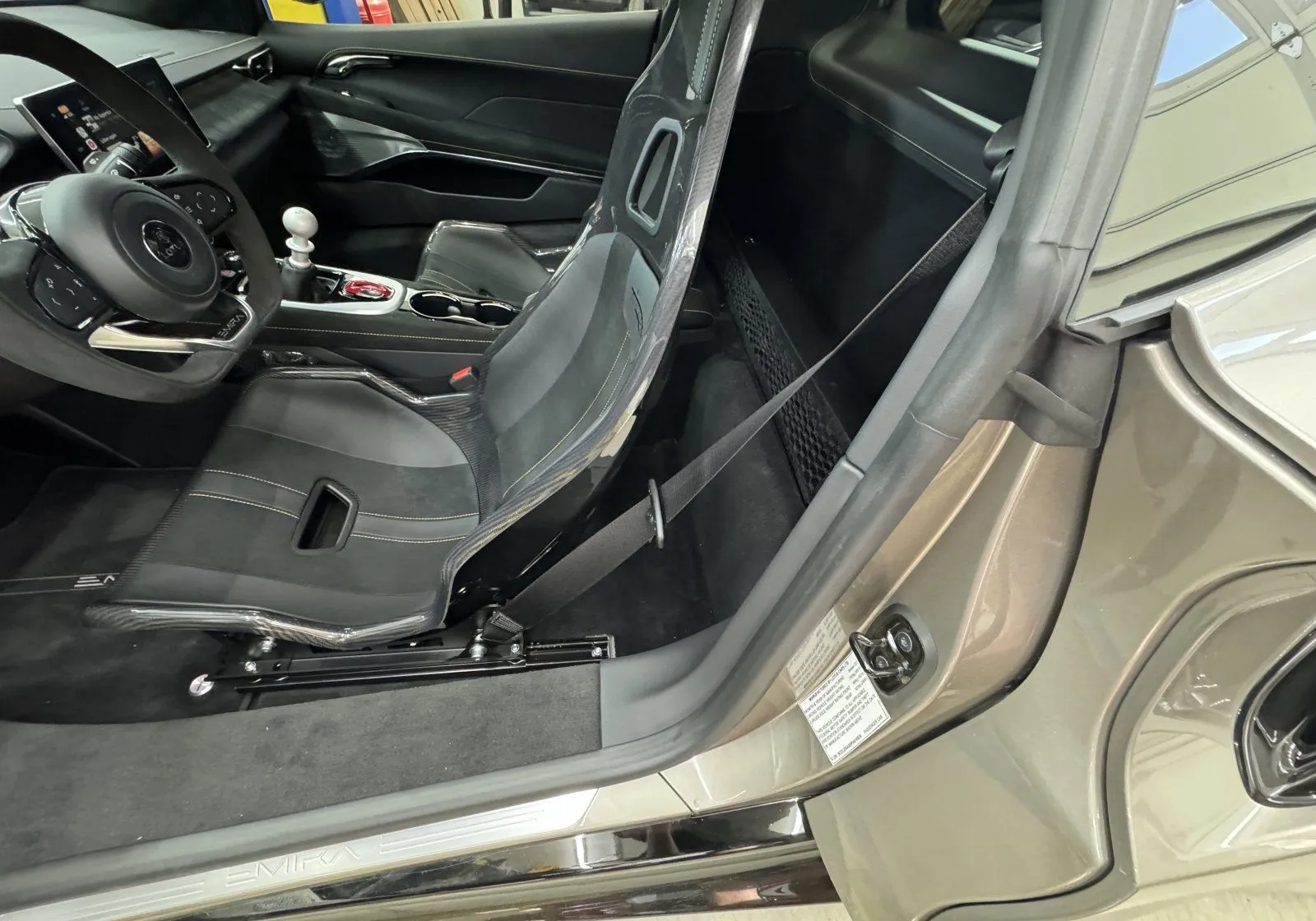

Install was about a 4/10.
The hardest part is lifting the oem seats out of the car carefully so as to not scratch anything.
We put down some painters tape and cardboard to protect the surrounding surfaces.
Bolting the new brackets together with the seats was easy and we did two adjustments on the recline/height to get them where we liked them. Lifting the Tillett assemblies in and out of the car was easy though for those.

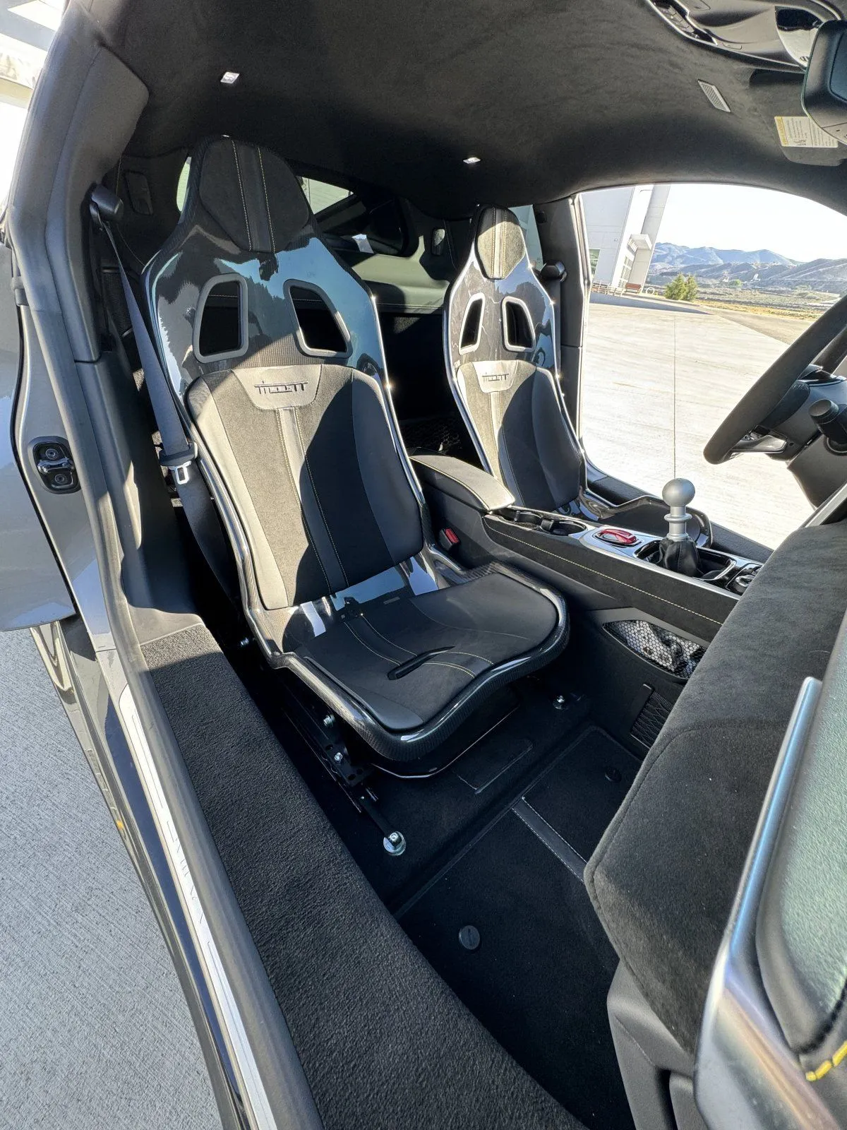

You got it!
Decent amount of pass through room with it fully forward.
Also -- when its all the way back I can barely touch the pedal and Im tall so there is a lot of adjustment range.
