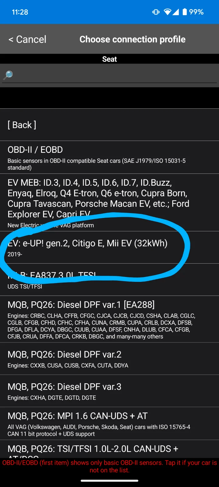

I then chose to use Seat as the car Brand. I chose a 2019 model of something
You mean this one ?
You know, I tried several car options, and I believe that the Seat brand may have showed the best information. That model you chose appears to be an EV of some type. It still may have some of the same software though of an ICE car. I would think that if we can confirm which underlying brand software the Emira is running that will help isolate which brand/car to mirror for us.
I sent another note to the developer of the software asking if he could help with which version of the software we may have and also signed up ($7) for the paid version of the App. I have not reconnected yet though and will try that in the next few days and see if I can provide a better answer on which car to emulate.
