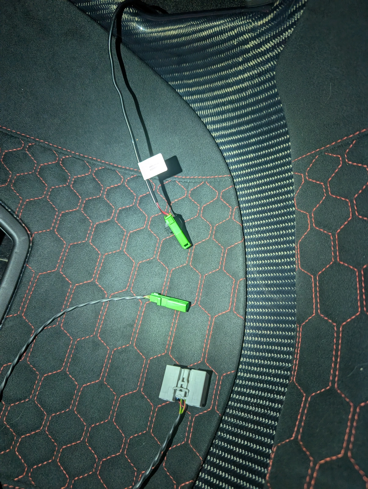

So... To clear the air bag codes, I decided to give these a try. They confirmed via email that the kit will work on both the driver and passenger side with the weight sensor. I assumed that the green plug would connect to the one that comes out from the seat belt receiver. However it turns out that both plugs are female... I've emailed them for help and will see what happens...
Did Jubu test these on US cars? I was under the impression there’s no way this would work on cars with occupancy weight sensor. I hope this isn’t another issue like the ECU where it wasn’t tested on US cars.
The euro system is most defintely different than the U.S. system so the same kit will not work on US cars and solve all of the codes. - just the airbag and seat belt buckle ones.
We have had someone install our drivers side kit on their passenger seat in the UK and it worked so the Euro version is much easier to deal with. I think Jubu maybe assumed they were the same.

Good news: My airbag warnings are gone. I didn't even need to bring it to the dealership to clear the code. I did use a BlueDriver to clear all codes (despite the fact that no code was showing up) before starting the car up so I'm not exactly sure if it was necessary.
Bad news: I have a JP spec car.
