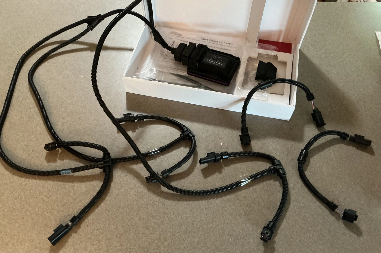

Guys the notion that this is difficult because of 3 connectors that basically swap right in and click is unfounded. The only reason why they may be some difficulty level is because one of the boost sensors is not as easily accessible from the top so you must take off the bottom diffuser and get to it from there but that is the only one, the other simply click in seconds lol
After ordering the unit, TDI did graciously send me an email asking if i felt comfortable removing the rear diffuser and underbody to get access to one of the harnesses or if i had a shop that could do it before completing my order. Ive already had the rear diffuser off once for the GRP Ti exhaust install, not a big deal.
I will have the rear bumper off as well whenever i get the car back from PPF for the Ti exhaust tip and Woflbox rear camera installs. so will have a better idea of how easy (or difficult) lower harness plug is. at least its all harness plugs and not old skool wire dissection....LOL.

Hey guys, I went ahead and scanned the install instruction in PDF for y'all, so you can determine for yourself...cheers
Cheers, that’s perfect, certainly nothing there to put me off fitting one myself.

As it seems from this instalaiton guide and my assumption they fool the original ECU to think it's running lower boost and different RPM than the engine actually does.
And then relay on that the ECU are capable of adjusting fuel and ignition on these false inputs, so it still runs safe and not lean out or other bad things happens after a while?
This might work ok for a road vehicle for some time that only see short periods of full trottle, but I would be even more skeptical to run this on track when the car is propper used.
This is my thoughts, but I'm more than happy to stand corrected if anyone that actually know what this box is doing with the signals it shows to the ECU.
and how the ECU reacts to this manipulated signals. I would love to get a clarification. (and even and buy a box if this explanation is trustworthy. :))

Most warranty issues don't really involve taking the engine apart. I think one can hide it enough that it's not noticed. For any computer ECU connection put it in mode 1 and I believe it is bypassed electronically. I can always verify with TDI. Another option is to make a longer lead to boost 1 so that it is now accessible from the top of the engine somewhere. Then it would just be 3 easy plugs to disconnect
