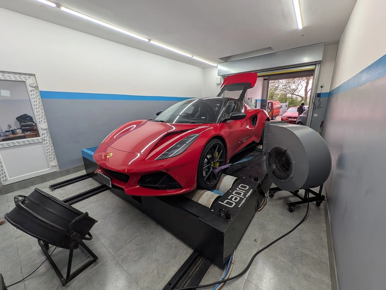

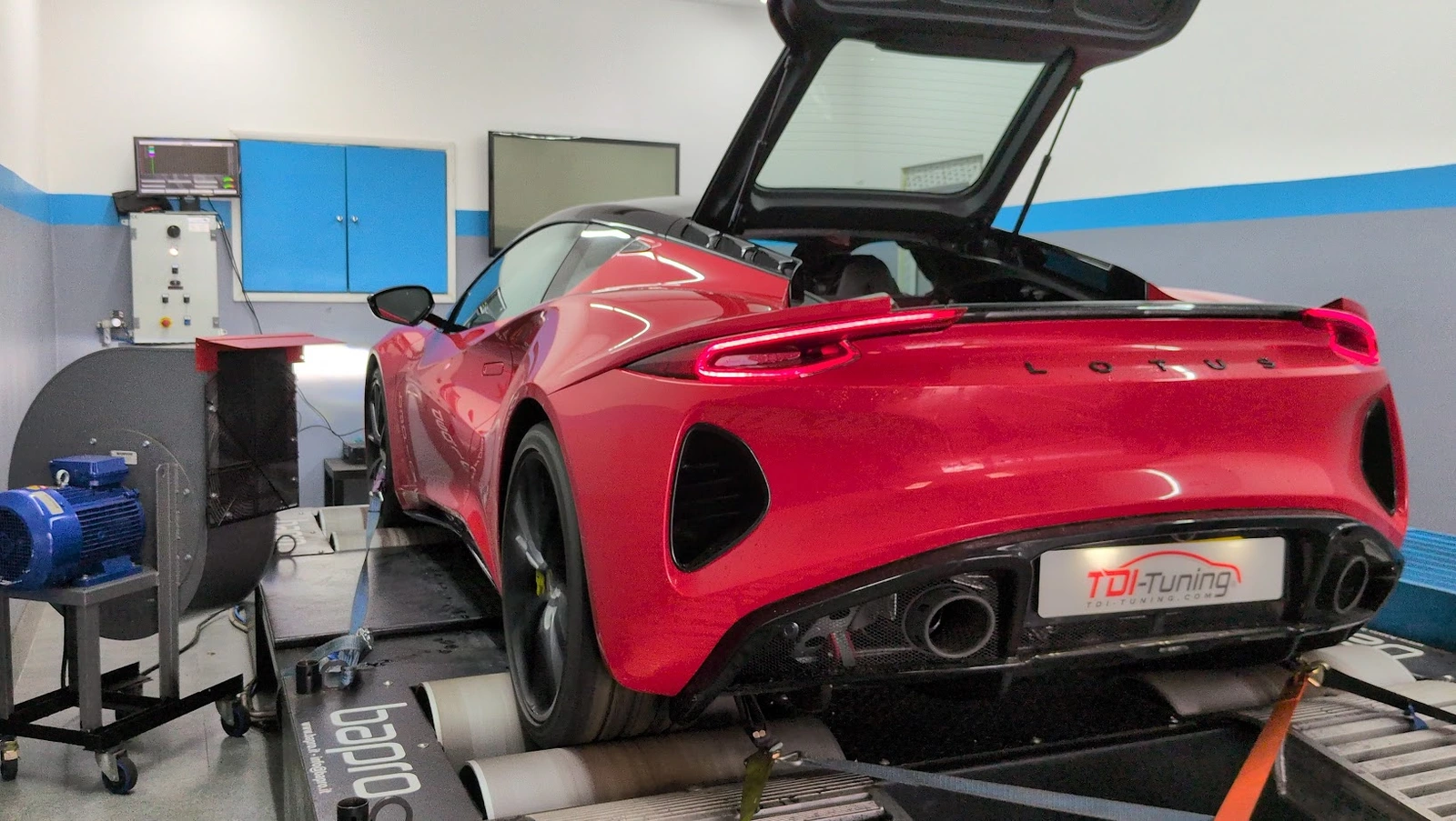

Good day today, TDI got the car on the dyno for some base runs and then tweaks to the software in their box to see what's possible whilst checking temps and error codes, etc to ensure the car was running fine and happy.

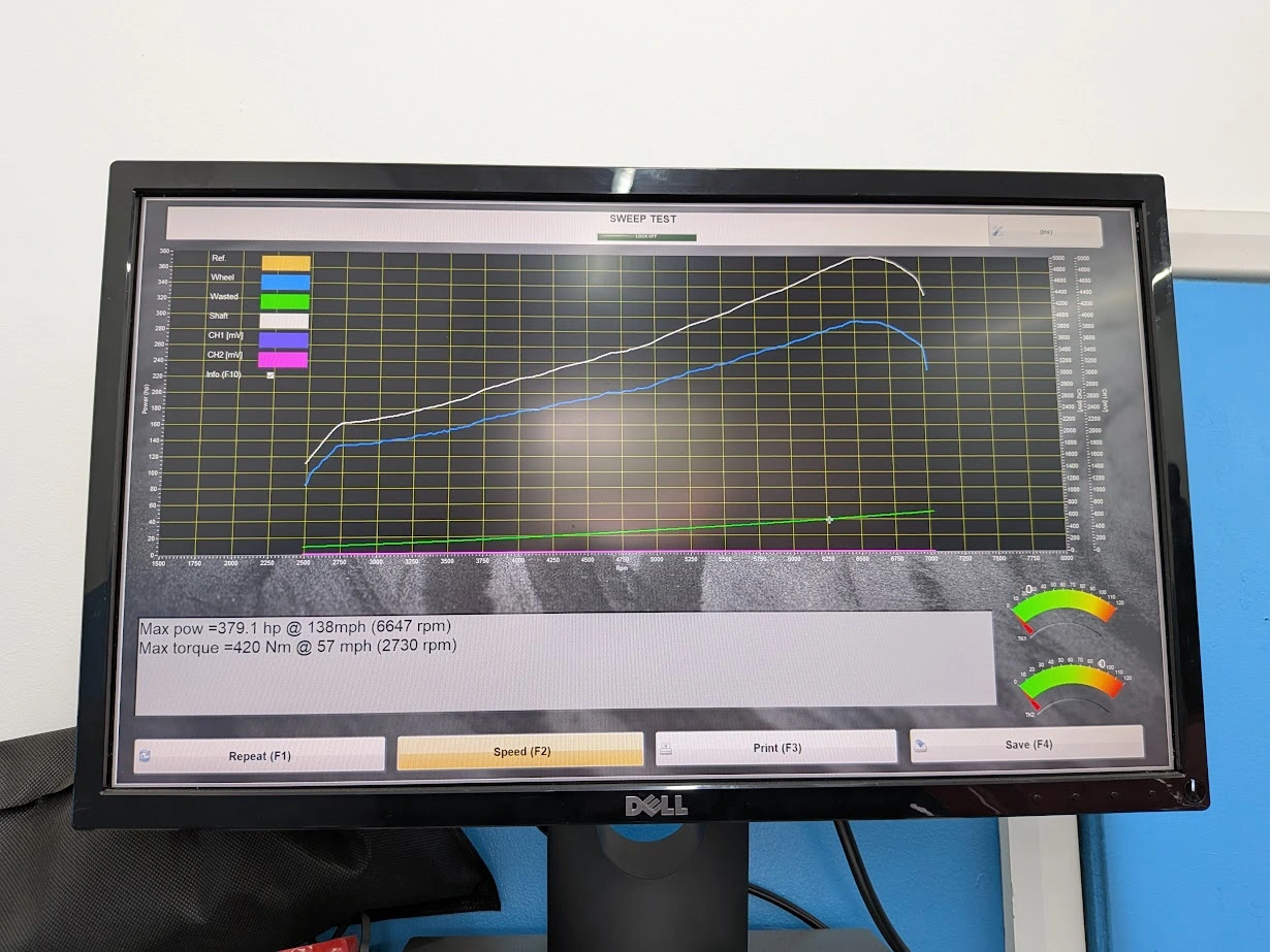

Baseline run was interesting: 379bhp and 420Nm. That's more bhp than I was expecting but slightly lower torque. The car picked up on the fact the front wheels weren't turning so threw up an error code and CEL light which TDI quickly read and cleared. All runs were carried out in 5th gear, Track mode with ESC switched off.

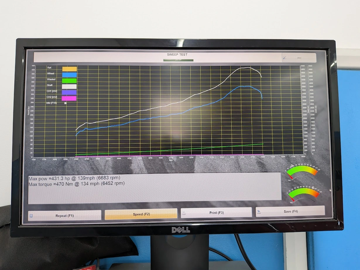

After trying out a few different settings and tweaks TDI settled on a repeatable 431bhp and 470Nm which we achieved on multiple runs. Engine temps were good with just the standard dyno setup (no extra fans required) and even though the photo shows the engine compartment up we actually did most of the runs with it closed. At this level the car ran the same numbers repeatedly with no issues whatsoever.
