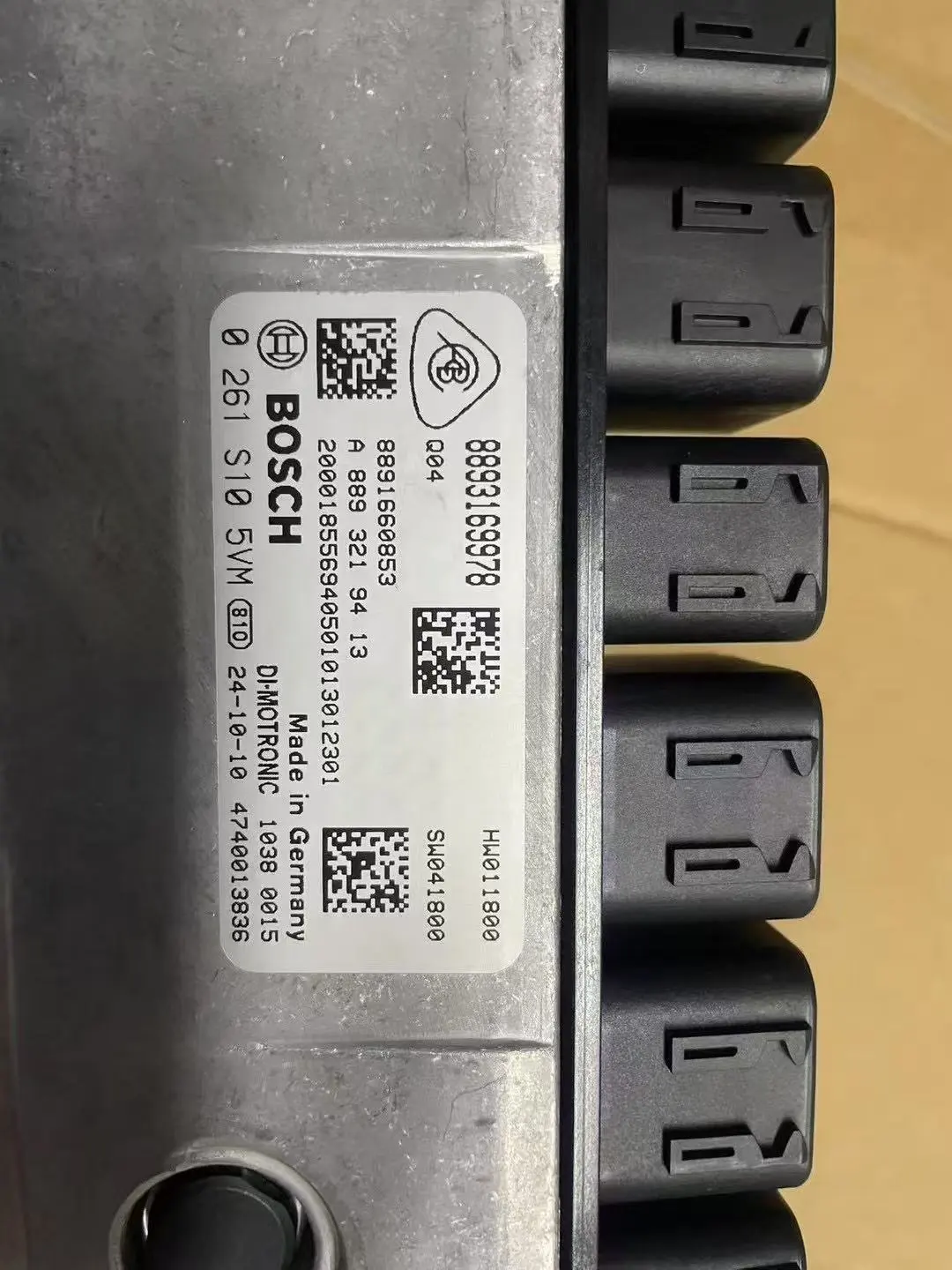

Unfortunately some ECU's from 2021 onwards are still unbreakable.. :-(
Does anyone have a photo of the ECU label of the i4?

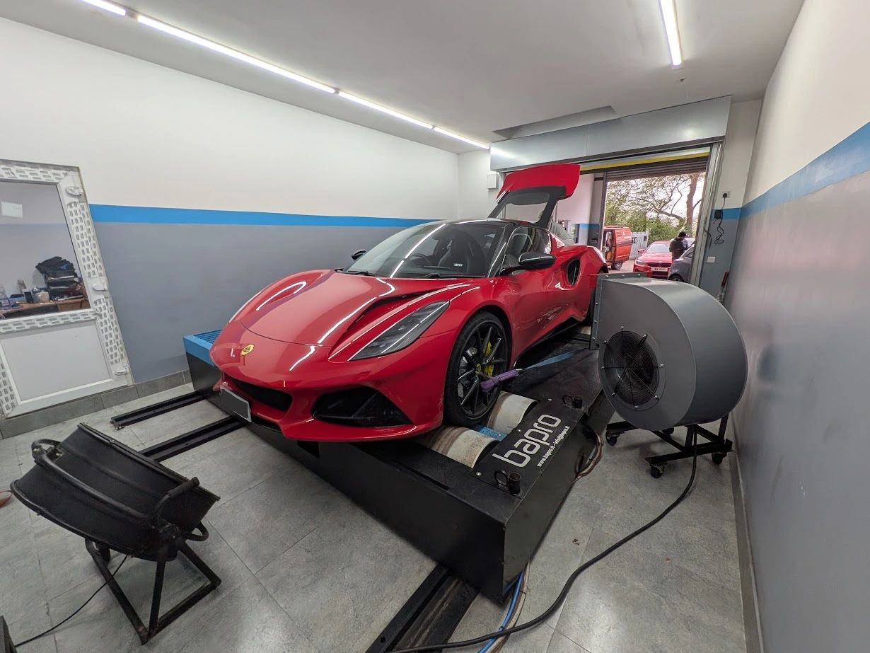

Good day today, TDI got the car on the dyno for some base runs and then tweaks to the software in their box to see what's possible whilst checking temps and error codes, etc to ensure the car was running fine and happy.

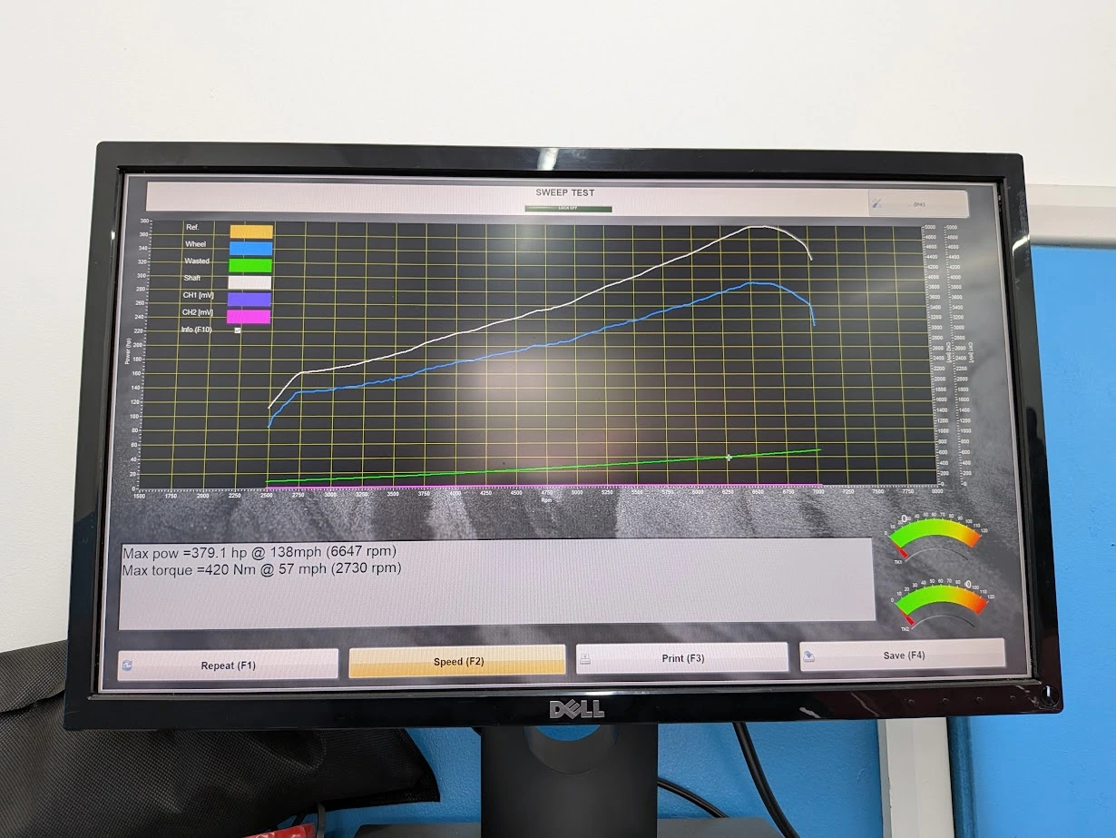

Baseline run was interesting: 379bhp and 420Nm. That's more bhp than I was expecting but slightly lower torque. The car picked up on the fact the front wheels weren't turning so threw up an error code and CEL light which TDI quickly read and cleared. All runs were carried out in 5th gear, Track mode with ESC switched off.

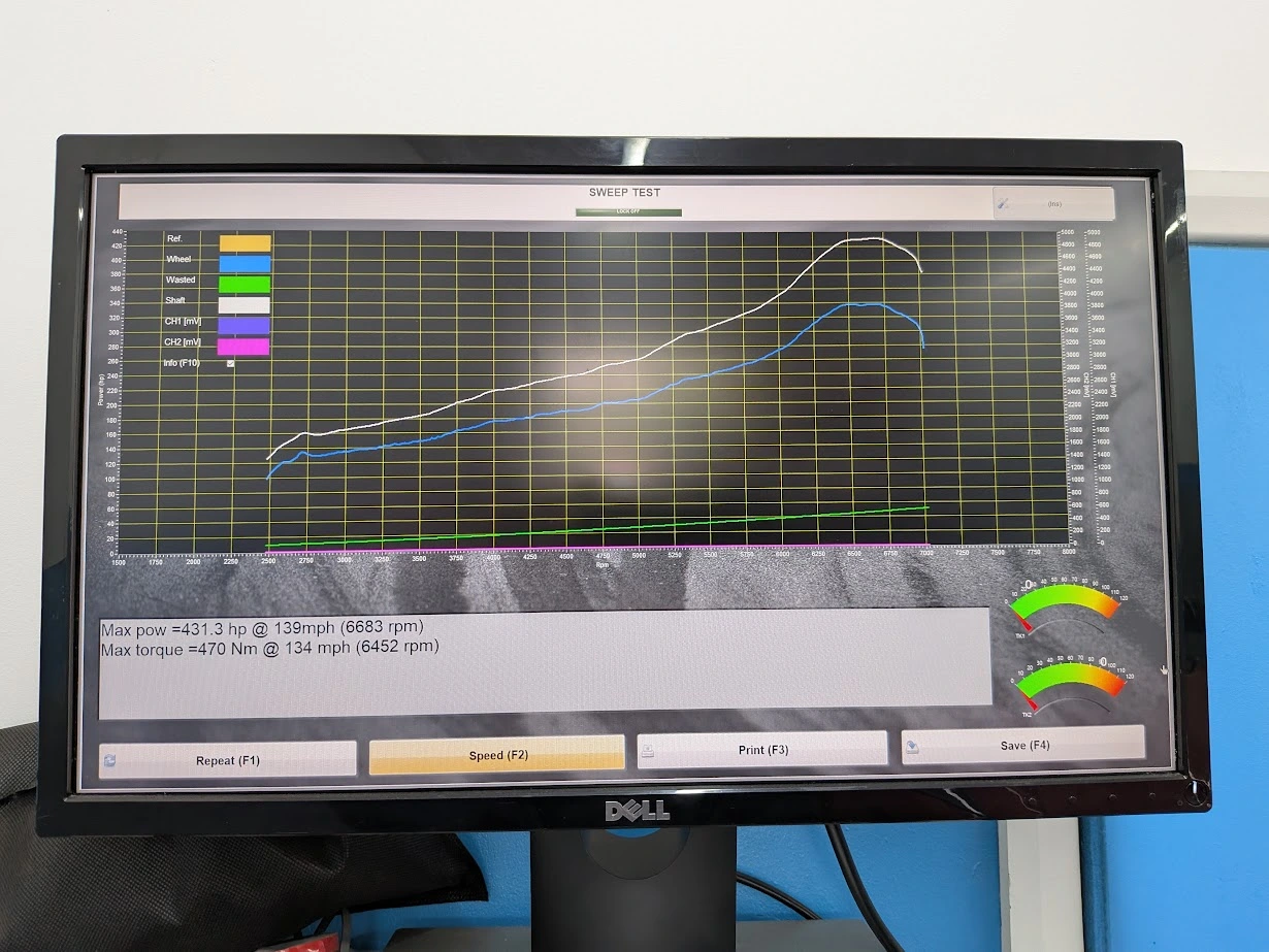

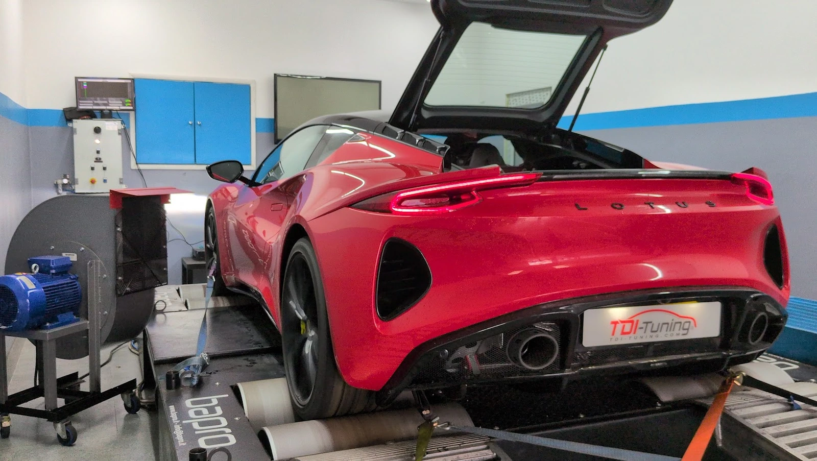

After trying out a few different settings and tweaks TDI settled on a repeatable 431bhp and 470Nm which we achieved on multiple runs. Engine temps were good with just the standard dyno setup (no extra fans required) and even though the photo shows the engine compartment up we actually did most of the runs with it closed. At this level the car ran the same numbers repeatedly with no issues whatsoever.
I haven't had much of a chance to drive the car on the final map other than the drive home which was pouring with rain. Already though the mid range is much improved, and through the final 2k it really punches hard - performance is significantly improved. I'll test the car over the coming days and report back.
Right now though having 430bhp on tap via a well developed tuning box for a few hundred £'s that I can easily remove is an absolute no brainer.
