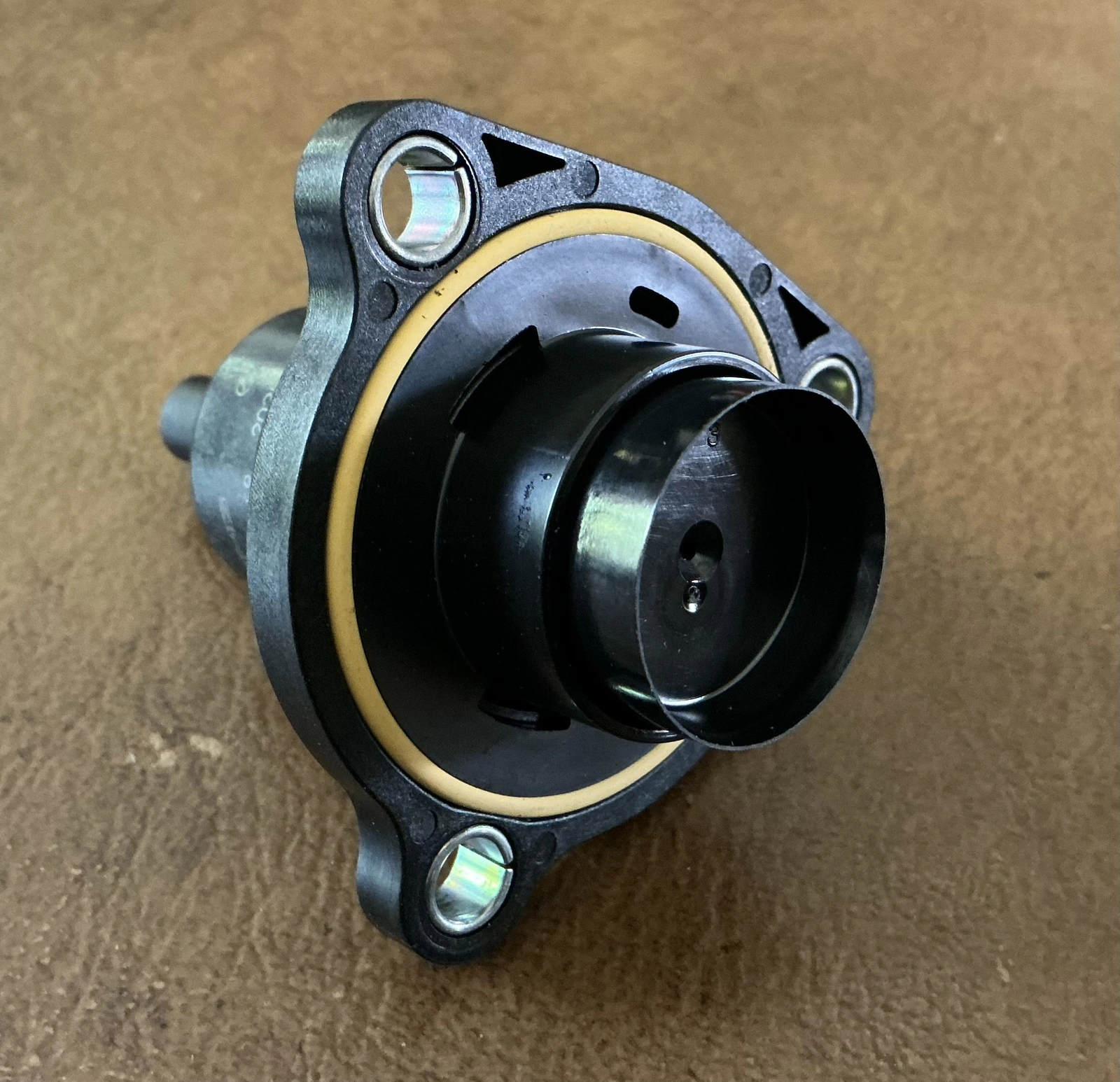

Coming from the Abarth world a decade ago as a hobby build car, the GFB BOV was a great modification. In the Alfa 4C, there were no options for an atmospheric BOV. Called up my drug dealer Greg@GRP and asked if there were any BOV options for the M139. He suggested the GFB BOV… install is literally 10 minute swap (UNLESS you drop one of the bolts in the engine bay and have to jack of the car and remove the rear diffuser…ask me how i know! LOL)

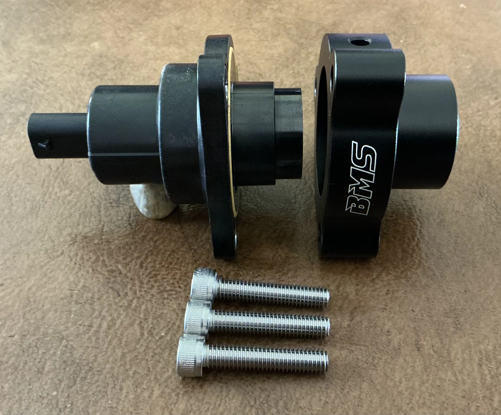

I also have the Burger Motorsports (BMS) BOV plate and if youve been watching BMS JB4 youtube video, you do hear them mention the install of their BOV plate.

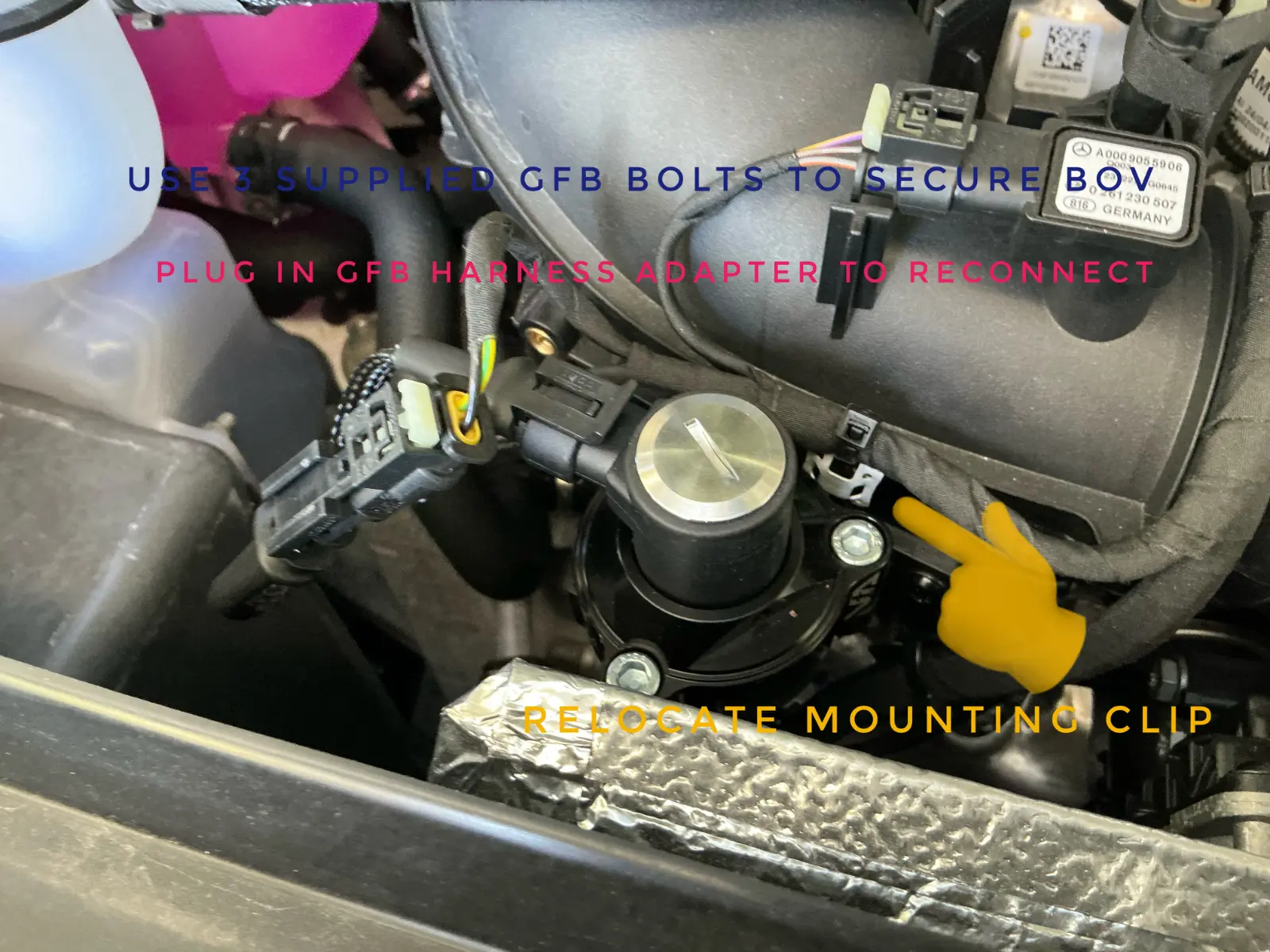

Install was easy.

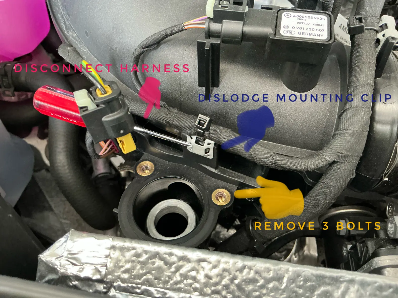

1. Disconnect harness plug on OEM BOV.
2. Remove 3 bolts

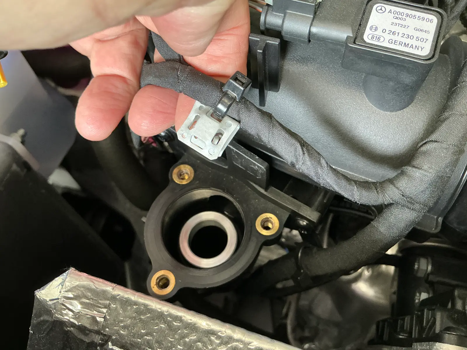

3. Dislodge wire bundle mounting clip near BOV, you will need more clearance space to mount the GFB BOV. Just use a little flat screwdriver. See picture.
4. Orient the GFB BOV so bolt holes line up. There is only one orientation that will work and its easy to figure it out.
5. Use the 3 GFB supplied bolts to mount BOV.

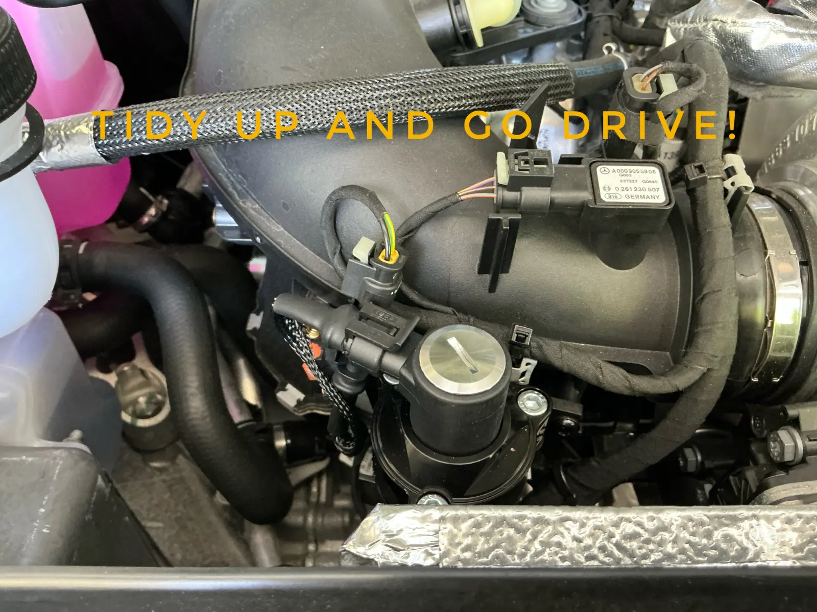

6. Plug in supplied GFB wire harness adapter to reconnect BOV harness.
7. Relocate dislodged wire bundle mounting clip.
Done!
After a short 10 mile test drive, boost seems better while pushing. Sound is great. No CEL ✊🏼🪵. Driving another 100 miles today to C&C and running around so will report back.

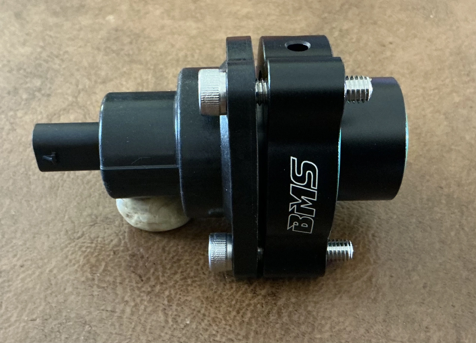

Regarding the BMS BOV plate, i dont know if i will test it or not. Would seem like a step back from the full GFB BOV.
Ironically, I was initially going to install the BMS plate first and test it a bit but i was like might as well do the GFB.
The BMS plate install is super easy. See pics.
What’s interesting is that even though OEM BOV is an AMG part, the valve part and mechanism is very plasticky and flimsy.

I installed mine as well...not that many miles maybe 20 in total. No CEL. VERY "polite" pshhh sound. Small boost is very short pshh. Deeper into RPM's and lots of boost, longer louder PSHH. I'll take some video at some point.
But easy installation, took me maybe 10 minutes going slowly because I didn't want to lose a bolt down the engine bay (like...Doc!). Similar reaction to the sound, with windows closed, engine cover on, and through my rear firewall sound deadening the sound is very audible...your non-automotive-nerd passenger will ask you wtf is that.
