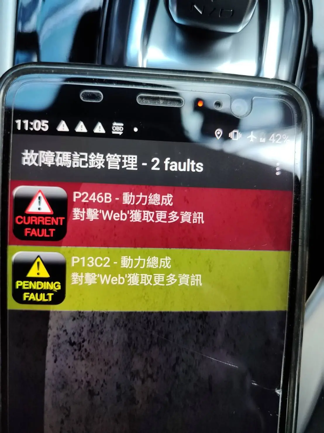

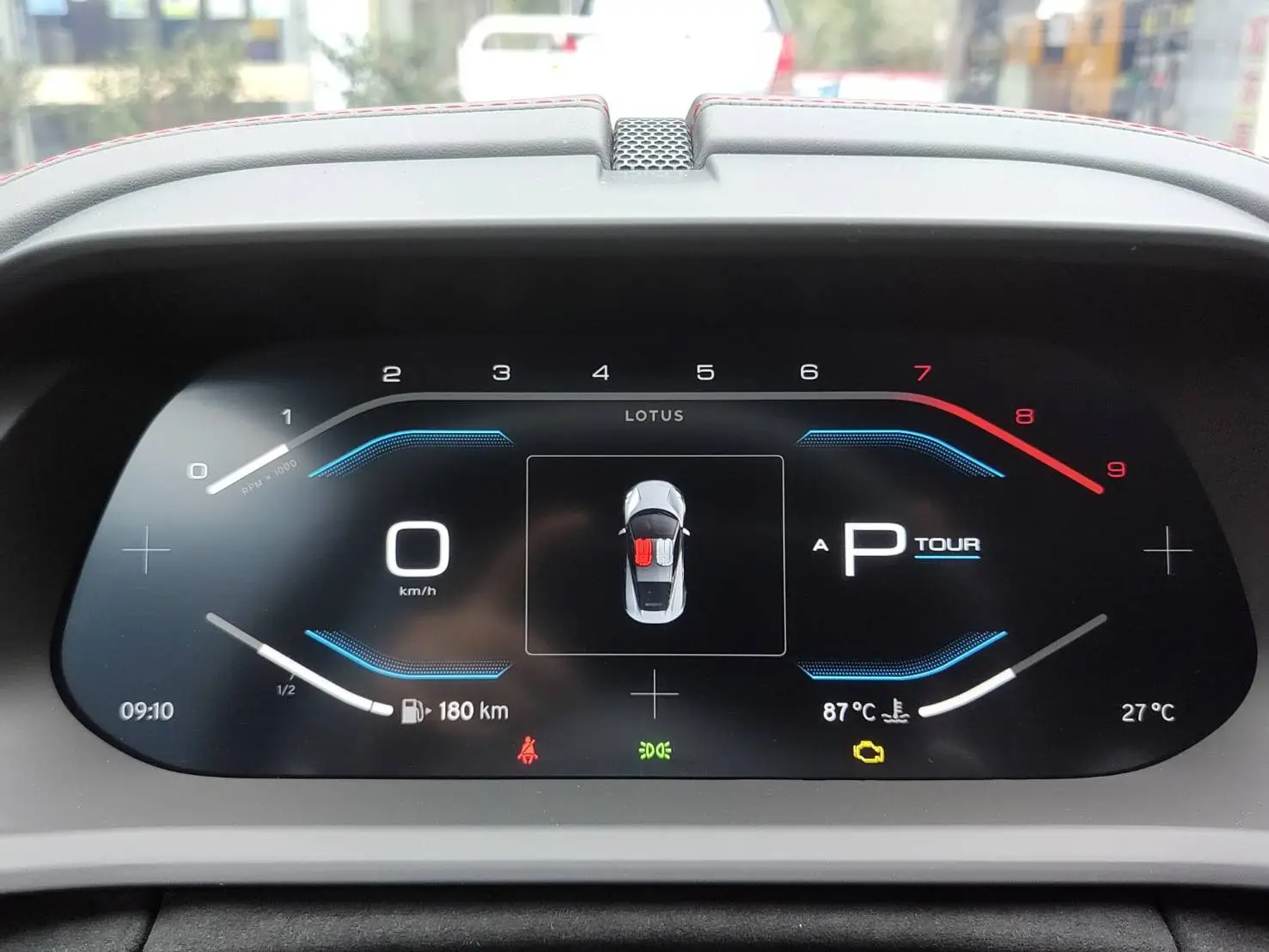

The first warning light appeared after a spirited mountain drive. Using an OBD2 scanner, I identified errors associated with the exhaust valve and OPF (particulate filter). During the 1,500-kilometre service, the dealership reset the errors, and I didn’t think much of it. I then took the car to Lihpao for a track day, where I pushed the car hard, hitting redline in almost every gear.
Curiously, the warning light never appeared after these intense track sessions. However, after returning to mountain roads and engaging in spirited driving, the light reappeared. This led me to suspect that driving conditions and techniques specific to mountain roads were triggering the issue.

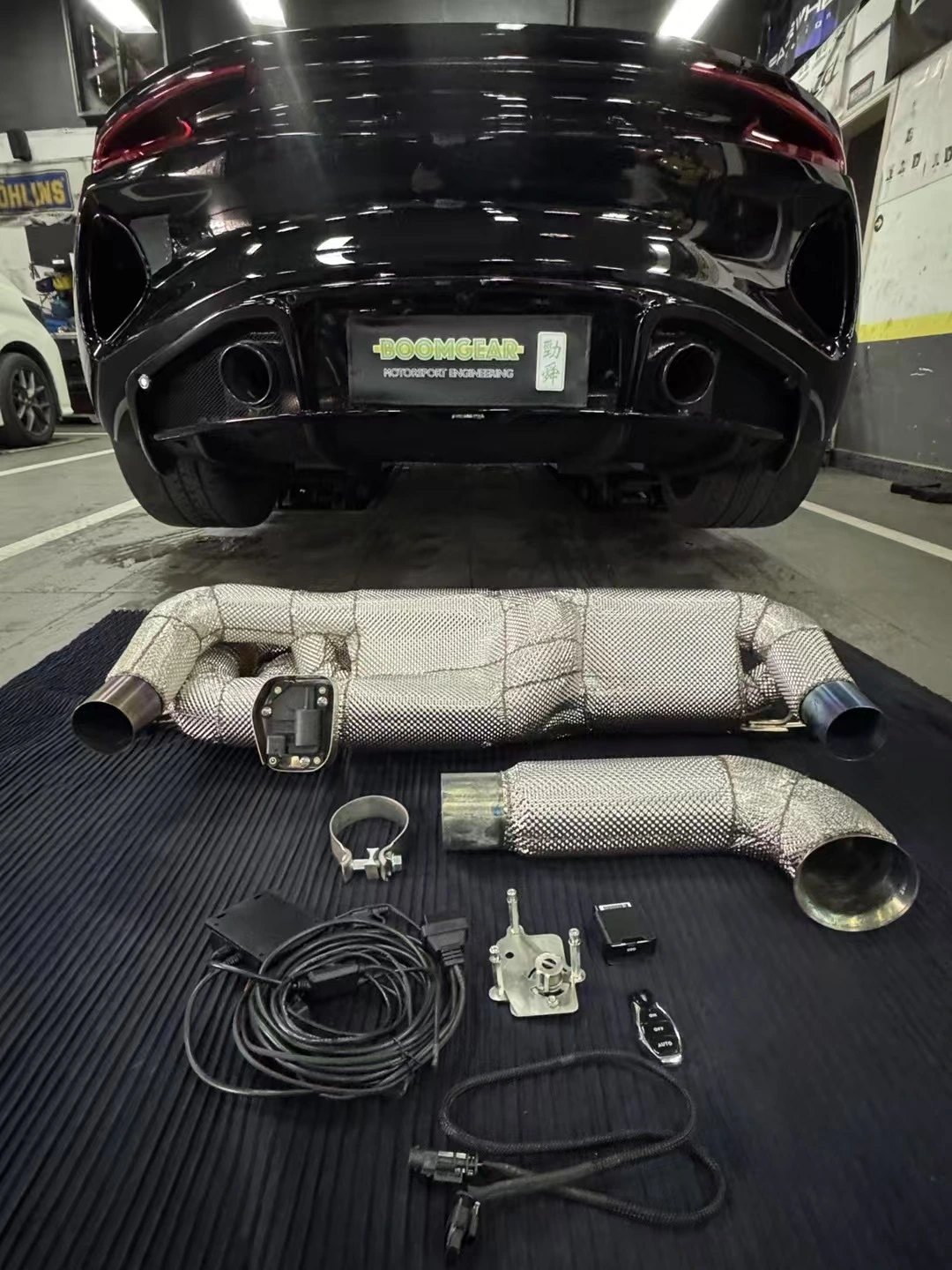

Actually an aftermarket exhaust is prone to have problem than the stock exhaust. We are testing to have heat protection wrapped for the whole exhaust system to see if we could solve this problem, just like how your Mach5 downpipe is.
Would like to see more details of your testing!
Heat protection for the whole exhaust system with custom built mechanical value and OBD active value control. 15 hot laps with no issue.

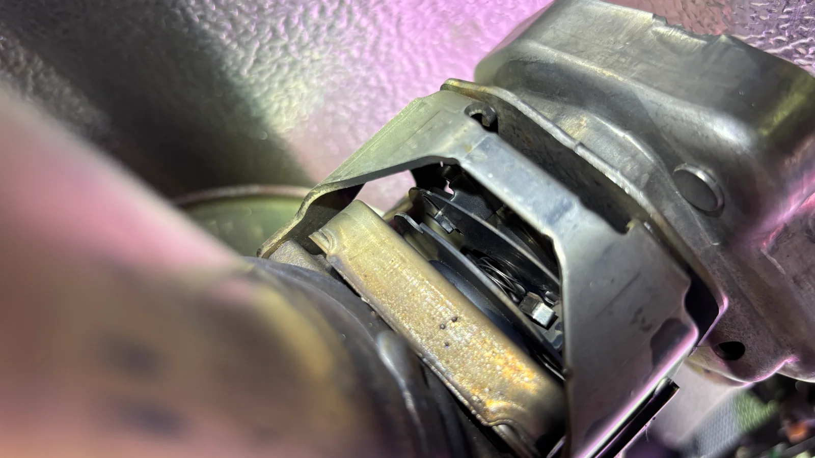

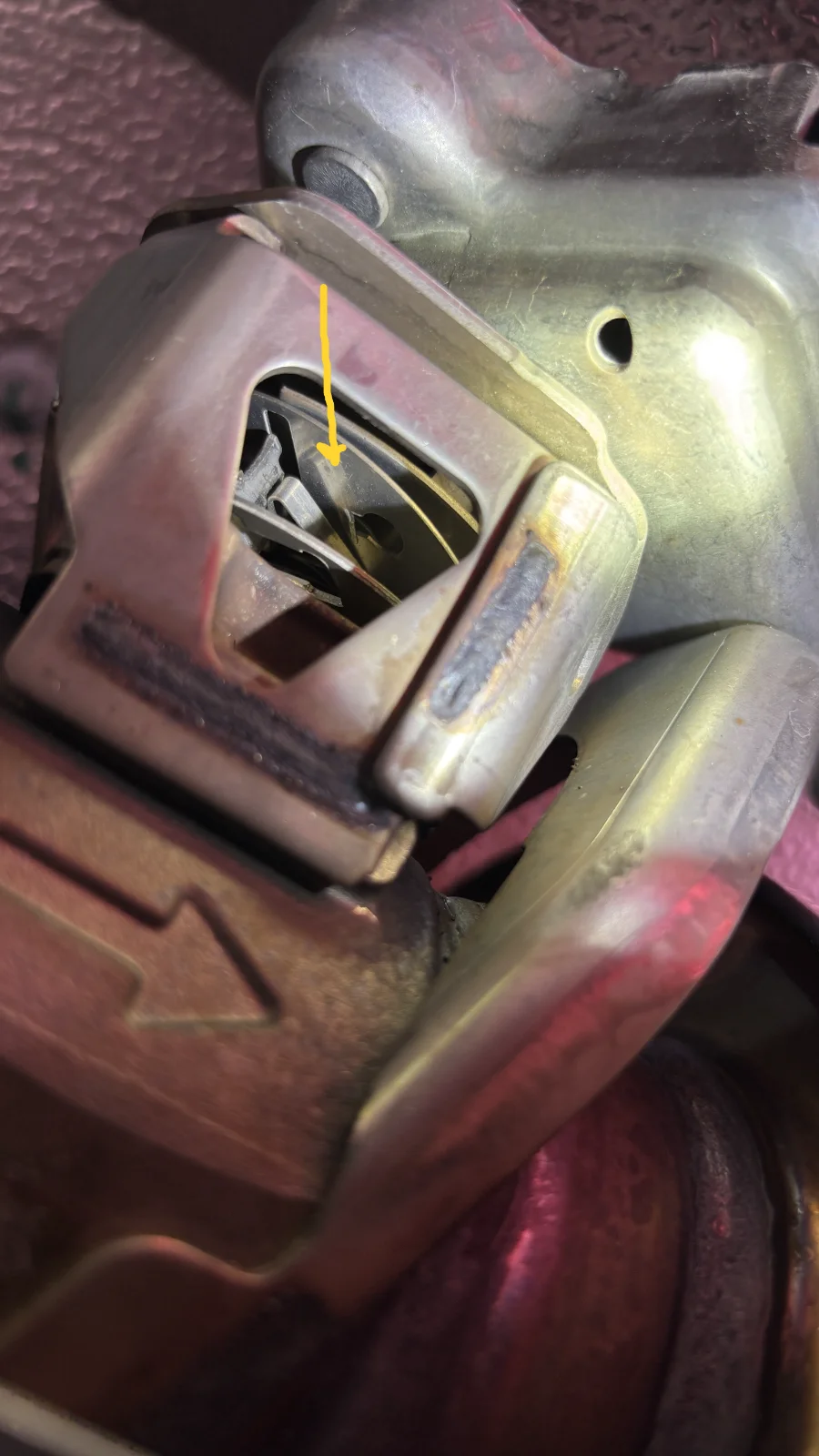

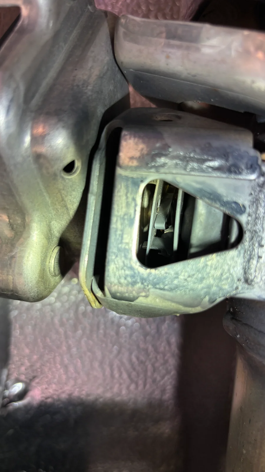

@HankRS225 So, I believe I just finally resolved this issue with my Emira and wanted to share. I've attached 3 photos to this post. The one with the yellow arrow shows the issue, and is pointing to a spring-loaded disc in the exhaust valve actuator assembly. It is very hard to get great photos, but you can see that the disc is bent on one side. There are slots in the disc and tabs in the adjacent disc that are supposed to mate together. There are also some leaf springs that are supposed to engage those tabs. For some reason, mine was dislocated.
My CEL came on for the first time when I first put the car into sport mode. I can only assume that maybe it was installed every so slightly off at the factory, and when the car went into sport mode, the actuator turned and the disc slipped off. With a flat head screwdriver and some tweezers I was able to bend the disc back into place and get the tabs through the slots and setup the springs properly (other 2 photos). After I did this, I turned on the car and I still had a check engine light, but then I used the remote to put the valve into oem mode and then back into full open mode and the CEL light disappeared.
Based on your original comments about back pressure and things being too sensitive, I believe the valve actuator itself is what's reporting pressure readings on the valve. Since mine was bent, it was likely causing strange readings, even when not turning. I initially chocked it up to aggressive acceleration, as you had, but recently I noticed it was turning on when coasting, and doing random things other than accelerating hard. I'm guessing there is some interval at which the pressure reading is reported, rather than being instantaneous. I hope the fix lasts and if you haven't resolved yours, I would go pull off your bottom panel and take a look at your valve assembly.

FYI, this problem goes away if you go with any of the after-market exhaust options. The connection is more direct and is done via a simple coil spring that is just the right size of the notch on the valve motor. Obviously, you still need the after-market exhaust calibrated. However, after that, you won't have this issue given the entirely different valve control mechanism on all after-market exhausts.
