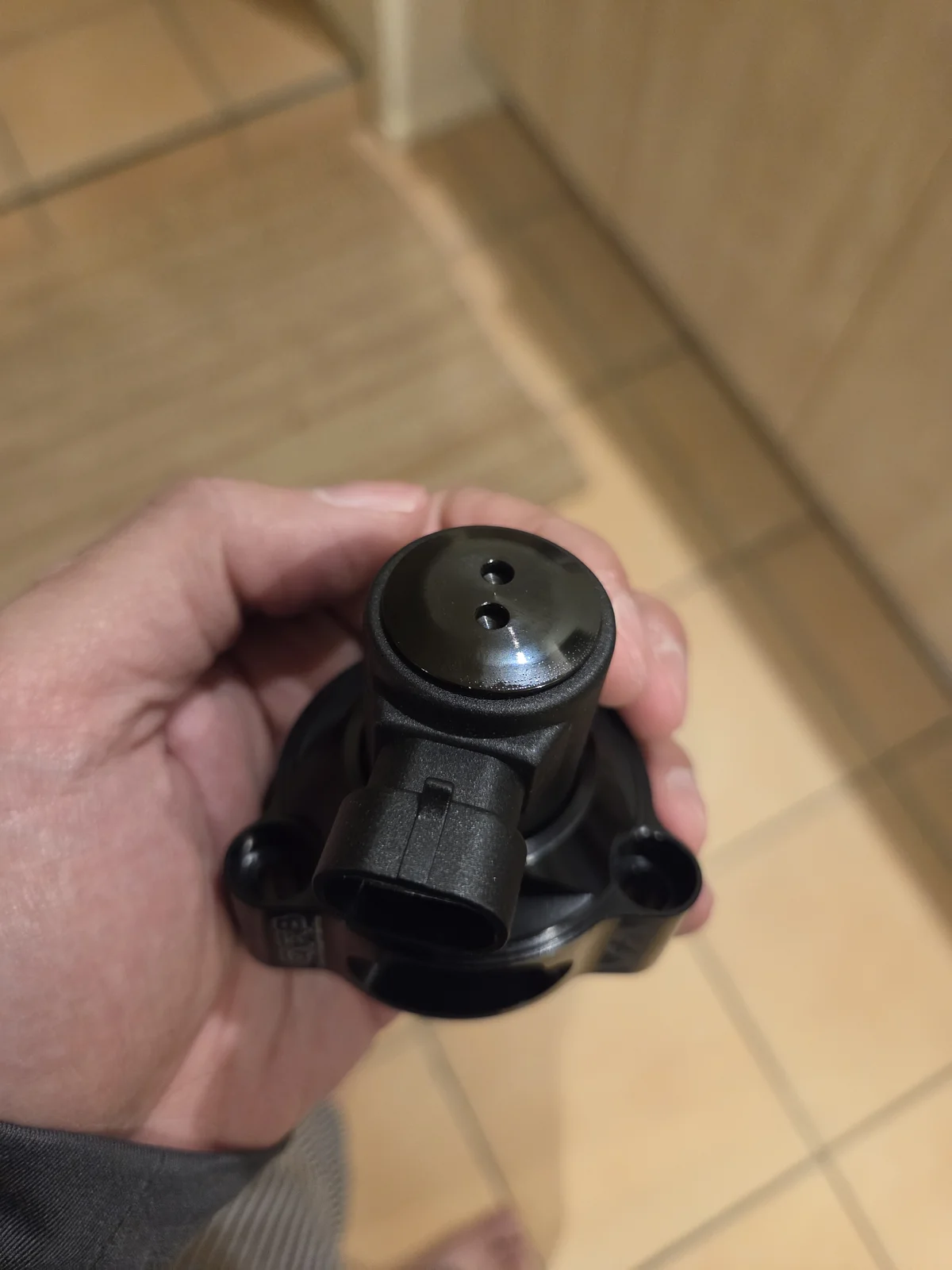

Installed mine today. Seems they changed the silver cap with coin slot to a different one with 2 holes.
