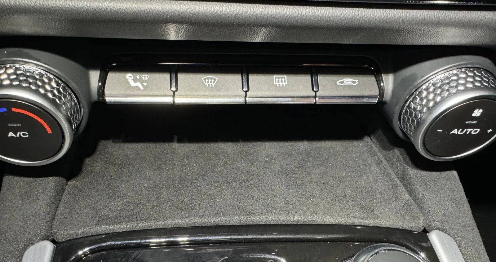

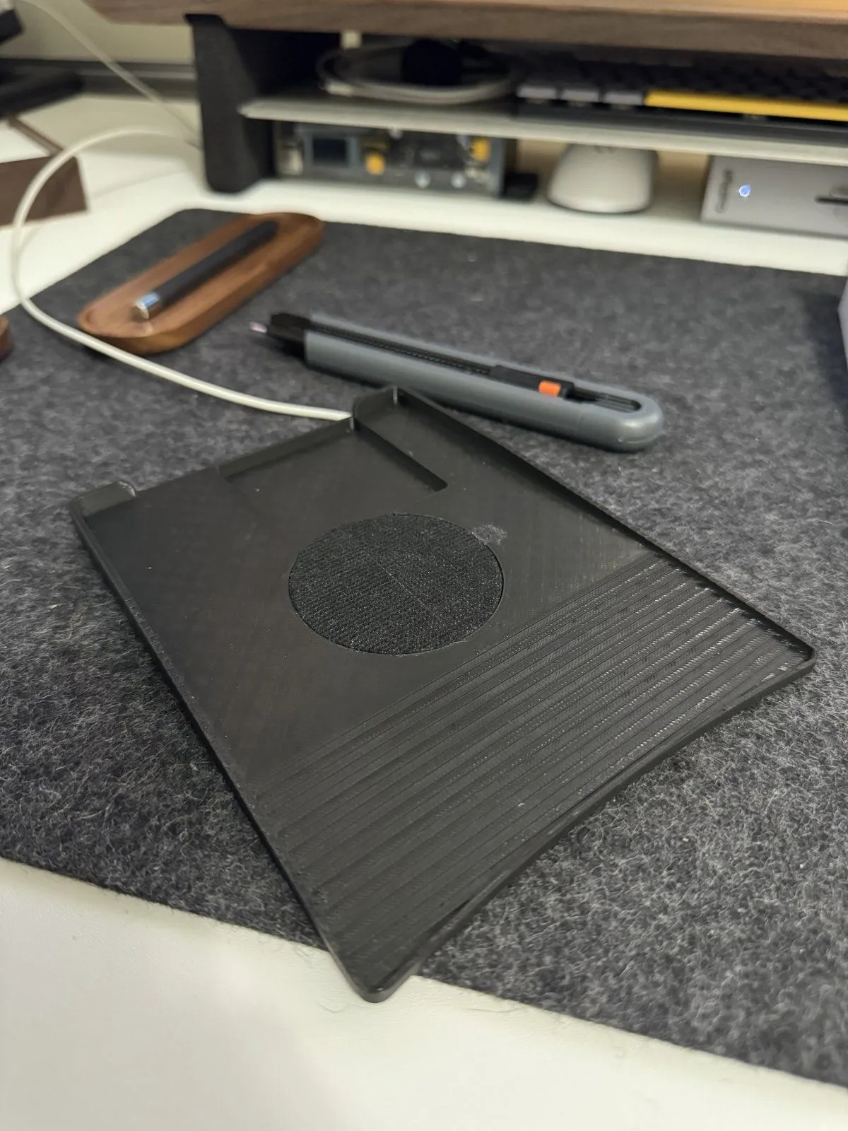

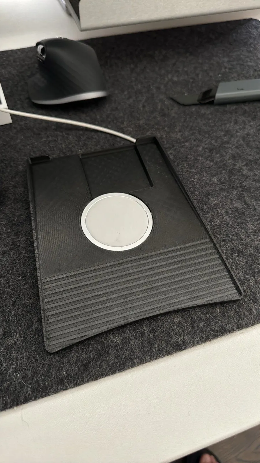

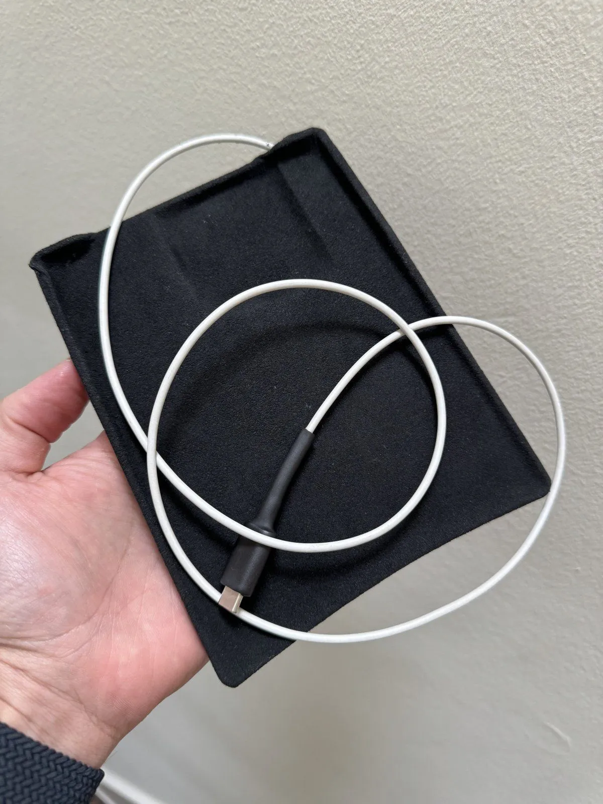

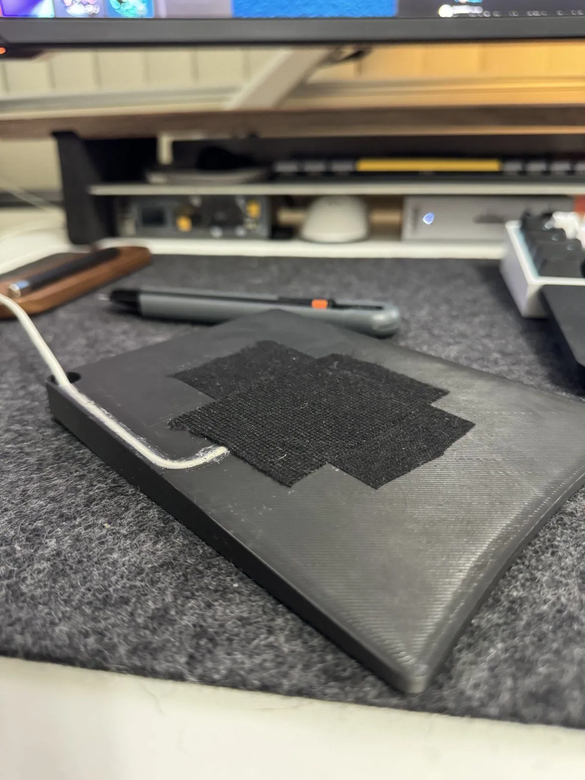

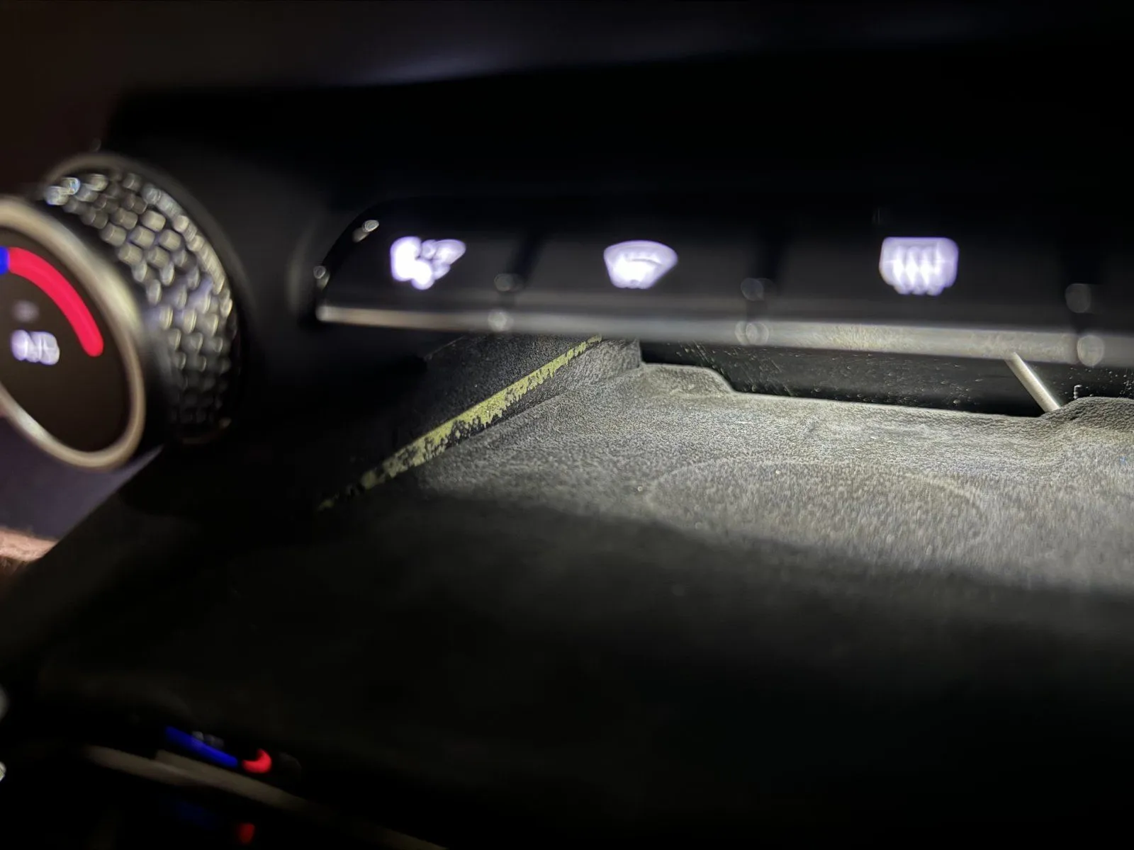

I finally have the car so was able to test fit.
I modified @frazzer ‘s design a bit. Moved the camera cutout to the back, rerouted the cable channel and removed the side holders.
(Thank you for the idea my friend! If you have the original 3mf file and are willing to share it would help me out a lot. I had to hack my way into converting the stl to mesh and it’s not pretty and very hard to work on 😅)
I need to make the sides taller though because, at least in my car, when I remove the stock rubber tray the alcantara stops short of the base and you can see glue. Most people won’t notice but it bothers me lol.
I also installed the USB-PD power source that @Porter suggested because the factory usb port doesn’t provide enough wattage to effectively charge the phone. I used the spare 12v power connector from this thread

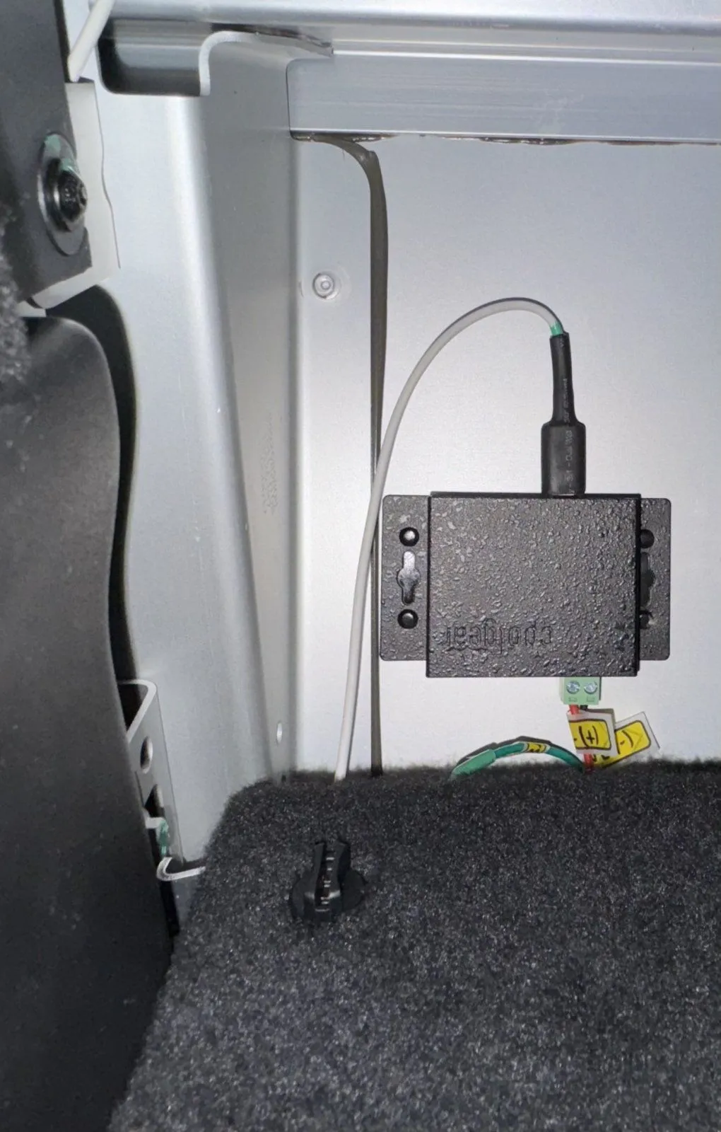

Could you tell us (like we're idiots) how you installed the power source?

It’s really easy, take a look at that thread I linked.
There is a spare 12v connector behind the glovebox. All you gotta do is buy the pigtail connector also listed on that thread and extend the wires to the footwell. Then you would just use that to power the usb charger.

What did you attach the power with? Command strips, rivets?

That looks awesome!! And I'm glad that power supply worked well for you! Any weirdness with it? Or does it "just work"?

It just works. The MagSafe charger is rated for “up to 15W” and I’m getting around 13. So not lighting fast but better than you’d get from most automotive Qi chargers.
@silent cilantro did you change what the cable goes to? Accessory fuse?
I didn’t. The connector branches off of the harness right before the glovebox connector. I just added the pigtail and extended the wires down to the charger.
I didn’t add any fuses but was considering it. I assume it already is fused since it’s a factory connection though.
