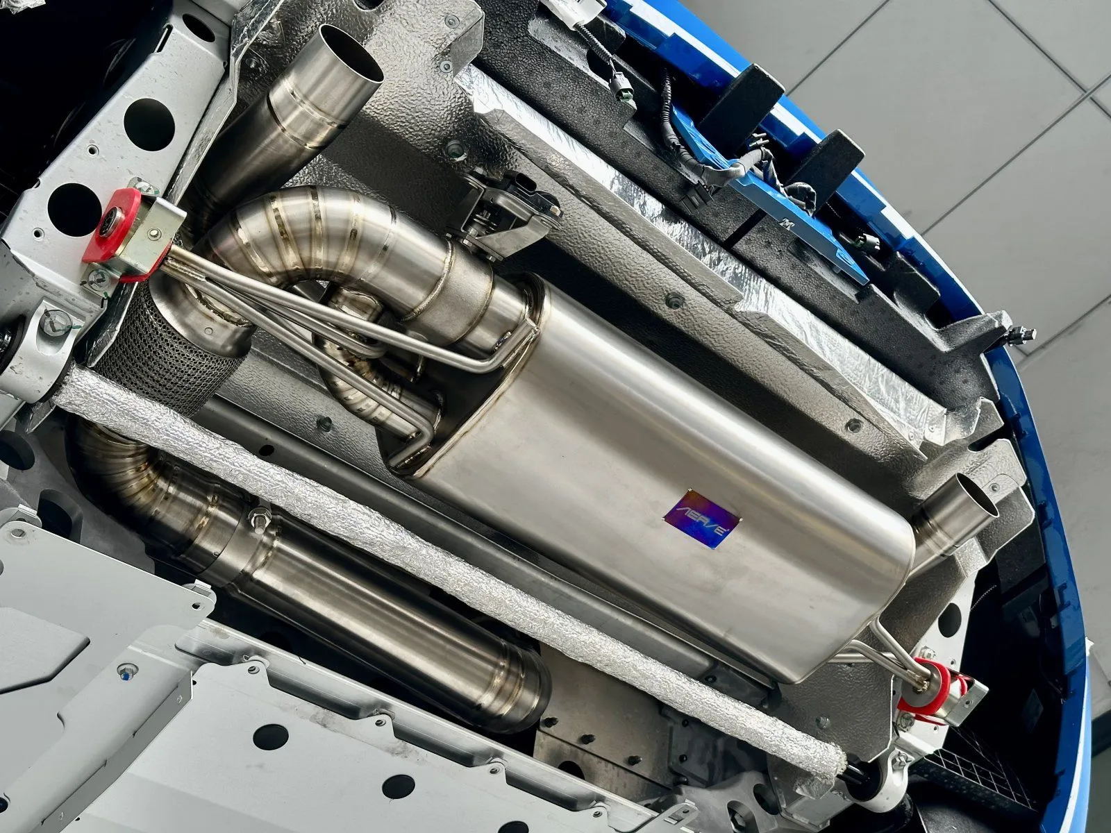

Mine just arrived today. Got the titanium tips and J pipe (not pictured) but will run the stock Y pipe.
Booked to install on Feb 16th and I’ll be producing a quality video with before and after clips recorded by a professional audio engineer.
For now, build quality looks impressive and it came very well packaged. I’ll keep you posted :)

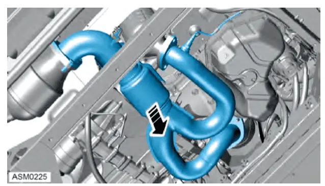

Maybe we can standardize how we talk about exhaust parts :)? This is terminology used officially by Lotus in their service documentation and are also widely accepted in the industry.

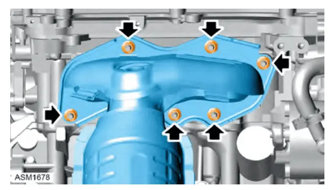

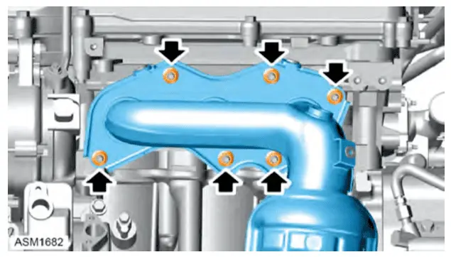

Starting from the cylinder head:
1.) Exhaust manifolds
- There are two of these, one for each bank.
- These are often called headers in the aftermarket world because the replacement is made of multiple pieces of tubes instead of a single piece construction.
- Have integrated catalytic converters in them.
- Have a pair of upstream oxygen sensors one on each side.

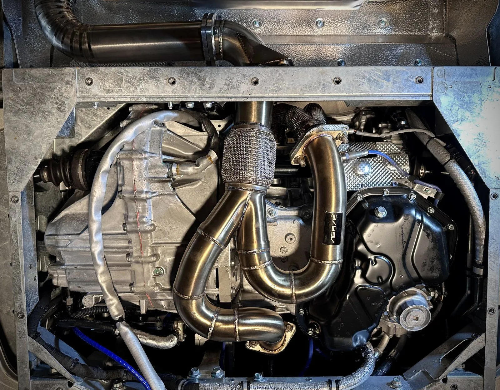

2.) Downpipe
- Also called a Y pipe sometimes.
- Role is to merge the exhaust flows from both of the exhaust manifolds into a single pipe.
- Has a built in resonator to remove unwanted frequencies.
- Has a pair of downstream oxygen sensors one on each side of the Y.
3.) Catalytic Converter
- Has no oxygen sensors.
- In the context of this thread some may be calling its replacement pipe a J pipe.
- Often mislabeled as an OPF by some more popular exhaust brands.

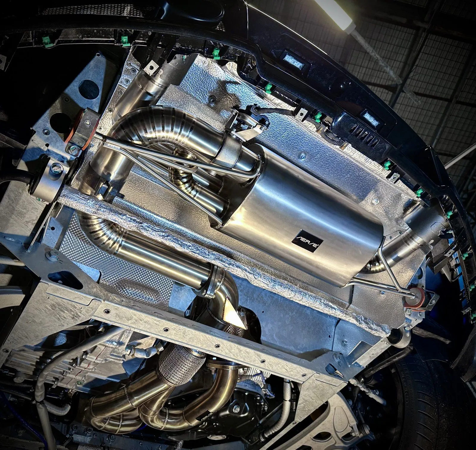

4.) Silencer Assembly
- Has an electronic valve actuator which routes exhaust flows through the silencer in order to silence the sound of the exhaust.
Other terms often used:
- Catback - An exhaust that replaces everything after the catalytic converter, ambiguous in the case of the Emira that has 3 catalytic converters.
- Axle back - An exhaust that replaces everything behind the rear axle, ambiguous in the case of the Emira as that probably splits the downpipe in half or something.
- Header back - An exhaust that replaces everything behind the headers.
