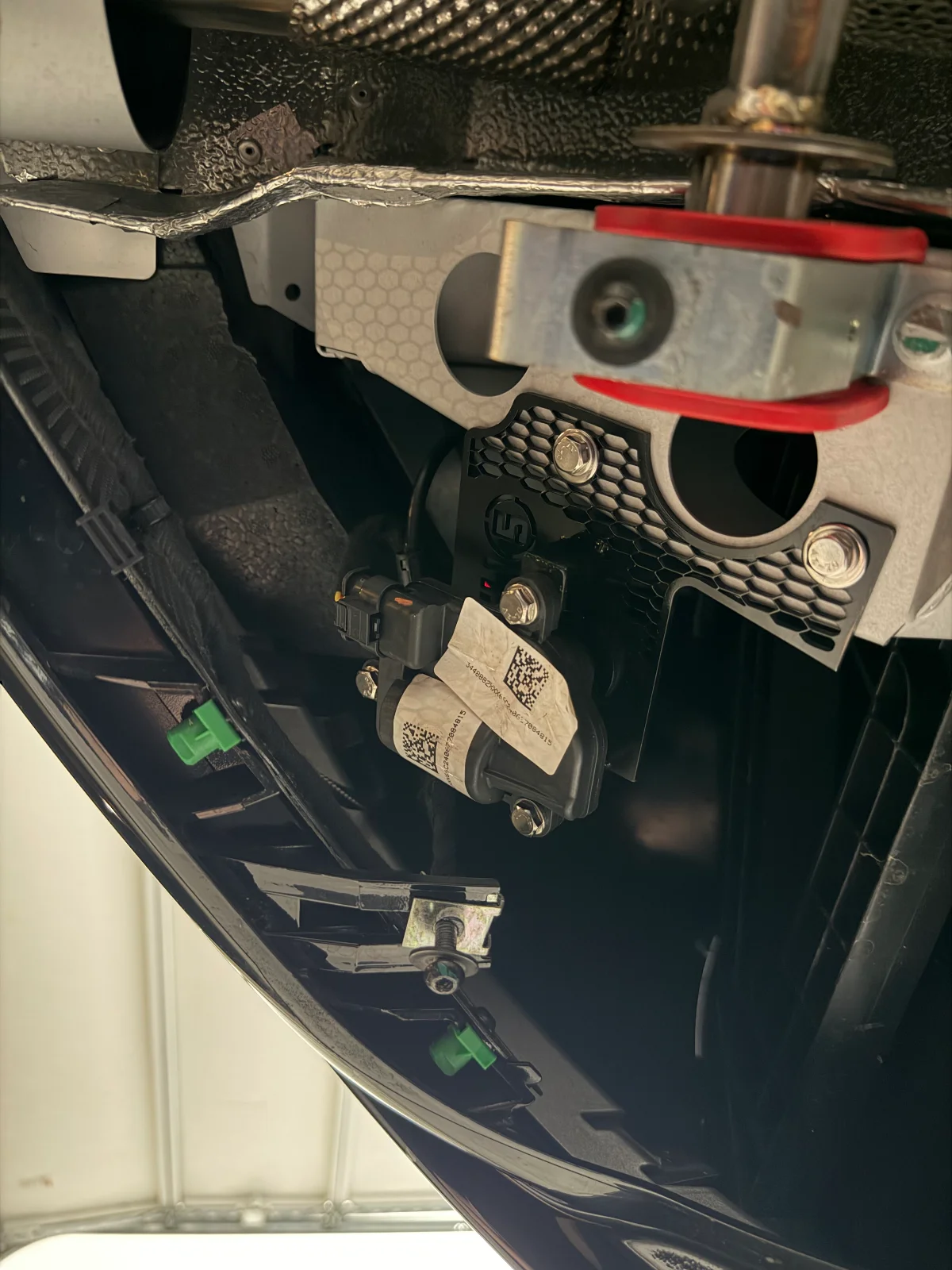

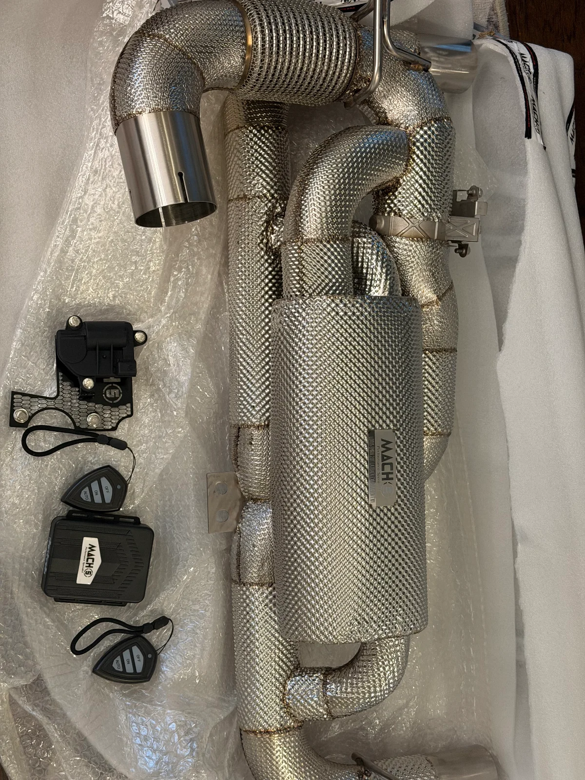

Finished the install and took it for a short spin, happy to report no CEL. The Mach 5 valve controller also seems to be working well and throwing no codes. It relocates the factory controller and uses it as a simulation for what the mach5 exhaust controller should do
As for the sound of the mach5 stainless steel exhaust. It’s a little too loud for my taste. It sounds like the piped in amg sound (I have the amg sound disabled) but it’s actually the exhaust sound now.

No CEL from downpipe, but CEL from valve controller 😭 P13C2, P246B, P1439.
Verified visually that the valve was not opening and closing anymore using the remote. I had a plastic burning smell, I seem to have burned my wires with my routing of the cable. I will contact Mach5 on how I should route the cable. They have the wires routed to the trunk but I couldn’t find any good way to keep the cables safe from the exhaust heat…

Did Mach5 give you an OBD valve controller or the old kind?
Mine was routed to the inner gap of the diffuser then through the left side rear wheel arch and into the cabin. The wire was also heat shielded.

Drove maybe 8 miles. I thought it was cable melting since while I was driving and stopped at stop lights, I could smell a strong plastic burning smell. I came home, took out the mach5 valve controller and inspected the cables to see if anything melted. Didn’t find anything. After thanksgiving holidays I will need to refit the OEM valve controller to the exhaust but the way mach5 has orientated the exhaust valve leaves the OEM cable short to plug in. I will see if I can get some more slack after the holidays. In the meantime, I’ve been in contact with mach5 with my observations and I don’t seem to be able to clear my CEL with the BlueDriver app, keeps saying the vehicle wouldn’t allow it to clear the codes.

Hi @Milk242 was a mid pipe (pipe linking the cat to the main exhaust) included with the Mach5 exhaust you purchased? Wasn’t included in mine.
Nope, but I did inform them they should supply a clamp due to the stock clamp is spot welded onto the stock muffler
