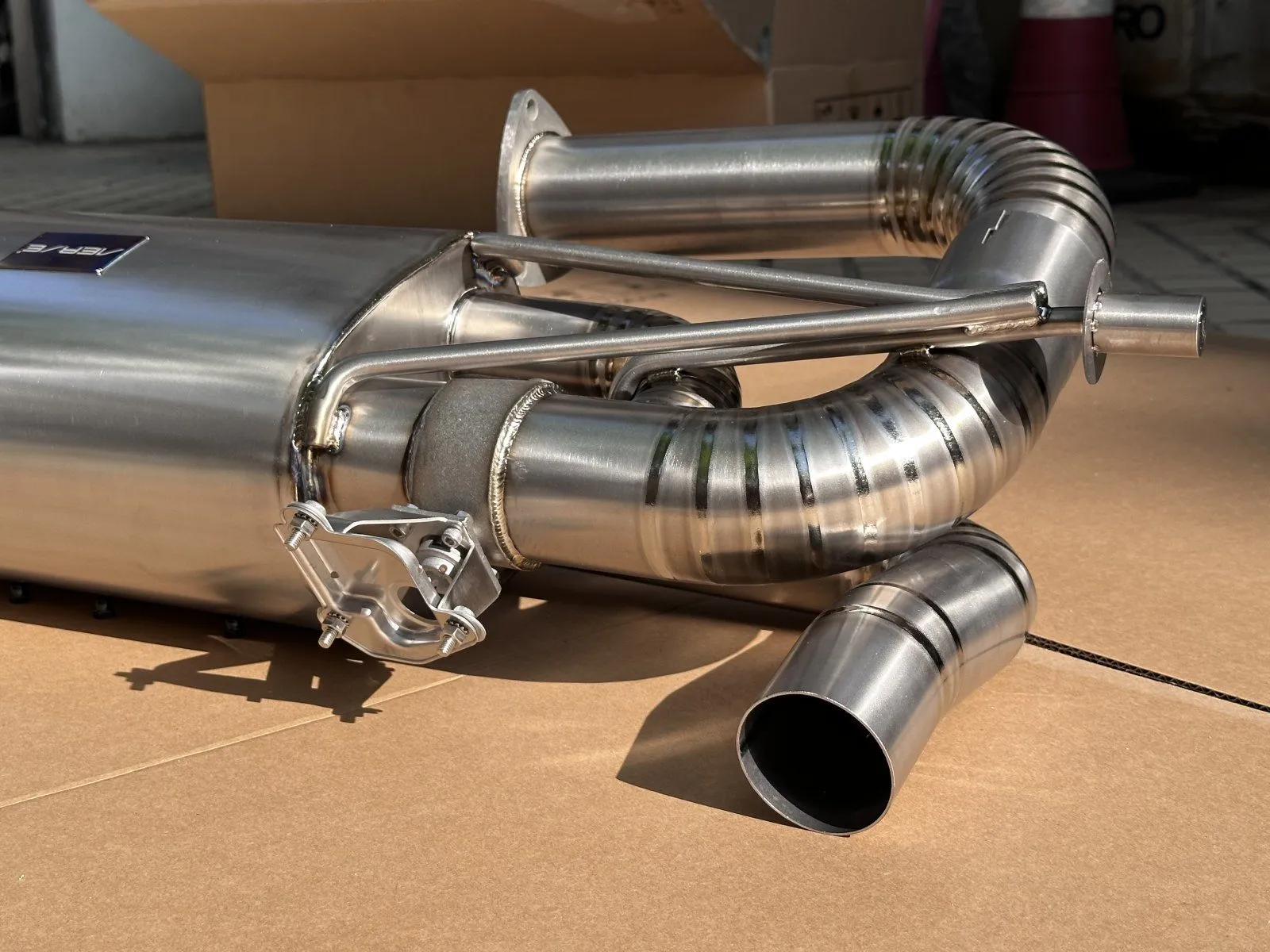

Unless I'm missing it, it looks like this whole system is using only a single cat? I wonder if that would pass non-California emissions. Gonna be interesting to see what this whole setup costs and how much it weighs.
Looks like the V6 system at least is a prototype - the flanges don't line up in the last picture...
I love the color and texture of titanium :love:
That is not a flanges not line up , is only the gasket…
If you don't mind me asking, why all the pie cuts (necessitating dozens of extra welds) on the backbox/muffler piping? Looking at the headers you've built, which do look very nice, you do seem to have proper pre-bent sections. Were the pie cuts just for the prototype muffler, or do you intend the final product to be built that way also?

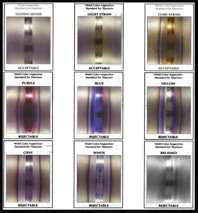

Regarding the pie cut and welds on the titanium exhaust, it is a standard composite. You can search for "titanium weld" to see examples of welding work on similar materials. I have attached a chart showing a perfectly welded titanium joint as a reference. Our final product will have the same level of quality.

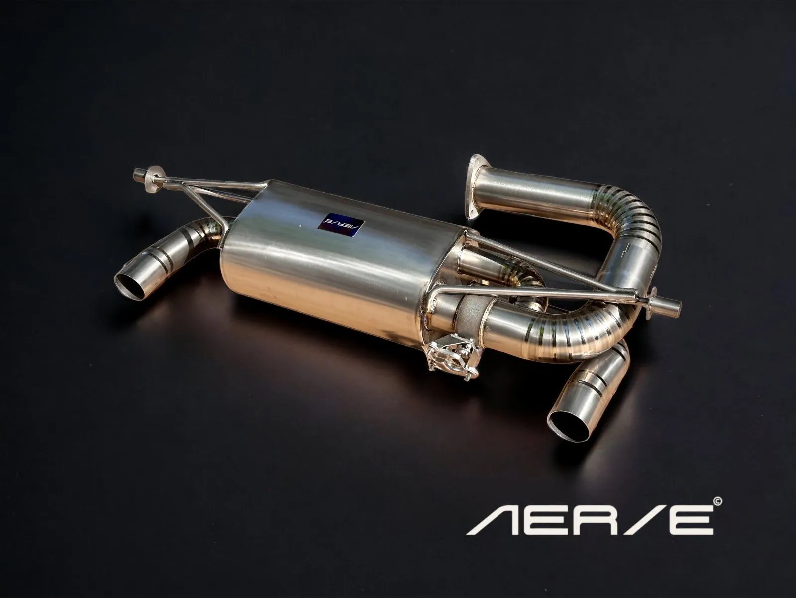

Our new titanium exhaust system for the Emira V6 and 2.0 models incorporates numerous detailed features in both the product and production process. These features have been inspired by our past experience in selling motorsport headers and titanium exhaust systems for Lotus Elise, Exige, and Evora models. We have successfully sold over 300 sets of these systems in the past three years.
The new Emira V6 and 2.0 titanium exhaust system , y-pips , header will be launch on our website very soon this weekend and also we have full specs carbon fiber and performance upgrades parts with Emira
will be arrive very soon.

That wasn't the purpose of my question, I know what a good weld looks like. What I was asking is whether it's necessary to have so many welded joints, it introduces numerous opportunities for rough or imperfect surface finish on the inside of the pipe where the flow actually matters. And I'm not saying that your product would necessarily have that, I'm just saying it introduces risk for QC issues that may occur normally in a production process at scale.
I know it looks cool to have all those pie cuts, but from a flow perspective it seems like it would be a more reliable end product if it was constructed from bent sections rather than many pieces of chopped straight pipe. Just a personal opinion.
Otherwise, very interested to see how people get on with this exhaust system and will definitely have it on my list as an option once my Emira finally arrives. Best of luck to you with this, I hope it's successful.

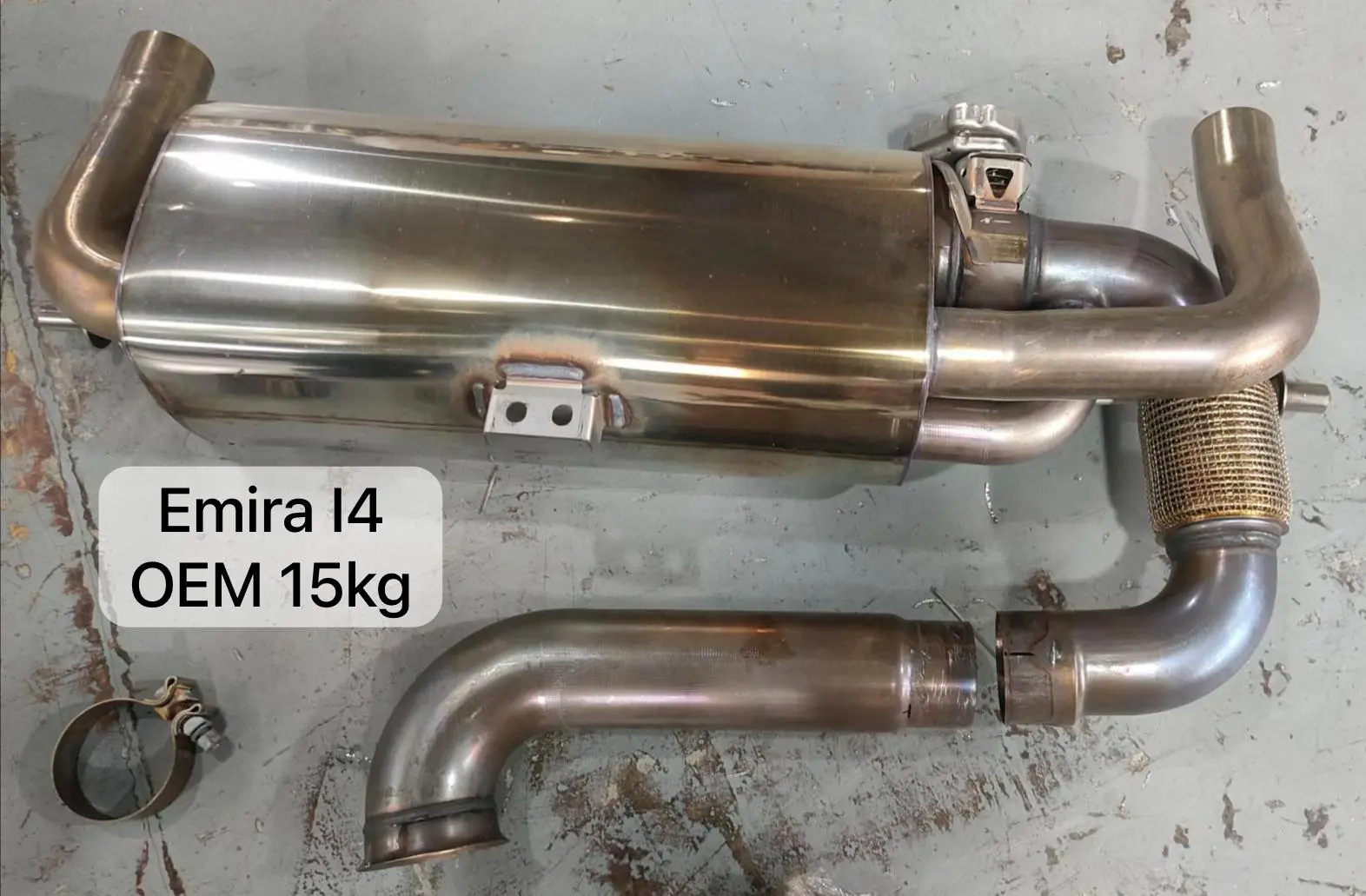

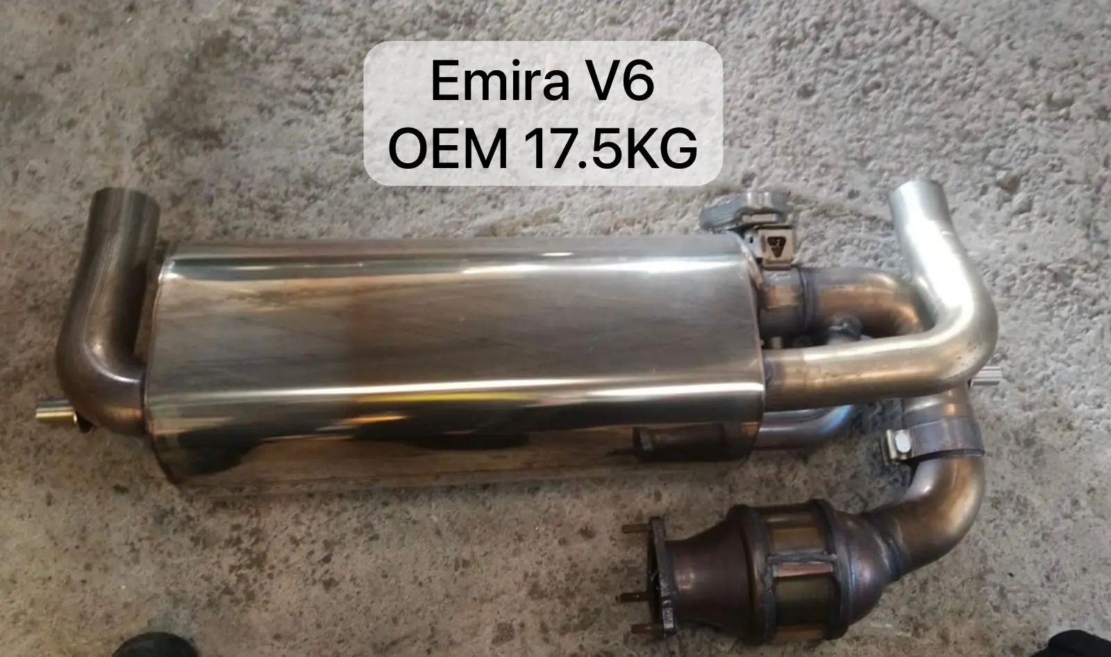

What is the weight of your titanium system versus the weight of the stock factory system? Also, I looked at your website and the wheels for the Emira look interesting, but you don't list the weights. If you're advertising your products to have lighter weight, it's a good idea to list the actual weights.
For our titanium exhaust system come with a de-cat downpipe This outstanding system weighs less than 6.5kg approx a significant reduction compared to the factory specification of 14.5kg. By opting for our titanium exhaust system, you can save an impressive 8kg from the factory setup.

Apologies for any confusion. Allow me to clarify the details regarding our titanium exhaust system.
The manufacturing process of our titanium exhaust system incorporates cutting-edge welding technology with over ten years of experience. We utilize the finest TIG factory machines, ensuring precise and reliable welds through gas shielded processes. As a result, you will notice the welds inside the tubes are exceptionally smooth.
We take great pride in the craftsmanship and quality of our titanium exhaust system. Rest assured that it has undergone rigorous manufacturing procedures to meet the highest standards, providing you with a product that is both durable and aesthetically pleasing.

Weight detail revise:
17.5kg: V6 OEM
15kg: I4 2.0 OEM
6.38kg V6 AERIE titanium exhaust
