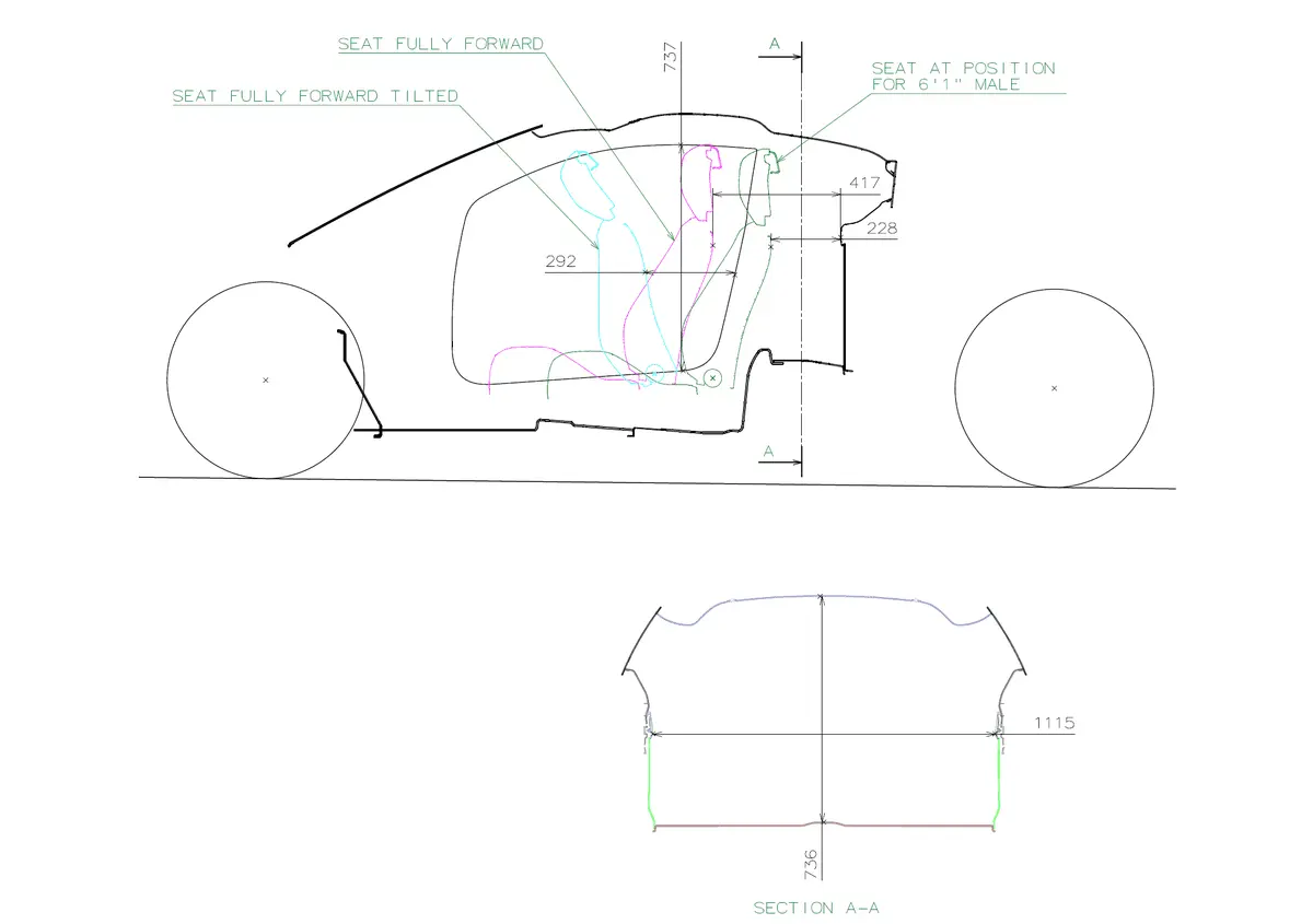

two carry on cases fit easily on the back shelf of the Emira with a little room for a squidgy bag in between (someone posted a photo or two of this on another thread)...and that's before you use the trunk
Here it is:
Ah, but I was referring to check-in sized suitcases. :sneaky:
That's another story,
I am not sure any sports car this size will fit check-in size apart from behind the seats. in the Emira, If you are traveling alone, one full size luggage will fit behind the passenger seat
