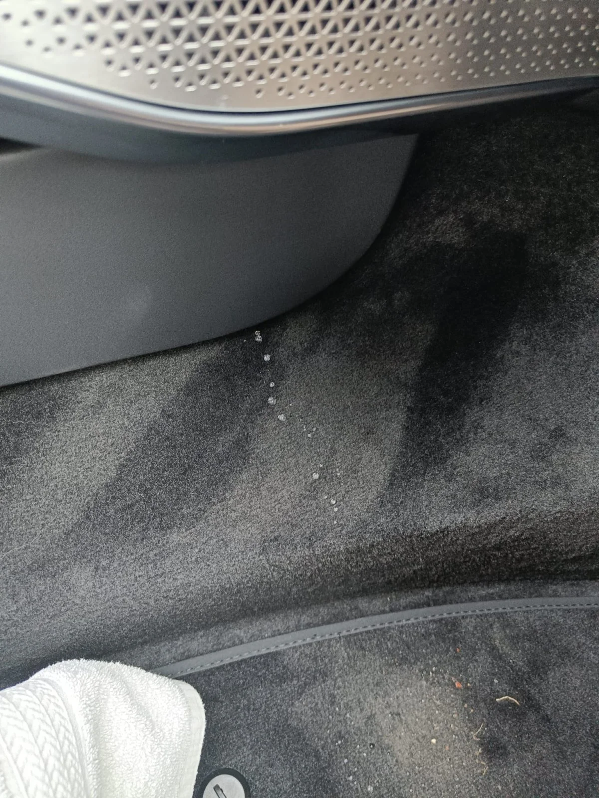

I was driving in heavy rain the other week and had water ingress while driving (see picture). The seals look ok, but taking back to dealer to see what they say.

Looks like it's coming in under the door. Might try some Honda Shin Etsu grease on the door seal, both the door itself and the door frame on the car. This stuff is pretty impressive. Fattens up the seal ever so slightly, as well as making it softer and more flexible. If you put it on both seals (door and frame), that should take care of it. You can get it from a Honda dealer parts department, or order it on Amazon.
A little goes a long way, so put a dab on your finger and work it into the seals in sections.

Cheers for that Eagle7. Most useful.

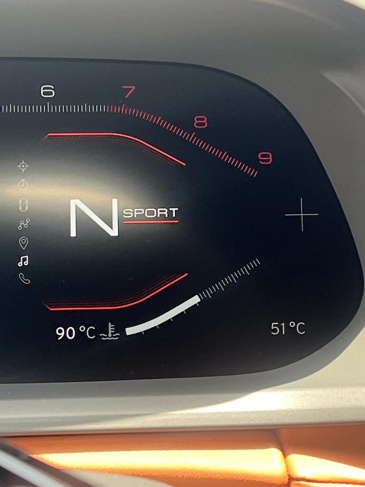

My only issue with the car is the fear of melt chassis during next 3 months
51 °C and still exactly at 90 °C Water :LOL:
I never exceeded 90, regardless of an hour of stop and go in the sun, tricky, slow and curvy track day or pushing on the street. Are we sure the sensor is able to read above 90 °C at this point? hahaha
Glad at least this is working

Habibi this is dubai , all is good
Car is not a baby born 🤣🤣
