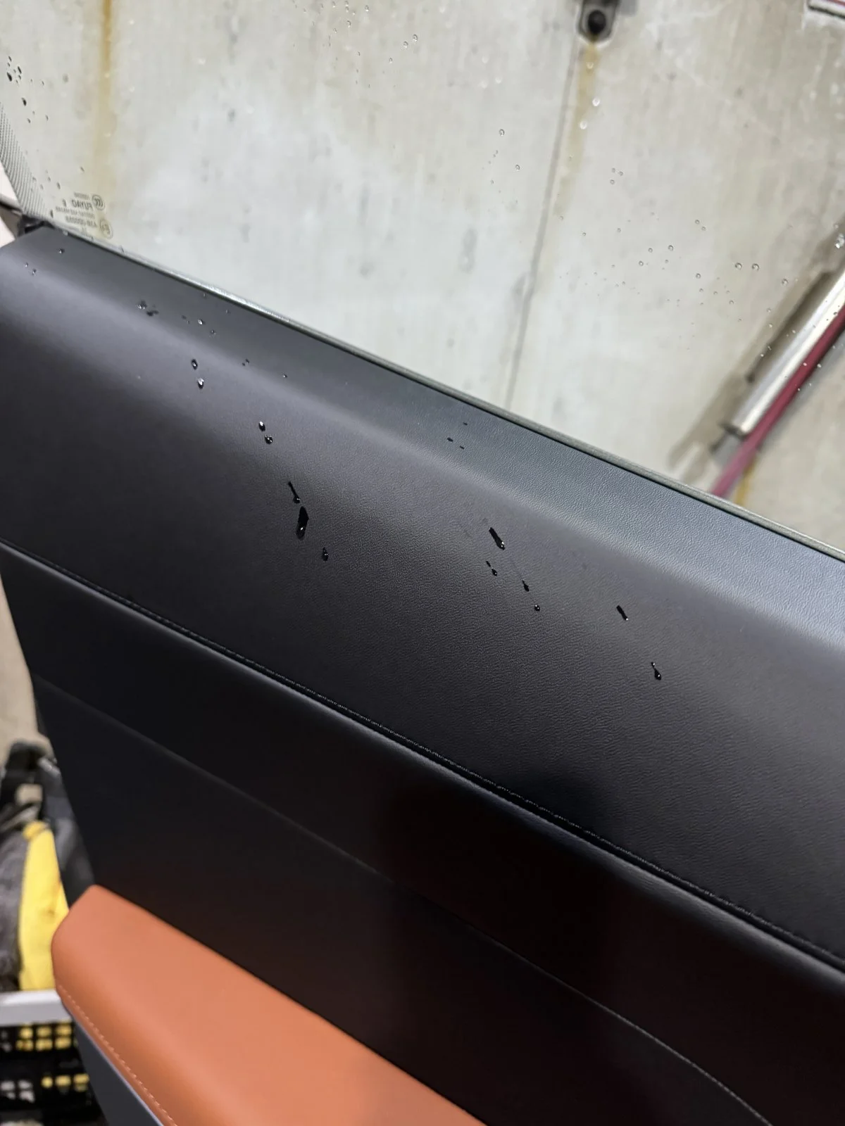

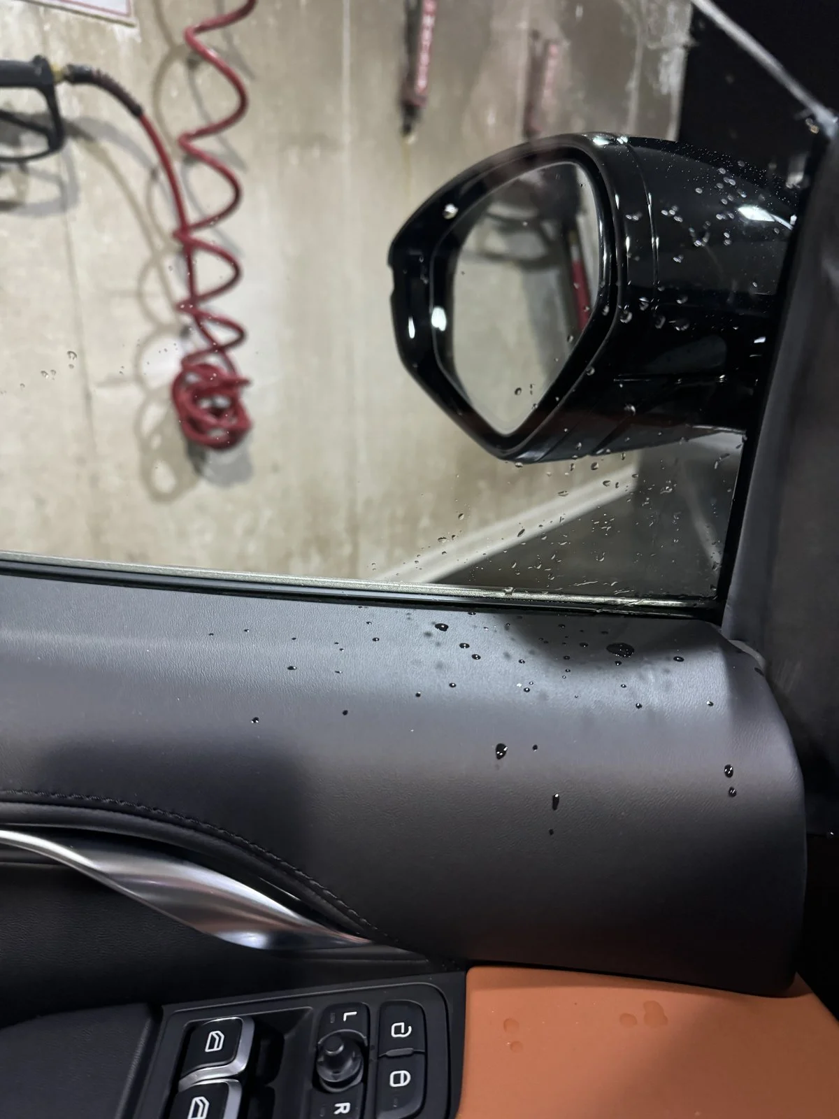

Got another issue to ask about :) when washing my car, I notice that water is getting past the window seals and into the cabin. This seems to only occur from using the pressure washer, but I wouldn't be surprised if it happened a little bit when raining too. Anyone else have this issue? This has never happened to me in any other car.
The photos show the water that made it into the cabin. Most of the water is on inside of the window, but its hard to tell from the photos. Some of it driped from the window onto the door card / arm rest, which is a bit more obvious.

I wouldn't put a pressure washer anywhere near a frameless window (unless on low pressure or with lance well away to reduce pressure).

I am hand washing, just using a pressure washer to blow off surface dirt initially and then spray rinse after soap wash. Using a pressure washer to wash a car seems pretty standard? I've had a few frameless window cars before and never had this issue. Even teslas don't have this issue ¯\_(ツ)_/¯

Do wash as you please, it’s not like they reinvented a car. It absolutely should handle a pressure washer. The amount of water related issues on the Emira is insane.
As far as your seal problem goes, others had this issue too. Something about the seal not being fitted correctly. Consult your dealer, they can hear back from Lotus and cover this under warranty

Yup you just have to be super careful around the window frames. I tend to take a few steps back when doing the windows as I know water tends to seep in a little. After every wash I just get a dry towel and dry the few droplets that snuck through no big deal.
Try some Honda Shin Etsu grease (thanks to @kitkat for that tip!). I put it on both the doors and door opening seals. That stuff is like magic on rubber seals. A little goes a long way; use a dab on your finger tip and work it into the rubber in sections. You'll notice right away how it moisturizes and plumps up the seal. It should help with the sealing as well as eliminate any squeaks.
