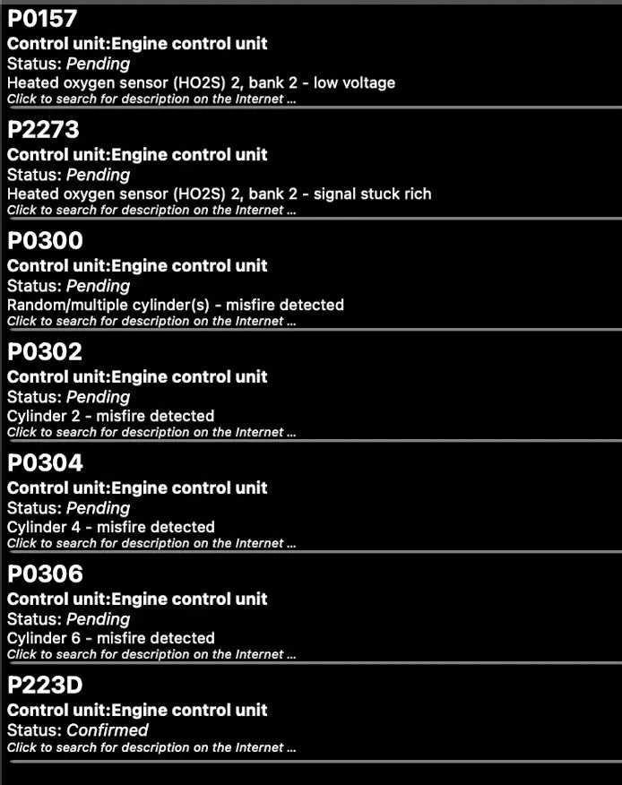

Got my ODB scanner.
"Veepeak Bluetooth 4.0 or above (BLE) OBD II Diagnostic Tool for iOS and Android".
Good news is it seems to be mostly working, bad news is I found this:
Decided to get a scanner myself after a CEL and limp mode. Dealer read it out and only found a single unrelated error (He actually showed me) and scheduled me for a software update. Back home CEL hit me again and this is the readout. Looks like the O2 sensor is borked. Looking at it again it seems more like the voltage dropped across the whole bank once, thus the misfires? I'm not a mechanic, just educated guessing here
Send it out to my dealer again..
Also seeing all the available sensor data makes me sad Lotus didn't provide a little more detailed values on the screen in an app or something..

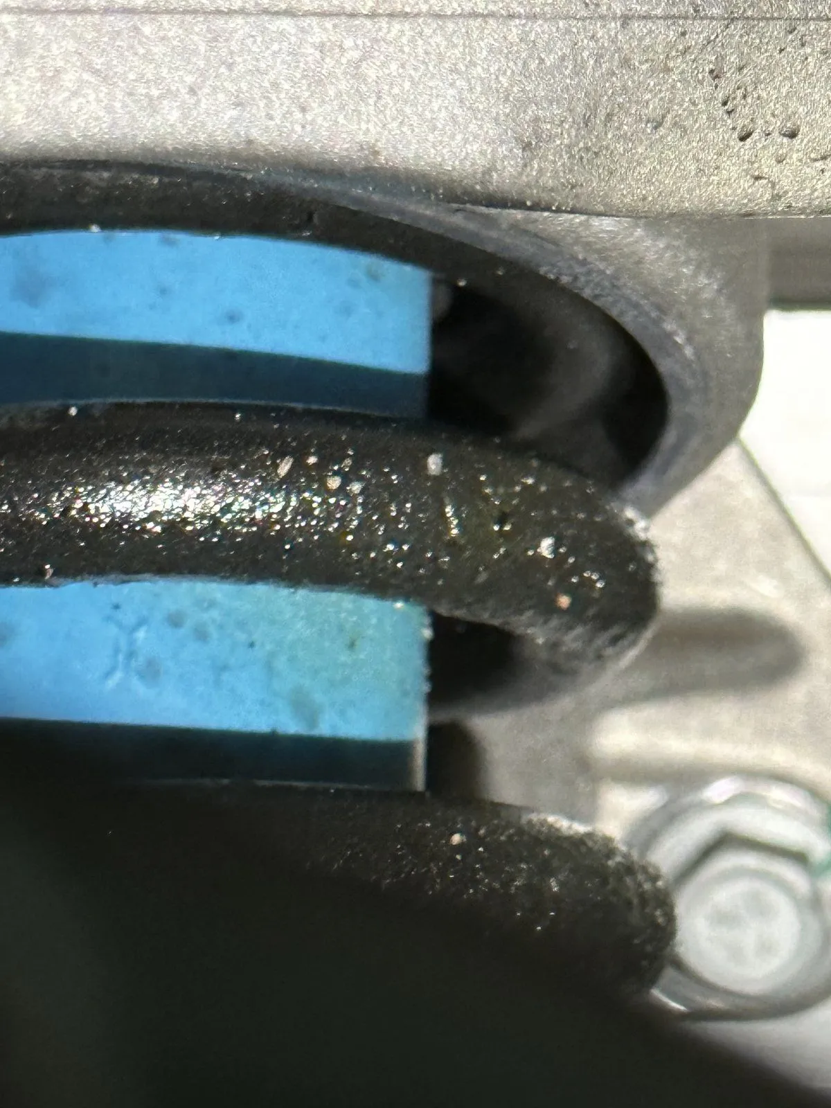

I checked and found an oil leak on the suspension (Not really sure if normal or not)
I will check with the dealer tomorrow
