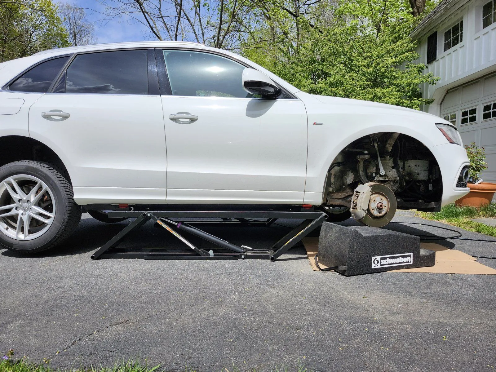

I just got quick jacks a few weeks ago. They are difficult to synchronize, meaning to start lifting at the same time so that my car is level. Sometimes it is off by ~6 inches. When that happens I lower them and start over. With a couple tries the car will be level.
Am I doing something wrong? Is this the way they all work?

If they are lifting the same amount of weight they should be even by default. That's using them longitudinally, along the frame rails of a standard car.
If you are using them across the car (transverse) the hydraulic balance is difficult until they get up to full pressure, because the weight is quite different F/R.

They often will be out of sync a bit as they rise with no load. So you end up making contact on one side first. The side with no contact yet will then rise more quickly to meet the load, and then they lift together. If it's noticeably unlevel as it's lifting the vehicle, then I would be concerned.

Thanks for your replies. I'll get a couple photos the next time I use them to show what they are doing. The load is longitudinal - along the "frame rails" - lifting my 911.

Is it always the same side that doesn't lift as quickly as the other side? If so, (or you could do this with both sides) check to see if there's air in the hydraulic cylinder. Try a quick bleed test like you do when setting it up the first time, in case there might still be some air that didn't get bled out.

You need to keep bleeding all the air out

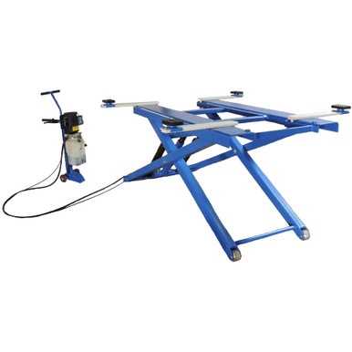

Thinking of this as an alternative as it has adjustable lift arms and a much higher lift height. Anyone have experience with this type of lift?:
At a thousand pounds that's not going to be something you move around much. Are you looking for something just for the Emira?
It would not be exclusive to the Emira. Good point on portability - have no idea as to how well the trolly works in moving it around.

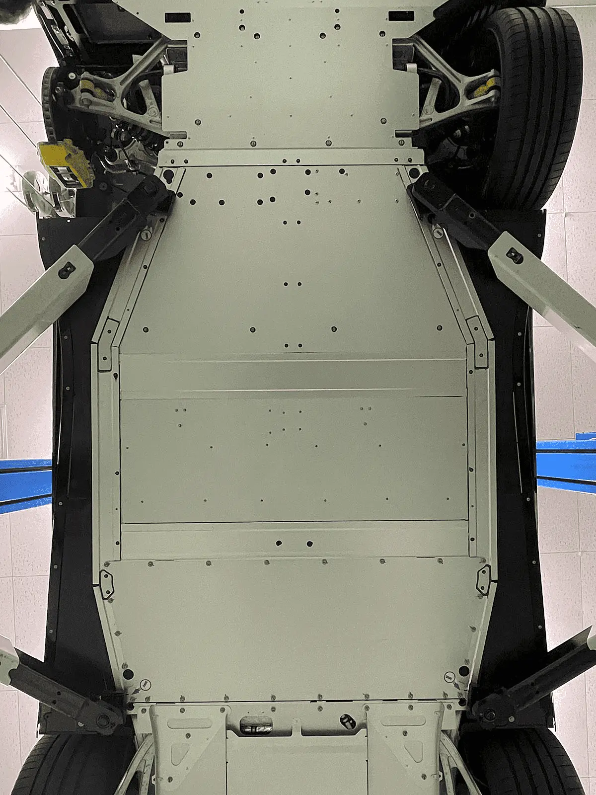

After studying it, I think the main reason they set the front lift points so far forward was for stability so there wouldn't be any fore/aft wobble, not because the side rails aren't strong enough. I've put together a set of pictures that show the frame.

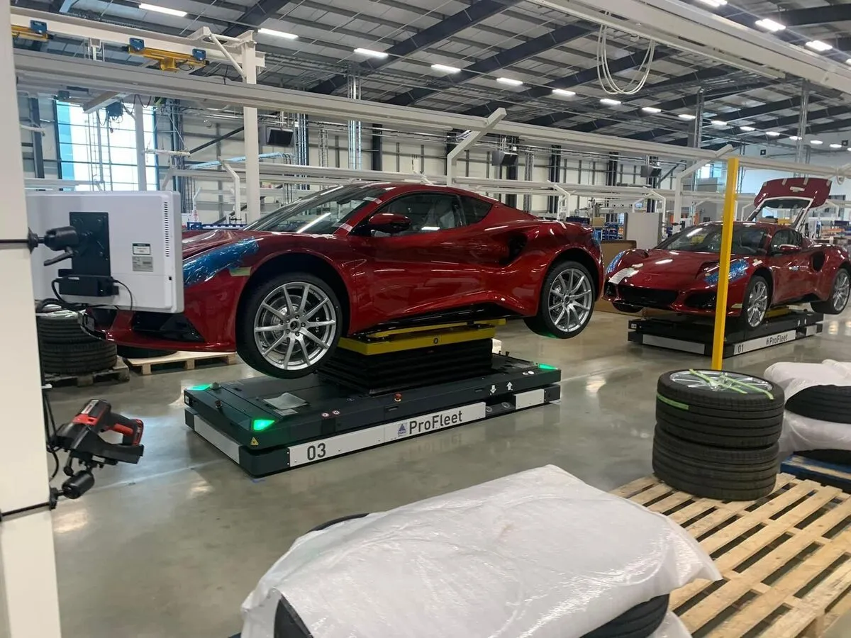

Here you can see one of their motorized sleds appear to be lifting the car near the forward end of the door instead of deep into the edge of the wheel well which is where the manual shows the forward lift point.

Here's that same lifting point from the inside of the chassis (which is now pointing to the right compared to above which is pointing to the left). You can see there are two crossbraces, with one directly at the point where the chassis frame starts to angle inwards.

That point can be seen here which is back further than where the lifting arms are positioned.
I think the forward point is strictly to shift the balance point of the lift more towards the center of the car to avoid the possibility of wobble on a 2 or 4 arm lift. A Quickjack is a full length long rail so there wouldn't be any possibility of a fore/aft wobble. If you position the Quickjack front lift point right where the chassis starts to angle in, like they appear to do at the factory with their sleds, it should work just fine. It's what I'm going to do.
Good images. Also I think they put the forward lift point as far forward and the rear so far aft to allow for stability if the engine is removed on the lift. The CG will shift forward and dont want that moment arm to be so short coupled if the fwd lift point is where that fwd bend is. If just raising the car without major assemblies removed the other alternative fwd lift point should be fine.
