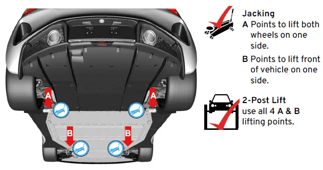

The service manual instructs you to use the jack-up point on the rear side.
This will allow you to lift the front and rear tires on one side.

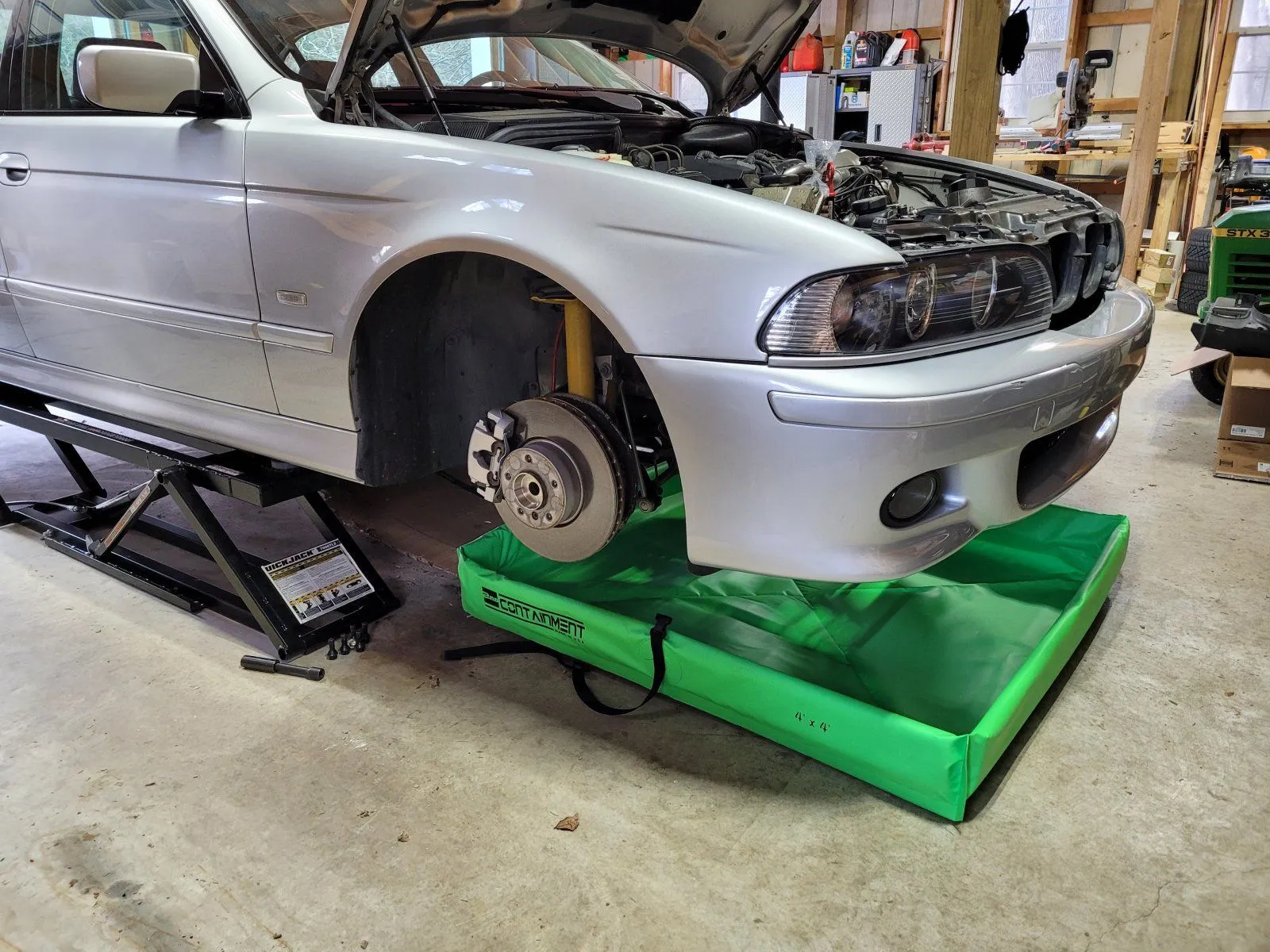

I currently have an E39 540i that has been on my quickjacks for at least 3 months (while I slow-roll a cooling system upgrade). 100% confident in the design, and when I'm really wrenching on something underneath I'll will also put some shoring (wood or other jacks) just below subframes for that extra feel-good factor.

This highlights the source of my question... I totally get that Lotus has specified the point loading locations where the car should be lifted using a point-support jacking system like a 2 post lift.
BUT... is it an exclusive/explicit requirement? Is it ok to lift the car "flat" as long as those specified locations are fully supported?

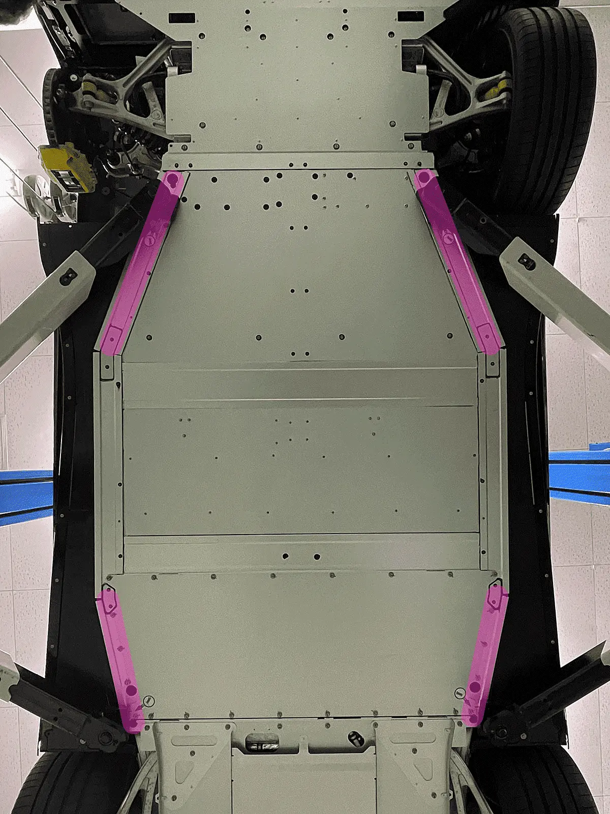

See here: Seems like a platform jack like a QuickJack or one of the full size BendPak split platform scissor lifts would be able to engage the entire bottom of the car along the frame rails, if someone wanted. Talking about lifting by the full length of the angled sections of the center chassis, like so:
Using something like this:
They come with lifting blocks as well (see below), though it would be a touch more challenging with the odd inboard spacing on the Emira because I think it's right at the limit of where a platform would extend to if installed "standard". That's why I'm asking about a full-frame-support approach.
We recently had a discussion with Greg (GRP) on the Lotus Discord about how he uses his Quickjacks on the Evora and he uses them along the frame rails safely and not just on the designated lift points. If this is fine, this opens up plenty of options for using the shorter Quickjacks along the sides of the parallel framerails.
