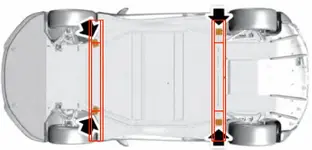

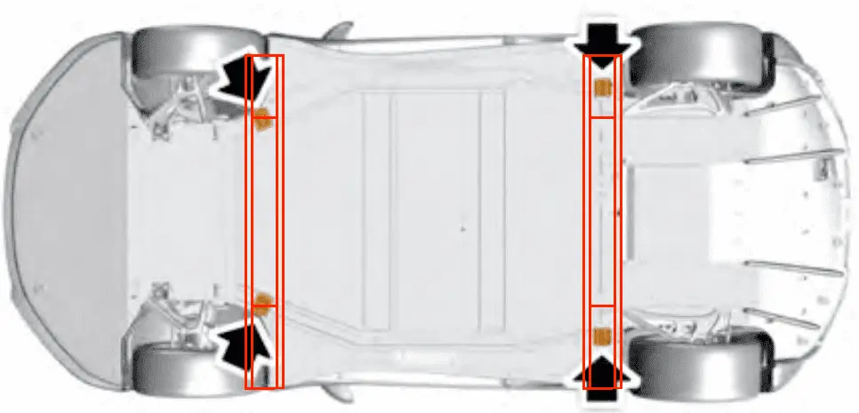

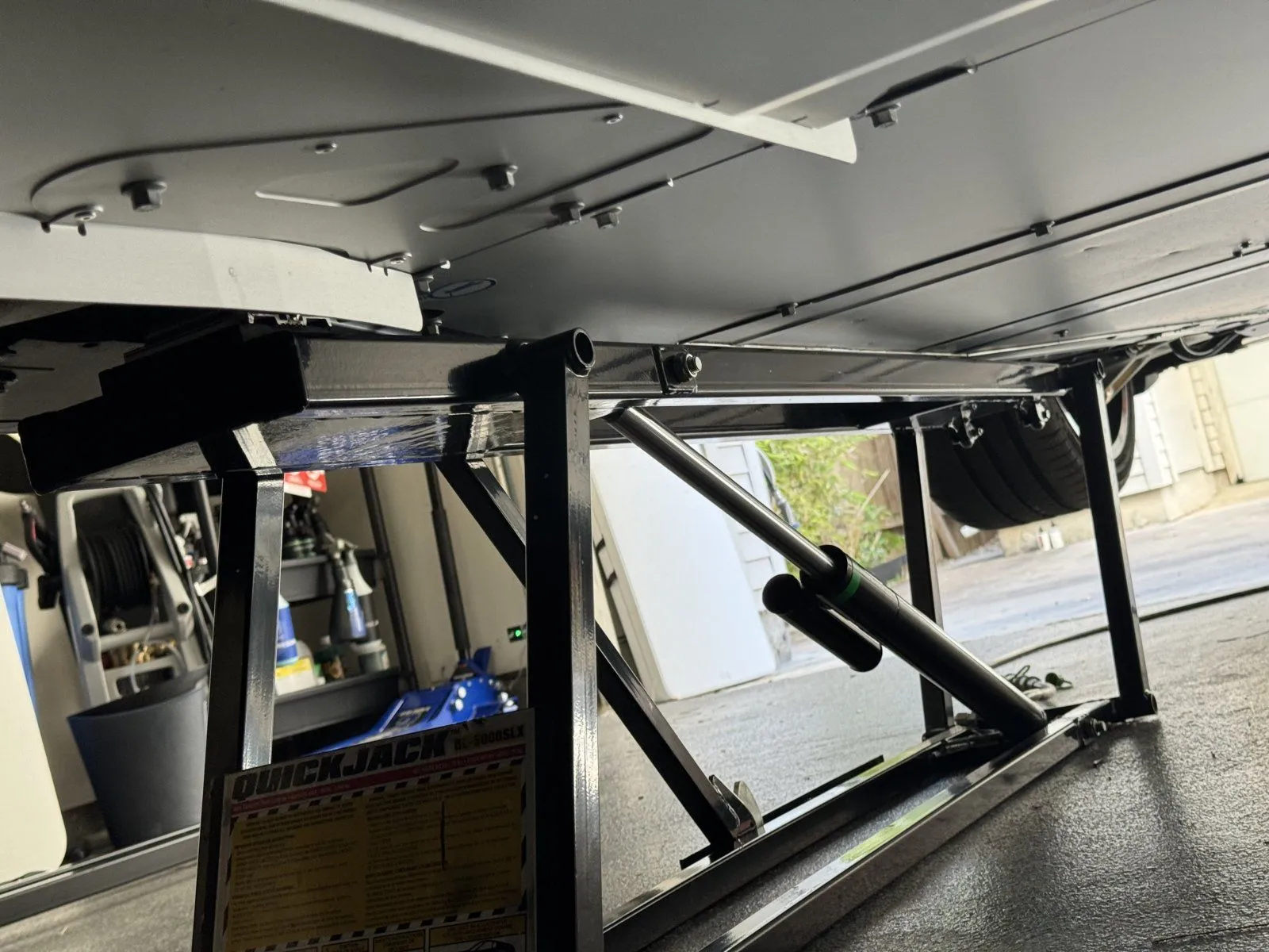

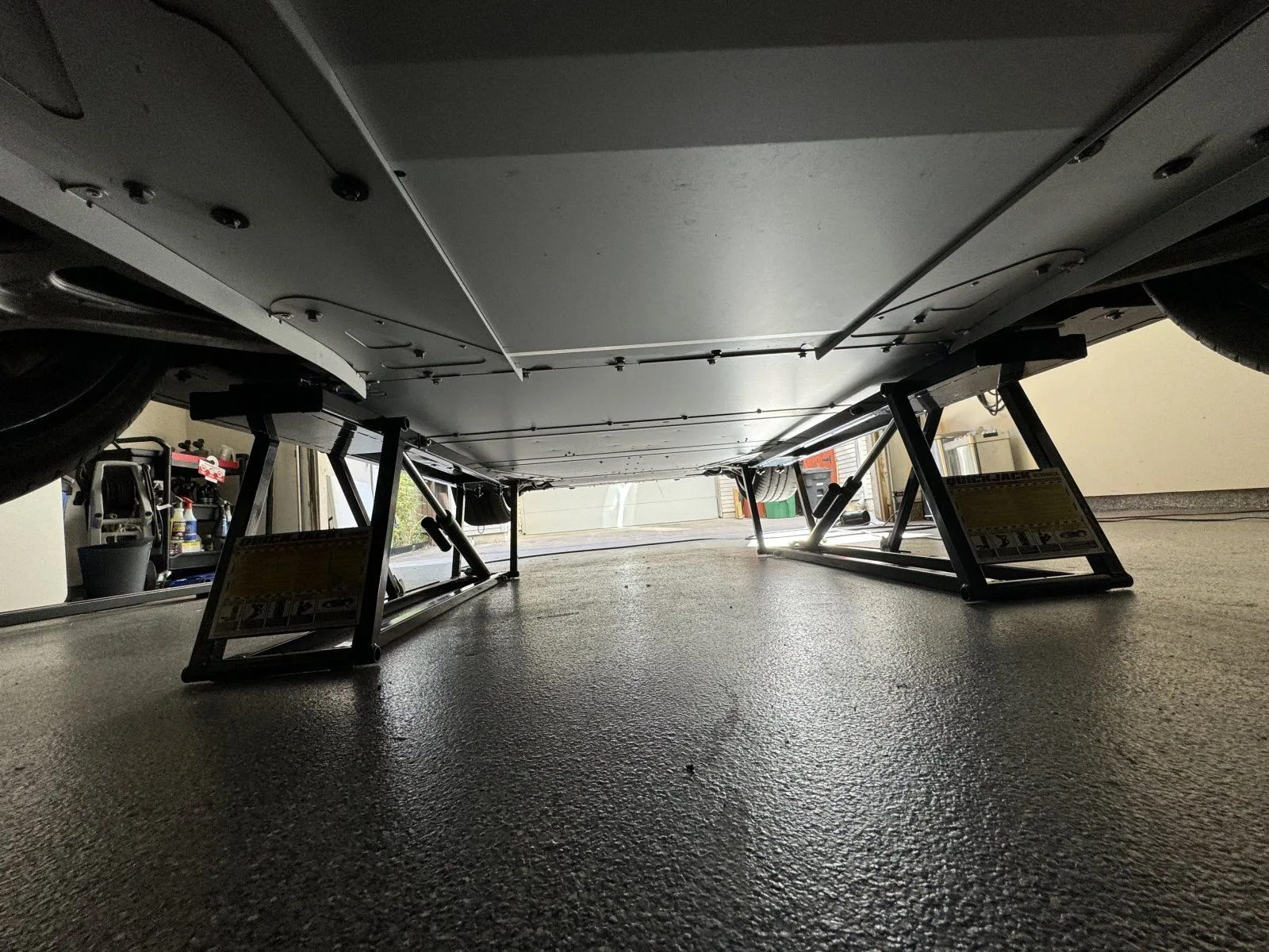

You can turn the frames perpendicular to the car and lift it that way. I've done it before with my 5000TL. Just be aware that the car will move laterally a few inches as it rises instead of fore/aft. Also the Emira has ~700lbs more weight on the rear axle than the front, which isn't necessarily dangerous given the total weight is still well below what the frames can handle, but still something to be mindful of.

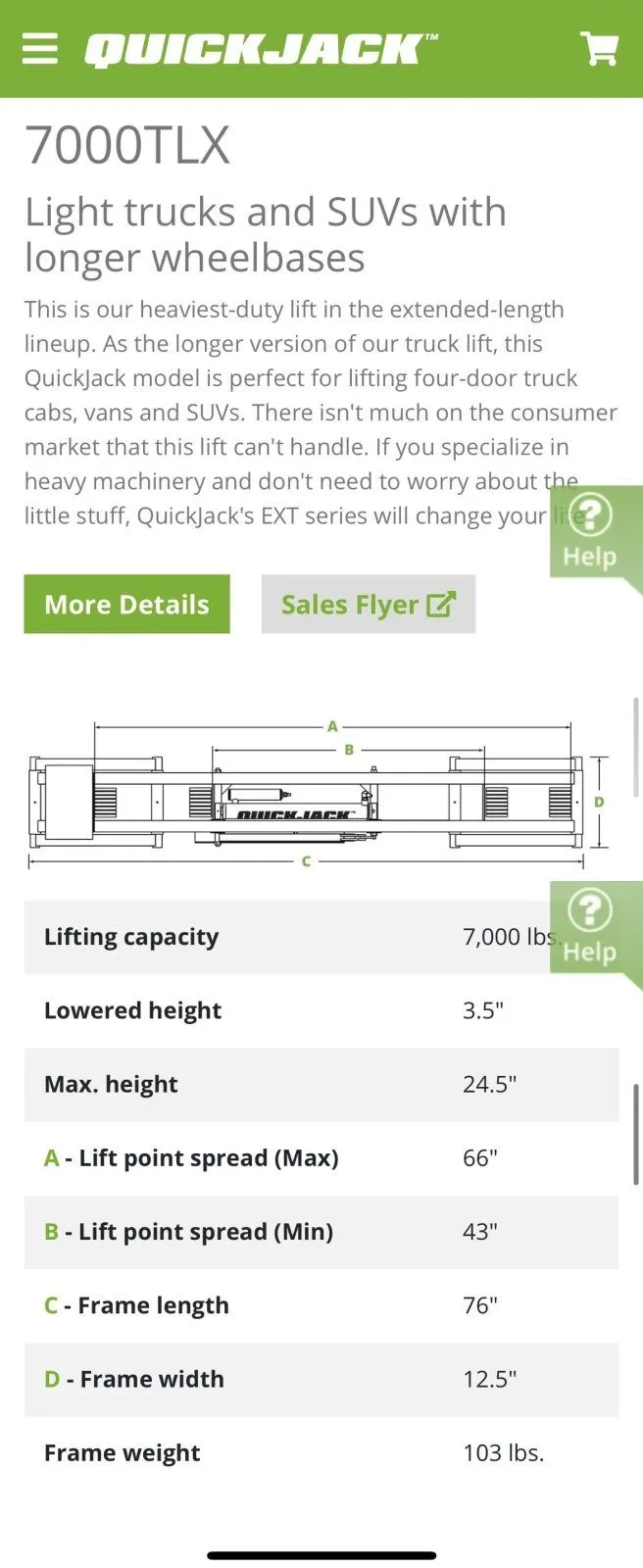

Just to make sure we get quality info, I believe they have made a 7000, 7000SLX, 7000TL and 7000TLX, so if anyone verifies anything please be as specific as possible.

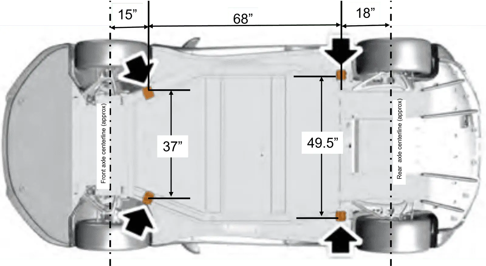

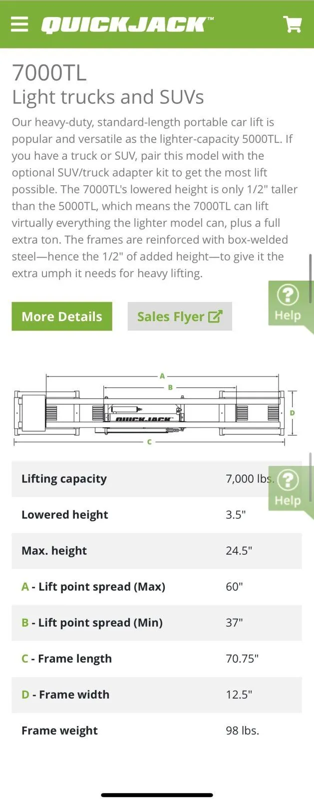

They have specs on their website. Those along with Aero’s measurements should be able to tell you whether the 7000 series will work for your intended use or not.
So it looks like angling them in should work for the TL. Thanks.

Yeah, if the contact points don't move you put a lot of side/twisting load into the quickjack. The QJ manual specifically says to make sure that the two lifts are parallel to each other.

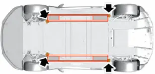

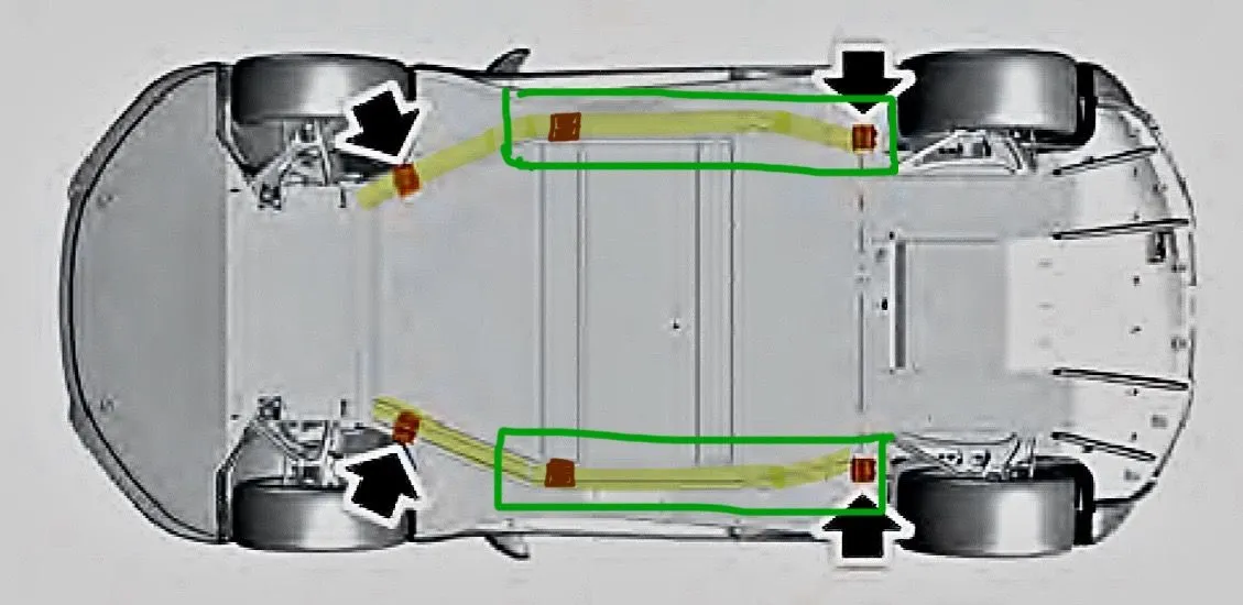

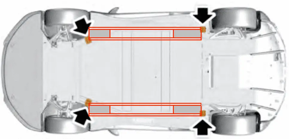

The pockets you put the lift block into are only 5" wide, so you could make up at most 10" going from inside front to outside rear, but even then the 66" extreme edge of the lift blocks for the TLX QJ looks to be 2" short of the center of the marked lift points if you try to use it longitudinally.
The longer TLX is a little too long for the front if you want to use it transverse. See below -- these are just pixel scaled in an image editor, so they could be a little off.

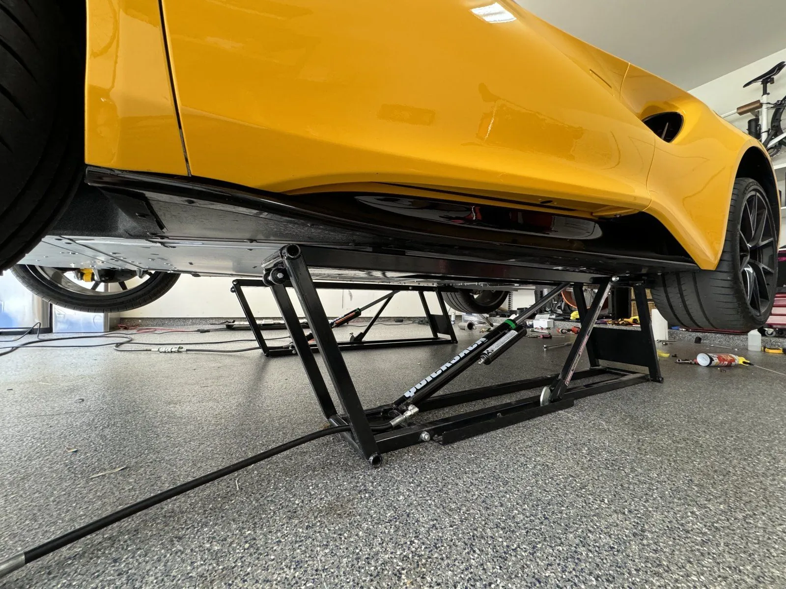

I believe @GRP has said on the Evora you could use QJ along the frame rails and it was fine, and he believes the same is true for the Emira.

I was thinking that pictured sideways it's lifting via the frame rails, not the forward jack points.

The 5000 and the 7000 are effectively the same dimensions, and support identical jacking point distances. It’s the TLX vs. the TL that changes the jacking point distance.
