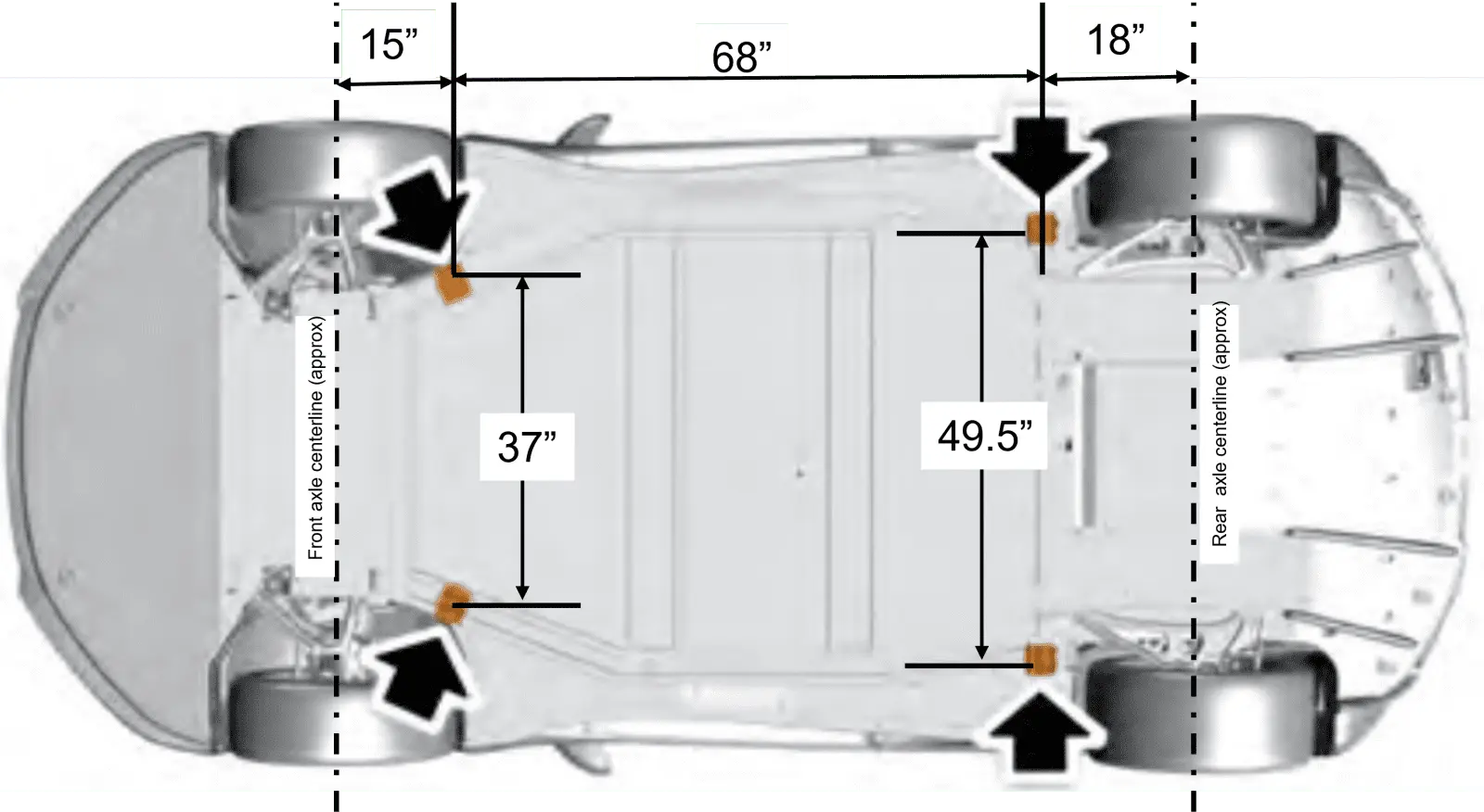

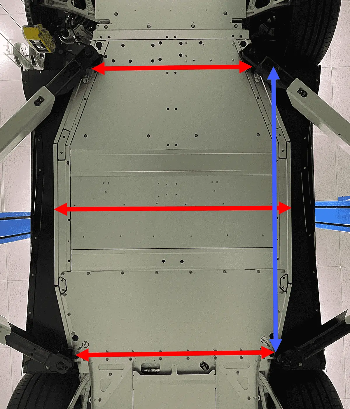

Maybe someone already did this. Good news my MaxJax barely fits with the posts on the most inward spacing points I put. Got the car up in the air and took these measurements. Might help someone. Should be pretty close. These are to the approximate center of the pads. The pads look about 4x4 (guess)?
Yesssss! Finally! Thank you SO MUCH!!!
I just measured the 5000TL with the extensions and it measured out to be 66".
And according to the measurements Aero did the distance between the lift point centers is 68"? I have the 5000TLX. Is it going to be 2" short? I wonder how wide the lift points are? I know I'm going to have to get the crossbar for the rear lift points. Guess I'll just have to wait and see what I can do once I get my car. Maybe contact Quickjack and explain the situation. They might have a solution already, or can create one for that extra 2" so the car can be lifted safely.
